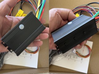

Thanks, I'll look into it as I dive deeper. Taking baby steps. The unit just arrived; it's smaller than I thought. Same size as a pack of Marlboro 100s, but 1 1/2 times thicker, but crazy small. :shock:
Some of the programming tool looks intuitive, but other parts look sort of intimidating. I'll probably wire up the CA connector tonight, and hopefully get the basics programed tomorrow; not sure if I'll be able to test ride by then. :eek:
Also, it looks like it can do current roll back for both the FETs and motor, so I'll have to decide whether to use the CA or the controller for the motor temps. Also, try to figure out if the same temp sensor signal can be shared with the controller and CA or not.

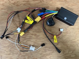

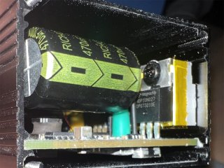

I opened up the end of the controller without the wires and it looks like the single PCB version.
I soldered on the XT90 battery connector, XT150 phase wire connectors, and the CA connector, so it's ready to hook up. I'm using the same external shunt that I added for the spare controller, so just added a JST for that to the CA harness (I used a JST to the shunt, so it's easy to swap controllers). I decided to do the same with the Battery (+) and (-) by making a jumper with a two pin JST branching off of it, going to the CA harnes, again, making swapping easier. I get the speed signal from the yellow hall sensor wire. The CA throttle output taps into the COM harness throttle signal wire, the only wire I'm using from that harness, but when I implement regen, I'll tap at couple more of the wires. So all connections for the CA harness are external to the controller like on the spare.
I rolled up the unused harnesses, wrapped them in plastic and some electrical tape, but since I ordered the bluetooth module, kept that harness loose. I think it's pretty much ready to plug in, but I'll check all of the wiring again in the morning. :x
Also, I think I'll end up adding a pre-charge button above my breaker/switch since this thing doesn't have an on/off switch.
