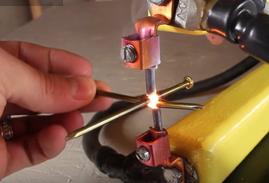

I'm suggesting that you make a spot welder for the two end collectors. You mention welding thick copper collectors to the positive and negative ends, connected to the copper bus-plate that is connected to the cells.
The kWeld is perfect for connecting copper strips to the ends of the cell, via the nickel sandwich. However, it is not even close enough to being able to bond the copper bus to a thick copper collector.
Building a brute-force Microwave Oven Transformer / MOT-welder may sound daunting, but it is dirt simple...
You find an old microwave oven, pull out the transformer, cut off the high-voltage coil (many wraps of very thin wire), then loop $20 worth of thick welding cable through it. Use 2, 4, or 6 turns...test and record. Each turn is one volt.
1500W = 2V at 750A
1500W = 4V at 375A
1500W = 6V at 180A
https://www.electricbike.com/resistance-soldering-unit/

So tonight I'm wrestling with whether to go with an AC spotwelder (AKA MOT) to do the copper=copper welds, or whether I should build a monster switchbank as ridethelightning did. My day job is in power electronics, so I am aware of all the potential pitfalls of building a 10,000 amp switch. Although I don't happen to have a defunct Microwave oven handy, I do have an old 20 amp Variac autotransformer which is mechanically on it's last legs. It's basically a nice big toroid just begging to have some welding cable wrapped around it... I need to do some research, I forget the advantages of AC vs DC spot welding.
save your self the bother, iv been there.
its not so simple to get a transformer style welder to work well. issues with intermittent double pulse due to ac waveform and solid state relays, the type of core and air gaps etc make it unpredictable due to reluctance etc and bottom line just not enough power.
im super thrilled with the 72 mosfet array i bought plus timer board, all together around 100usd i think and still for sale. if i diddn't have a huge pile of half baked 25r cells, i would have bought some high discharge lipo packs to power it.
all i did to upgrade the thing was bolt some different copper pads to it to get a better connection and add some huge cables i got for /kg price at the scrap yard. the tips can be made from some 8mm or 10mm round bar and filed to point.
(oh and the protection diodes)
foot pedal is equally "sophisticated" - microswitch from microwave oven door glued to a chuck of wood, a hinge and a bit of spring steel flat strap
