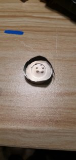

Hi,
I'm looking for some feedback on some tests welds. This was 0.1mm copper with no slit with a small square of 0.15mm nickel plated steel strip on top. I used an empty test cell so I could cut it open see the welds from the other side. The welder is an arduino spot welder powered from a 12v 930CCA lead acid battery. I found that with 30ms weld time there was good adhesion but insufficient to tear the copper over each weld when separated. With 35ms all six welds tore both copper and steel strip when ripped off with pliers (couldn't remove by hand).
The welds look really good to me and are extremely strong, could do with some experienced feedback though particularly on the shot from the inside of the cell before I tackle the 130 samsung 40T I have on the bench.

spinningmagnets said:
That's a great result, and thanks for posting the pics here. Can I use these pics as an example? (of course, I would credit you)
Yes of course.
But how do the welds look (I haven't got anything to compare it to) are they too hot or OK? Also what pulse duration do people usually use on the arduino welder? I've now reduced it to 32ms which still gives an excellent weld.
This is why these pics are important, few have posted the inside of the can.
Use the lowest setting that forms a solid connection, and then...whatever the inside looks like is the standard to measure by.
Also, if the setting you are getting good results with makes the welder very hot, you might get the same result with a lower setting by adding a one-inch split to the nickel/steel, and an "infinite" split to the copper (use two thin strips, instead of one wider strip).
Was there a plastic washer between the bottom of the can and the battery roll of active material?
Looks like too much current/heat from the pic of the cell’s inside. Basing that view on what “good enough” welds look like on the outside after ripping the strip off.

They were empty cells, literally just the shells, using them to get the welding settings correct. Do you know of any pictures anyone has taken of the inside of any cells after welding that I can compare to?
I will do some more tests this time with just steel-copper-steel strip sandwich and see what the weld base looks like.

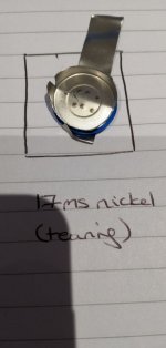

Some more tests still using the empty cells.
1. 0.15mm pure nickel 10ms - ok weld but not enough to tear the strip on all spots
2. 0.15mm pure nickel 17ms - excellent weld
3. 0.15mm steel -> 0.1mm copper 35ms - excellent weld
Test 1 is not really any good as the weld wasn't strong enough, however tests 2-3 show similar 'damage' to the rear of the cell so assuming (massive assumption) the nickel weld is ok for cell health then presumably so is the copper weld. The only difference visually between the two is you can see copper penetration on the rear of the cell if you look closely at the weld centres.
These dummy cells are empty meaning there is air behind the negative terminal, this makes a huge difference to the amount of power required to weld the cell. I did some more tests with bits of cell wall from the cut up cells onto an srbp plate, this is quite good as you can see the damage caused to whatever is behind the negative terminal, it can be quite significant.
I then took an old real cell, a 30Q and put a steel-copper sandwich on it with 26ms for a full tearing weld.A good weld can be achieved at 22ms. So the next step is to sacrifice a 40T to tune the final weld setup, I reckon it will be very similar to the 30Q.
Finally the cheap nickel plated steal works 100x better the pure nickel for the copper sandwich weld as others have already stated.
