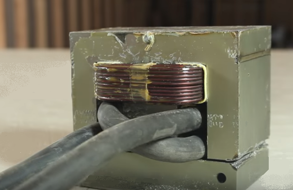

It might be possible to weld 0.20mm and thicker copper with a rewired transformer-based RSU, and a 120V soid-state timer with foot-switch... I don't know. You would definitely need to use the infinite split (two completely separate strips that dont touch, instead of a single ribbon)
https://www.electricbike.com/resistance-soldering-unit/
