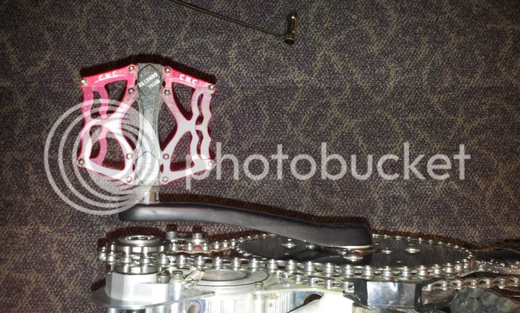

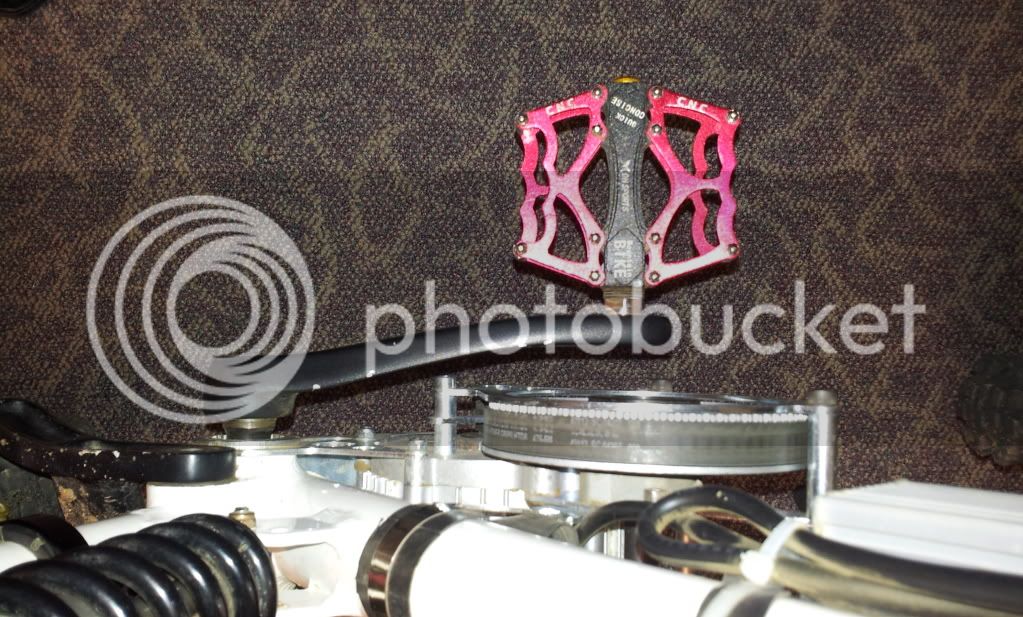

Clearance of the cranks around the motor shouldn't be an issue. You could email Paco from Cyclone, order just the cranks and BB like I did, pop out the support bearing from the GNG chainring and slap that all together. You may run into slight misalignment with the chainline, but there are various ways to adjust the chainline from the 12T jackshaft to the 44T chainring.
Tinto and t0me purchased the entire BB, freewheeling cranks, and chainring set up from Cyclone, and it seems to have lined up fine for them. There's also the additional front chain ring up front which some may find beneficial especially if you want to segregate a torque oriented climbing mode from a high speed mode. If I wasn't running a single chainring already prior to the GNG, I would have done the same as these fellows.
Edit (Added Photos):
Non-drive side clearance (Belt Side) The shadow from the flash makes it seem like it's touching, but it does clear the bolt on the motor by almost a centimeter.
Drive side clearance
