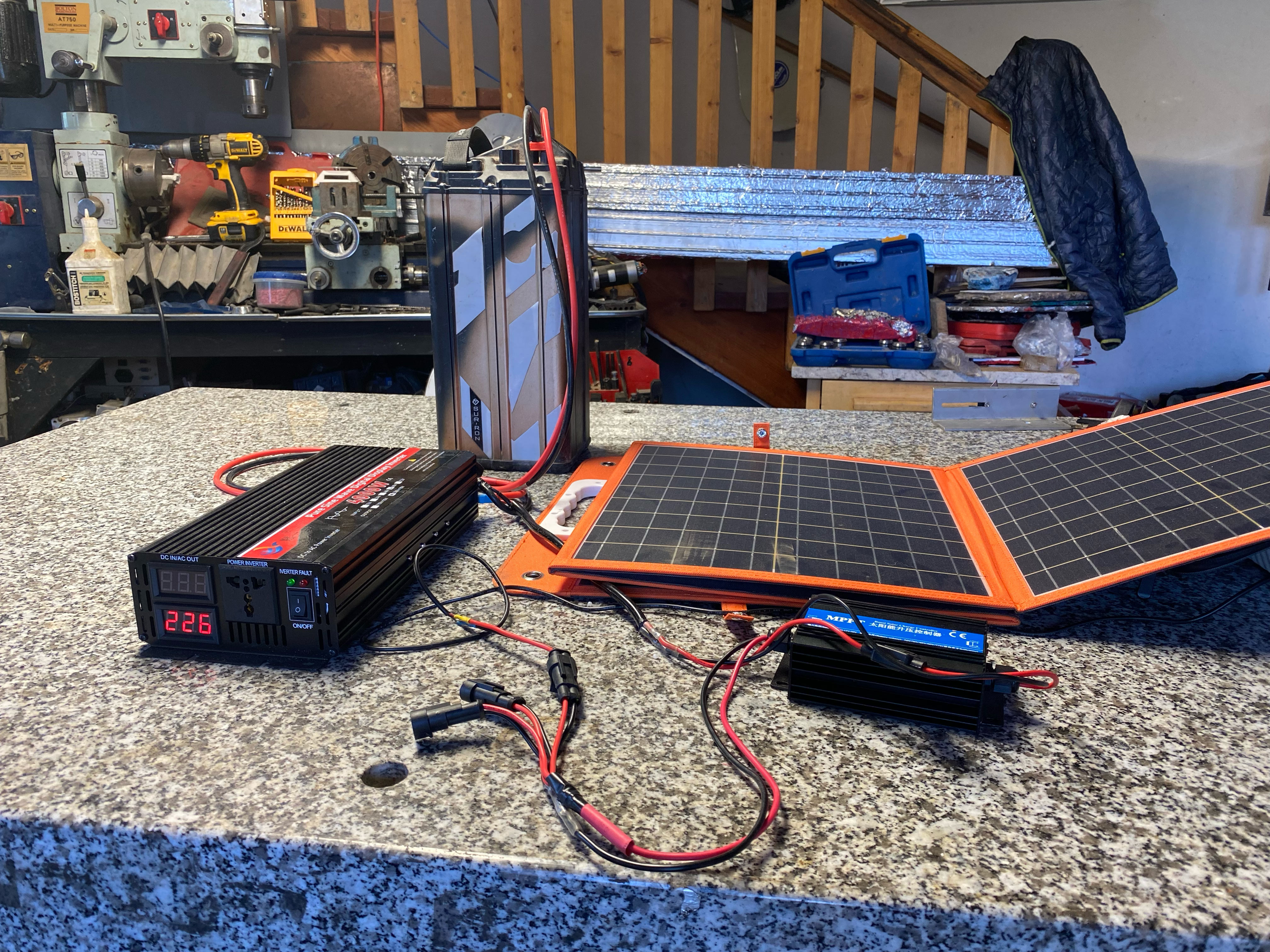

Here's my complete system, everything works!
I charged the battery with the solar for the first time yesterday. 8)
I just have one 100 watt panel for now - going to get another. It weighs 5 pounds and 16x16 inches. The harness is wired for three panels (and the MPPT I got supports 300 watts).
My inverter is putting out 220V that can be split to two 110V outlets (going to use GFCIs).
Un-limted range (given some time to soak up some photons) and actual broadband just about anywhere now! :bolt:
Oh - the only thing is, when I connect the inverter to the battery I get a big spark - even when the inverter is off. Anyone know what connection or signal needs to go to the battery to disable DC power out?
Handy 3-n-1 machine and very nice optical(?) table.
The spark is the inverter's bulk filter capacitors charging up. You need to precharge them or use something like an anti-spark connector (AS90) to do so.
Fuse your battery connection as close to the battery as practical. That MPPT has to be a POS for the price but as long as it works, it works. If something goes wrong you want the fuse to blow and not start a fire. If the failure draws current that is lower than the BMS trip limit it can set the wires on fire. 300W MPPT / 60V = 5A max. So w/ the 1.25x UL fuse derate, look for a 6.5-10A fuse and size wire accordingly. Do similar calcs for the inverter (though it needs ~2x sizing due to the high RMS current on the DC side)
Is your 220V inverter center ground referenced/balanced? Not many cheap ones are. Be careful trying to run to separate 120V circuits from it. It likely wont like unbalanced phases either.
2kWh/100W = 20H of charging for a full charge. (~4days w/ good sun) Wife/kiddo/I can't wait that long;) Its clever doing what you are doing w/o intermediate storage and having it portable though. Kudos!
The inverter has a large capacitor on the input that wants to charge instantly on connection. Best to precharge it through a resistor first. I use a 4.7k 1W to do that for a few seconds before connecting.

Actually, the MPPT seems quite nice - has a decent size inductor - allows 0.1V increments - shows the voltage of the battery and other stats.
Thanks for the tips. I have a fuse for the MPPT and the inverter has one built-in. Not sure why I would need anything else other than something to precharge or preferably just turn the power off coming out of the battery?
I used 8-gauge wire for connecting the battery to the inverter. Based on my research it should be fine.
Yes, as I said I'm definitely going to add more panels but you got to start somewhere. 2-3 panels should get most of charge in a day, I never really run my battery below 20-30%.

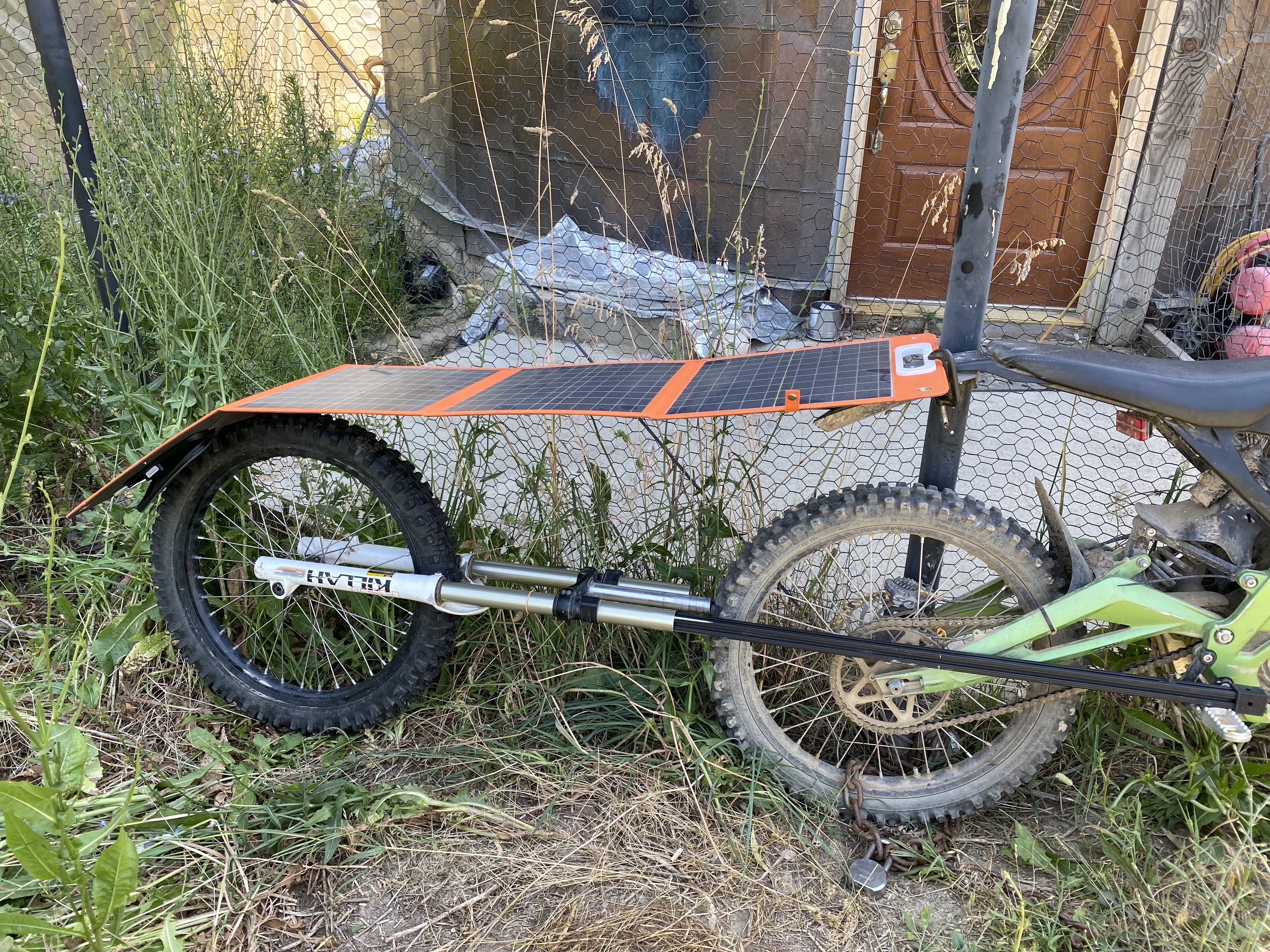

Building a cart primarily out of the stock fork! Pic is rough layout - have plans to add a shock.
I suppose it will partially power my ride direct from the sun - any excess electrons will get dumped to the pack.
It will also have some saddle bags on the cart for excursions.
You'd best put all those panels on the same horizontal plane. The way they're arranged now, at least one of them will be poorly illuminated at any given time. If they're in series, that will bring the performance of the entire array down to that of the most shaded panel.
I'll see how it works - can always tweak it. Not a bad suggestion - thank you.
My thinking with different angles was that it is kind of an average - versus with a plane they all could be at the wrong angle.
If they're in series, the worst one will bottleneck all the others. There's no averaging.
If they're in parallel, then it's more or less as you say, as long as they're diode isolated from each other.
I ran across this issue when building a solar charging e-bike in the late '90s. There was a cell array on the side of the frame, and another on a disc wheel in front. I made an electrical slip ring to carry juice from the wheel array to the charge controller, even when the bike was rolling. Unfortunately, the shadow cast by the fork leg just killed the wheel panel's output, and the wheel had to be removed and set beside the bike for effective charging.

Thanks for the clarification. Without taking it apart, is there a way to tell how the are wired?
What's the open circuit voltage of the whole thing?
Small solar panels are often configured for 12V applications, so they'll have a sunlit open circuit voltage of about 18V.
You could hook it up to a load that it can support in full sun, then shade one of the squares to see if the output falls on its face.

DC output voltage: 18V /5.56A Max

Honestly, I think this (very crudely) is a better setup - more room for gear and less extreme angles in the panel. Thanks for your suggestion.
