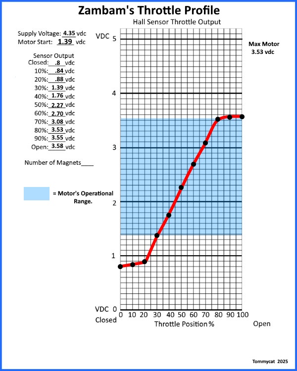

Throttle response changed after increasing battery voltage
Throttle profile battery @ 73.4 V
Moved scale on throttle for better view.
Added handle on grip for better control of throttle for the test.
Deleted the video in post #44 (battery at 71.7V) by accident. Sorry about that.
I transcribed the readings from video above (battery at 73.4V). With higher battery voltage, throttle voltage at rest is a little higher at 0.80 V. Top speed increased by 3 KmH. Rain today- no test rides.

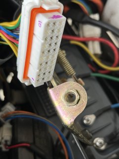

I put the OE throttle back. I suspect the controller's throttle circuitry became flaky when I hooked up 24S LFP battery (81V) to it where the instrument panel powered up but the throttle would not spin the wheel (on center stand).

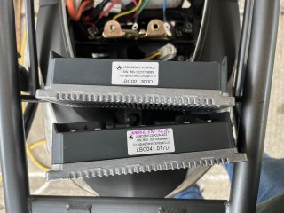

I have a controller from when the moped was a few weeks old when the speedo and odometer display stopped working and was replaced with a new one. I just installed that controller which only saw 64V (SLA battery). I'll be riding around with no speedo or odo. Will see if the throttle issue goes away or not.
