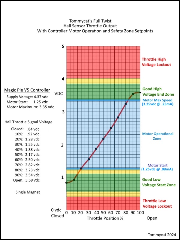

1.2 volts on the throttle signal sure is an odd place to get stuck... was it still able to move around when you're moving the throttle handle?
Just checking... from your perspective CCW = throttle down, and CW = throttle up, correct?

That's the voltage (that I think I saw from a quick glance) when I got no power as I gave throttle input.
Correct

The goal is to get it stuck in a faulted position. I.E. When the fault occurs FREEZE your throttle hand in the position it's in and keep the motor stuck off. Resist the temptation to respond to automatically resetting it, do not allow the throttle to return to the home position! Do NOT use the brake at this time if possible...
Hold it there, walk the bike to a safe spot and lift the drive wheel off the ground with the stand.
After achieving as good and safe a testing position as possible, always keeping the throttle twisted. Now you can lift the seat and check for the tattle-tail flashing controller error code hopefully set.
Look to see if the throttle voltage can be varied at this time with throttle movement. Do NOT let it get to HOME position! Testing in the mid ranges.
If need be, with the throttle secured in the approximate 25% power position. Start a series of physical checks and monitor the signal voltage.
Anything changes when you...
Turn the steering to full left to full right stops?
Moderately tapping on the throttle assembly.
Move or pull on any touchable throttle wiring or harnesses.
Have these steps in mind and be prepared before your rides. As always fully charge before going out to increase the odds.
Always be wary of an unexpected motor start!
We don't need any viral videos! :sick:
Good luck, and good hunting!
