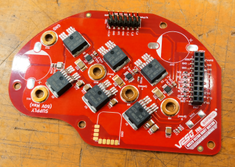

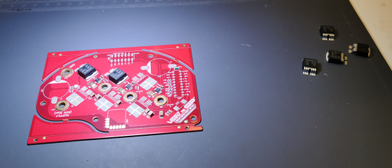

Here is an open source PAS/Torque sensor VESC
Here is another one
This is not Flipsky, this is based on Innotrace controller. You can not purchase it though, this is DIY controller. I soldered one for myself. So if you can solder this is the best VESC for mid drive e-bikes you can have and probably the best controller for mid drive PAS/Torque sensor e-bikes across all PAS/Torque sensor mid-drive controllers you can find.
And Vedder himself wrote the firmware specifically for this controller.
