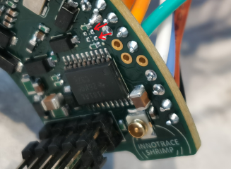

Prepared the rotary encoder. If you want to use the same rotary encoder you need to solder a 1 kOhm 0603 resistor (0402 fits too) to the R3 soldering pads.
26 AWG silicone wires can be used to connect it with the BRAIN board
Since the bottom face of the encoder will lay on the flat face the soldered wires should not stay above the surface
The 3D printed ABS plastic bracket for the encoder has been figured out. We are getting closer guys!
You can put a couple layers of 1" wide Kapton tape on the bottom of the encoder PCB to prevent short circuit. The PCB and the bracket parts can be glued together with B-7000 glue
You can mount it to the motor case with a couple of M3x0.5 8mm long pan head screws

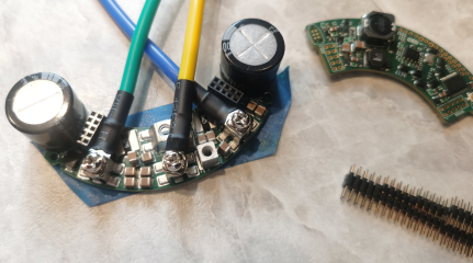

Crimped the new phase wires (the original Bafang M620 phase wires are very stiff and the terminals on the controller side are not quite suitable).
TE 322447 terminals are for the controller side
Molex 19001-0010 terminals are for the motor side
The phase wires are 12AWG silicone wires
This 6 pieces crimping tool set with different dies should work for both terminals
The Molex terminals fit well to the original Bafang M620 motor terminals

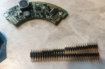

Please note I specified quite short headers for the BRAIN (insulation 4mm tall) in the KiCAD files so you might need headers with bigger offset depending on the wires, terminals and your cable management.
I ordered a bunch of headers with different offsets to check the fitment and for my configuration I am going to use 6mm offset headers to get enough room for the cables
Trimmed and crimped the Bafang M620 CANbus motor harness battery wires. For the negative lead I used same TE 322447 terminal as for the phase wires but for the positive lead I used Panduit PM6-3R-L terminal (it suits that place better).
The controller is so dense the leads occupy the whole footprint of the controller!
The 6 mm headers have been soldered to the BRAIN board and the most power dense controller in the world is basically complete!
And you can fit it deep inside Bafang M600 with plenty space left no problem

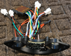

The connectors and the rotary encoder wires have been soldered! We are so close guys!

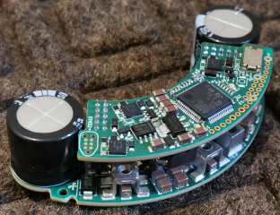

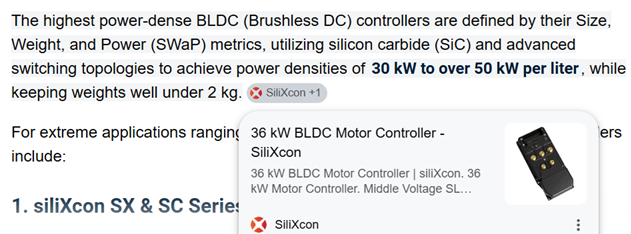

Guys, you guess what, we did it again! Unbelievable, it works, from the first try, how is it even possible! The WORLD RECORD is ours! We just built a 32.4 cubic centimeters volume motor controller (that volume includes the 2 large capacitors) with 10kW of power which is unbelievable 0.31 kW/cm^3 of power density!
Until today the world record was held by the 36 kW Silixcon controller with 0.05 kW/cm^3 .
The INNOTRACE Shrimp controller is 6 times more power dense over the previous WORLD RECORD! Guys, we just did the history and raised the bar incredibly high!

The Bafang M620 UART torque sensor works with INNOTRACE Shrimp controller! It will be interesting to see how it will act with M620 motor in comparison with M620 CAN torque sensor on the bicycle.
I found a couple mistakes in the torque sensor connections specified in the KiCAD files. I am going to update those things in the next release, but it does not affect the controller Gerber files. If you already started building this controller for M620 motor with UART torque sensor using the current KiCAD files do not solder these two resistors (those are for the CANbus torque sensor configuration only)
And also swap the PAS A and PAS B wires connected to the torque sensor otherwise the PAS will work in reverse

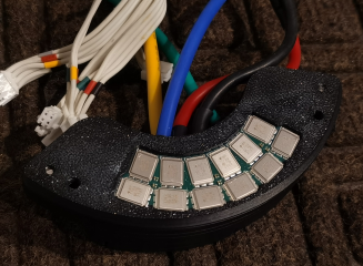

The INNOTRACE Shrimp controller has been installed in the Bafang M620 motor and the motor has been assembled!

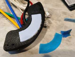

The bottom of the controller needs a not electrically conductive thermal pad. I used a 1mm thick ARCTIC TP-3 thermal pad
The template for thermal pad can be found here
For the Bluetooth antenna I used a 30 cm long MHF1 F to MHF1 M RG1.13 cable. The male connector can be chopped off and 30 mm of the antenna core can be exposed from the shielding on the cable end to work as a Bluetooth antenna
Here is the Bluetooth antenna routing

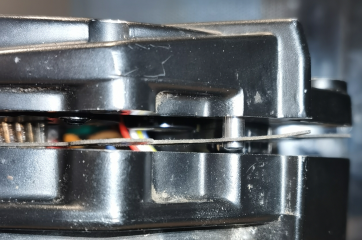

The antenna can be routed outside the motor case through the grommet like explained here
Be careful attaching the motor halves together and make sure the wires got not pinched
