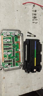

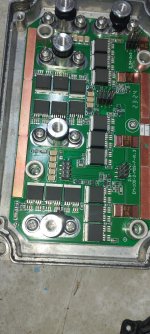

Hello guys, anyone had problem error "overcurrent"?
I have a Votol em100 GTR and suddenly, at morning when twisted the throttle it stopped. It was running ok for days. The ONLY thing different was phase current set 9000 -> 9600.
With multimeter it beeps when I connect probe from Positive/Negative to Blue phase.
Also BLDC Tester shows this (B, b and C slightly on):
br
bro i already replied to you facebook post.. if I'm not wrong.. its your blue phase (mosfets) are faulty..
br
Hello bro, thanks for repply. Yes, there are bad mosfets on blue phase group. Fix is only by repplacing faulty MOS.
I will let some Votol em100 GTR photos here. PS: there are no reference on the mosfets.1000293764.jpg

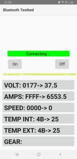

Hello Can anyone share a link to the WECHAT MINI VOTOL SETUP APP for android... i cant connect to wechat and i have been charged though... says cellphone not linked to any account but that was what i tried to do... thks in advance
i can share in exchane an android app made by myself to have speed volt and temps in my phone...
