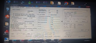

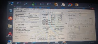

Hi All, I have a 51V Nominal moped Max output 280A, Hub motor (silence s01) with Votol EM150/2
im programming to unlock top speed as its locked to 60mph from factory.
The motor starts to jump in speed above 1050rpm (around 67mph) and will jump anywhere between 67 and 80 without moving the throttle from the position its in.
Please see my settings below and let me know what im doing wrong, and how i can fix this issue.

On page 2 "HDC lowrst speed" 1000 change to 1200 or more. It not recommended, but maximum speed will be higher.
