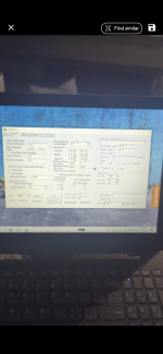

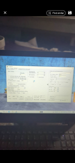

Hello, I have been using the em100gtr from AliExpress, I used it on 48v at 50 amp while I built the battery to use 72v, it performed well. my son rode the bike around the yard one time at at 72v and it also performed well, he was in low mode which I had set to 40a. He finished riding and parked the bike. Then yesterday I turned the power on and nothing, I plugged in my laptop and saw an over current fault, after reset the fault is gone but as soon as I turn the throttle it returns, also I can reset and then if I roll the rear wheel it immediately over current faults again. Nothing happened while he was riding, he was pretty gentle with it just riding around the yard.
Before I chalk this up to a bad unit, can someone review my settings please.
I have changed the high speed switch to sport mode, and set sport mode box to empty function
I have set 100a max
I have set battery regen to 0 I believe
And I have set the three speeds to 40-60-100.
I don't see how we could have damaged this controller with the very easy riding around the yard in low mode.

Also I have disconnected the phase wires and put them together and turned the wheel by hand for each combo of wires and they all feel the same, I also tried to check for continuity between the hall sensors, I found nothing abnormal with the motor, I will be trying the motor with a smaller esc later to try and use the auto detect function and check for errors of the motor. But I think this is a controller fault.
I assume I should not have continuity between the phase wires and the battery terminal, this indicates a blown mosfet(s)?

Mine is from dkys. I changed the bus bar amp to 100a, values for the three speed switch to 40,70,100, and did the self learning for my hall sensors, and the throttle ramping to 220. My son and I both rode around the yard a bit, it was fine, he was on the low setting at 40 amps, and was trying to pop wheelies, all was good, then he parked, the next day I went to get it out of the shed and it wouldn't do anything, over current faults when the throttle was touched or the wheel spun manually, then I had continuity between the power and yellow phase so I assumed the mosfets blew. This controller worked well at 48v, but when I upgraded the battery to 72v it died.
I think maybe the "gtr" is not up to the task.
