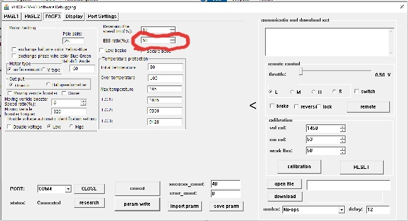

Only thing left is i still could not figure out how to deactivate the automatic regen.
Hello... glad to hear you solve the problem...
Enviado desde mi SM-N960U mediante Tapatalk
Just use 0% here in page 3... It will disable regen
I already tried the setting on page 3 with 0% but it still does not work.
This used to be the regen brake when using the mechanical brakes and activating the "high brake" signal but that does not work either.
Regen seems to be "always active".
This is what page 4 shows
