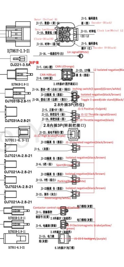

Qs138 and EM150/2sp wiring issue!
I think every thing is setup properly and my display comes on but the motor will not spin. I have read all over this thread and i have not found a solution i havent tried.
Please help!
I got the QS138 kit with EM150/2sp and wiring harness from http://siaecosys.com. I have followed the wiring diagrams and tried a few tips from this thread. so far this is where i am.
The motor is connected to the controller via the hal connector and the BGY phase wires and B+ B- are connected to the 72v battery.
I have jumped power into the Yellow ignition wire which made the display come on. I also jumped power into the grey/purple E-lock wire. The display comes on but doesnt show anything but the battery level.
I connected the red,black,green throttle wires to the pink,black,green throttle wires on the controller and the blue,grey,orange gear switch wires to the black/white,black/brown and green/white gear wires on the controller. still no gear apears on the display in any gear selection and the motor does not spin with the throttle.
i have discovered that if i connect the bullet connection for the purple “one line” and the controllers white “line signal” wire the display says the gear is ‘P’.
Please tell me what i am missing! What can i do to troubleshoot?
Thank you all!

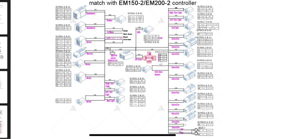

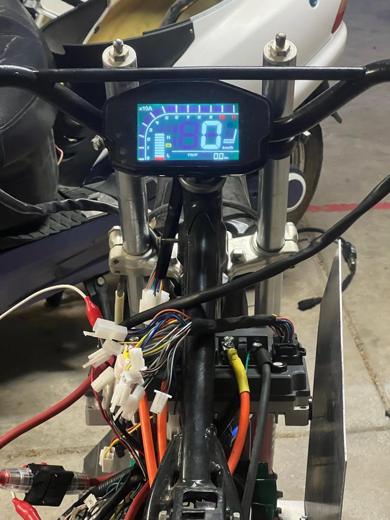

Hey all hoping someone can chime in.
So I’m wiring in my throttle setup. It is a throttle with the added blue and yellow wires that plug into my controller. The other 3 wires are green, black and red.
Currently I have my yellow wire going to battery + and the blue wire going right to the gray/purple E-lock. I do NOT have a battery + going to e lock. Just the blue wire that is part is the throttle/key assembly.
Everything powers on and is ok. Can I leave it like this as I don’t have actual battery + going to the e lock? I suppose the blue wire is putting out some voltage but I haven’t measure it’s output.
Below are pics. The yellow wire goes right to battery + and the blue wire goes into where that red posi-tap is which is the gray/purple wire.
I watched a Dr. Chopper video and this appears to be how his bike is wired in this particular video. https://youtu.be/yLmT4m3XMdE
Also a pic of what QS sent me stating how to wire it all in.
If you bought a combination throttle/key/display (optional) then the 3 throttle wires go to the throttle connector and the two other wires go to battery (+) and controller ignition. Which one goes where should be in your instructions. If it has the display then it will only come on when the key is on, otherwise the wires are reversed.
The key also sends power to the accessories, either directly if they are rated to battery full charge voltage or to the dc/dc converter which supplies 12v to the accessories.
Of course the key can replaced with a switch of adequate current carrying ability.

Awesome, thanks for the info. Yes, it is a key switch/throttle and digital voltage display. Looks like I have it fine then. One wire goes to battery + and one wire goes to controller e-lock. Thanks again
