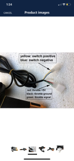

You bet. I should be able to tomorrow when I’m back at my shop. Below is the throttle I have. I’m also using a hub drive 3000w V4 motor but connections should all be the same.

You need the debugging software free from SiaEcosys and the cable for your controller. The motor/controller/display are paired for a specific voltage. If you provided that voltage when you ordered it should be set in the ball park.
Your throttle has 3 wires +5v, 0v, and signal which will typically be 0.8v to 4v as you twist the throttle. It gets power from the controller so the ignition must be on.
The throttle you have has a key switch with 2 wires. 1 wire goes to battery (+) and the other goes to controller lock (ignition). If the mini display comes on when the key is off then the wires need to be reversed.
Your accessory will also be powered by the wire from the key switch to the controller. Your ignition and LED lights provided they are designed to work with full battery voltage, Those wires are thin so don’t try to power too much. If you have more than 1a accessories you probably need a better switch.
If its all connected correctly, with the switch off you will have battery voltage to one side of key switch, 0v other side 0v to all throttle wires. When you turn key on, it should sent power to your controller ignition wire and main display, and you should see 5v, 0v and 0.8v from the throttle.
If everything is set right the motor will be ready to run.

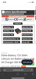

Again, thank you! I bought a cheapo windows laptop from bestbuy to go pickup today so I can utilize this as a programs computer along with other windows based things I need. It was only $100!!
I found some specs on the battery I purchased. One from BTR’s website one from their Amazon page. Both seem to be the same on specs. I’ll get my 3 speed switch hooked up and get the software downloaded and go from there. Hopefully not locking anything up as I’ve read before…I mainly just want to make sure my rates are good and I’d like to bump up those throttle rise/decrease numbers. Not sure if I’ll set up anything regen or not yet. I don’t have any powered brake lines. Just one big hydraulic front brake. The rest of the lights are on a 12v system but it’s entirely not part of the main 72v battery system. I’m not using a DC converter. The image below is the 12v battery pack I’m using for lights.

Your battery is pretty small for your controller. Its a 50a bms and thats the max current your controller should be set at until you get a bigger battery or add two more of those in parallel.
The 100a peak is just for inrush when you first connect the batteries to charge the capacitors. Many people jave the problem that the battery BMS shuts the port due to high inrush current, which you will see if the battery is removed several hours and the capacitors drain.
If you want your motor and controller to work at rated power you need a bigger battery with higher rated BMS. Normally once you bet to that price you want a Bluetooth BMS that lets you set your preferences and see what the cell difference is, if its currently balancing, the current going in or out, etc.
