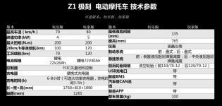

Dear Experts!
I've bought an electric motor, which has a QSmotor probably 3000W version,
https://www.qsmotor.com/product/3000w-motor-assembly/
(or the weaker 2000W one)
claimed as max 3.7kW in power mode in the seller's paper and has probably an Votol Controller EM-150 or 100 controller accordign to the images and how it looks like from outside.
This motorbike is really fast in power mode, it can accelerate faster than any 125size motorbike until 40-45kmph then it just stops accelerating... so maximum 45kmph.
(Due to the CoC paper regulations, but it is not that accurate, with full charge it can go up to 48kmph on the spedometer, ít half capacity max 46kmph if downhill of backwind.)
My question is, is there any specific speed limiter by wire (some people say I only need to disonnect a wire, but I think it is just their guess) or it vould be the enable speed limit in the configuration?
It has no speed switch onlí a 2 way ECO/Power mode switch, i am not sure is it a sport mode or soem kind of 2 speed switch?
How could I check it?
In that case I have to build an usb cable for it to check its config.
Does it need only a TTL-USB converter liek an FTDI cable I use for Arduino programming for example?
Thanks for any help in advance!
What did you buy? A motor? A kit? Or a complete electric motorcycle?
If its a whole motorcycle what are the whole specs? Did you buy it new from a legitimate seller? If so whats tge link to the item? You sent links to a motor but saying you a are afraid to take your bike apart due to warranty.
It sounds like you just need to get the debugging cable for that controller and set the settings for your battery BMS and motor.

Hi BareKuda!
Yes "its a whole motorcycle" with CoC paper to use in EU here with AM license, but it is limited to 45kmph according to law and I just want to test its full potential.
I cannot say its name as when I was looking for info how to remove the speed limit I heard that there were German sites about the process an all was removed, no more search result, so they search on the Modding results and make it disappear....
don't want to risk this page and the info.
I also don't want to ruin thy 2 year warranty so not planning to make irreversibe modifications.
If it is possible to connect and import params save to ini then remove speed limit by setting which is reversible then I want to try it.
I am experienced on brushless motors and arduino microcontroller programming I made lots of drones and drone firmwares in the past so if it needs just a FTDI (TTL-USB) adapter and if I know the pinout and the software I could make it I guess on my own.
I cannot see the top of the controller yet as there are lots of plastic covers a fake gas tank etc and hologram stickers on screws just not to be able to disassembly without ruining the warranty, but the plugs are visible and I could locate the debugging port, btu did not find it yet.
I know that the QSmotor 2000W mid motor KIT is used and the recommended controller is the VOTOL EM-100 or 150.
According to the heatsink size I mesasured now approx 215x114 dimensions it fits the EM100S which has 218x123mm dimension of heatsink on the controller.
I have to collect as many info before taking the bike apart to avoid losing warranty.
I can attach a picture of the bike without writing its name, maybe it is not that risky :)
p.s.: I checked how the plugs come from my controler on the top by my fingers from the side, and it seems that not matching the VOTOL layout, it hes one big plug and a smaller, not 2 smoller like VOTOL :(
I draw it in a picture.... so maybe VOTOL is recommended in the KIT but the motor company changed to their own controller or a different one :(
edit:I searched for other hours on alibaba to find which controller has same heatsing and plug design, an found this 1500W noname undocumented one:
https://www.alibaba.com/product-detail/Brushless-DC-1500W-Electric-Scooter-Elelctric_60744970545.html?spm=a2700.galleryofferlist.normal_offer.d_title.6e6b4f19KmQ8nc
probably I have that and not VOTOL, so sorry, I am in the wrong thread and have to find info on that controller not VOTOL.
Not sure if teh VOTOL is compatible, but if compatible I could buy a VOTOL EM-100 which fits in place and could be better than this noname one...

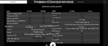

I can link the motor specification:
https://www.qsmotor.com/product/2000w-mid-drive-motor/
https://www.qsmotor.com/product/mid-drive-motor/
Here copy pasted data from the electric motor sellers spec:

fotoamg said:
On the diagram the "speed limit" is an analog input voltage reference betwean 0V(GND) and +5V lines.
On the poinout pin 25 has teh speed limit.
So probably I have to connect pin25 to GND or +5V to disable pin limit on that LM96152 version too.
Yes, if this is connected then unplugging it might release the beast. That controller seems programmable but not sure where the software is.

Your bike is actually made by ZongShen in china, two models available, 26ah with 4kw motor and and 40ah with 5kw motor:
http://m.cineco.cc/#/product_details?id=0&lead_product_id=127
In the picture showing the controller programming app, do you have that already? I cant find the controller yet but im looking. Based on the number is 84v100a but used in 72V, so it should be capable of 7200 watts peak which is fine for a 4kw motor.
Once you have the ability to program it, i think you can at least get the designed 70 kph and maybe more. Depending on how much flux weakening it can use effectively.
