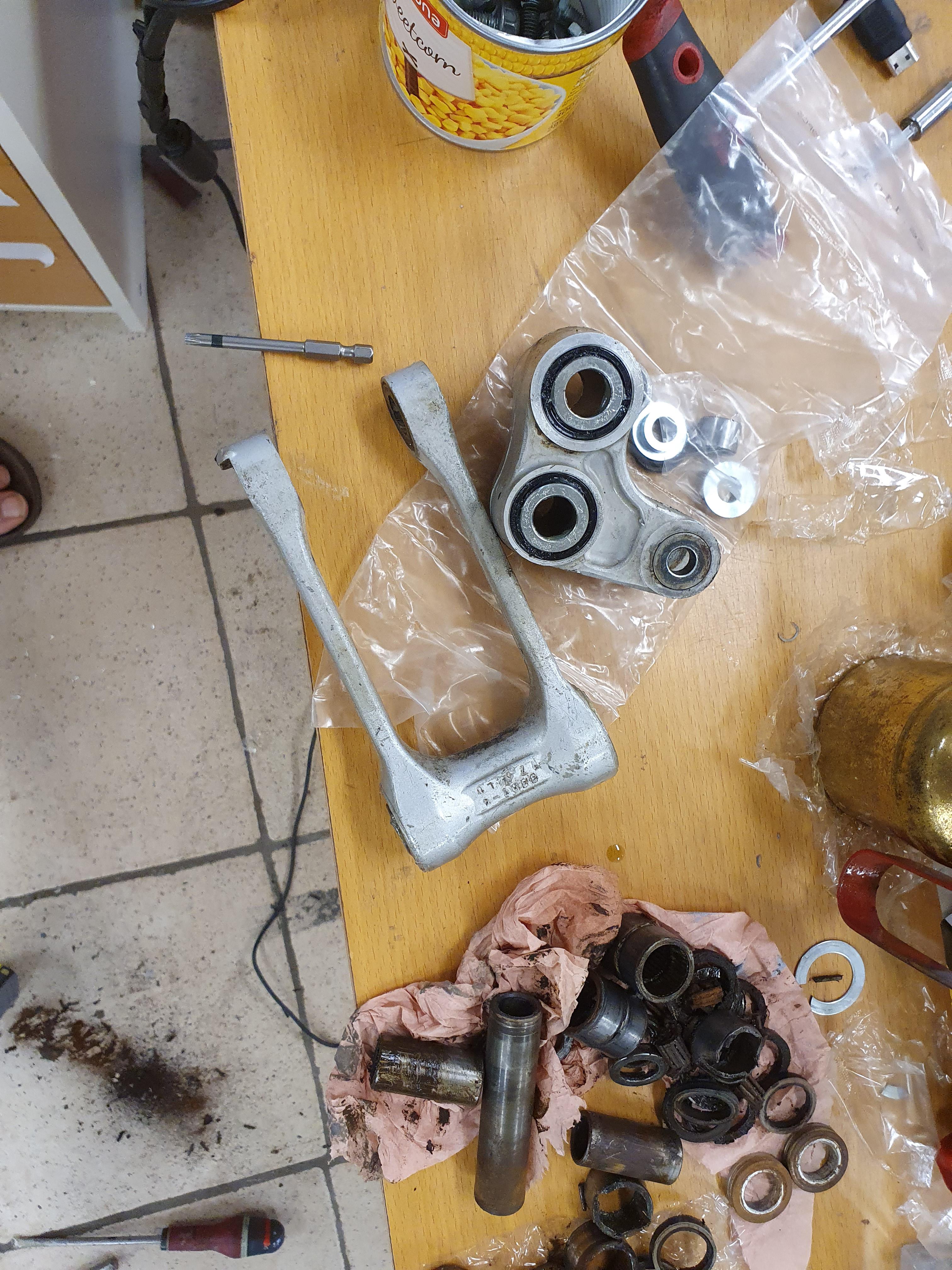

Ehum, changed all the bearings in the rear suspension:
I knew what to expect from the linkage bearings (the top pile), but the swing arm bearings (the 2 bottom piles) were really bad :oop:

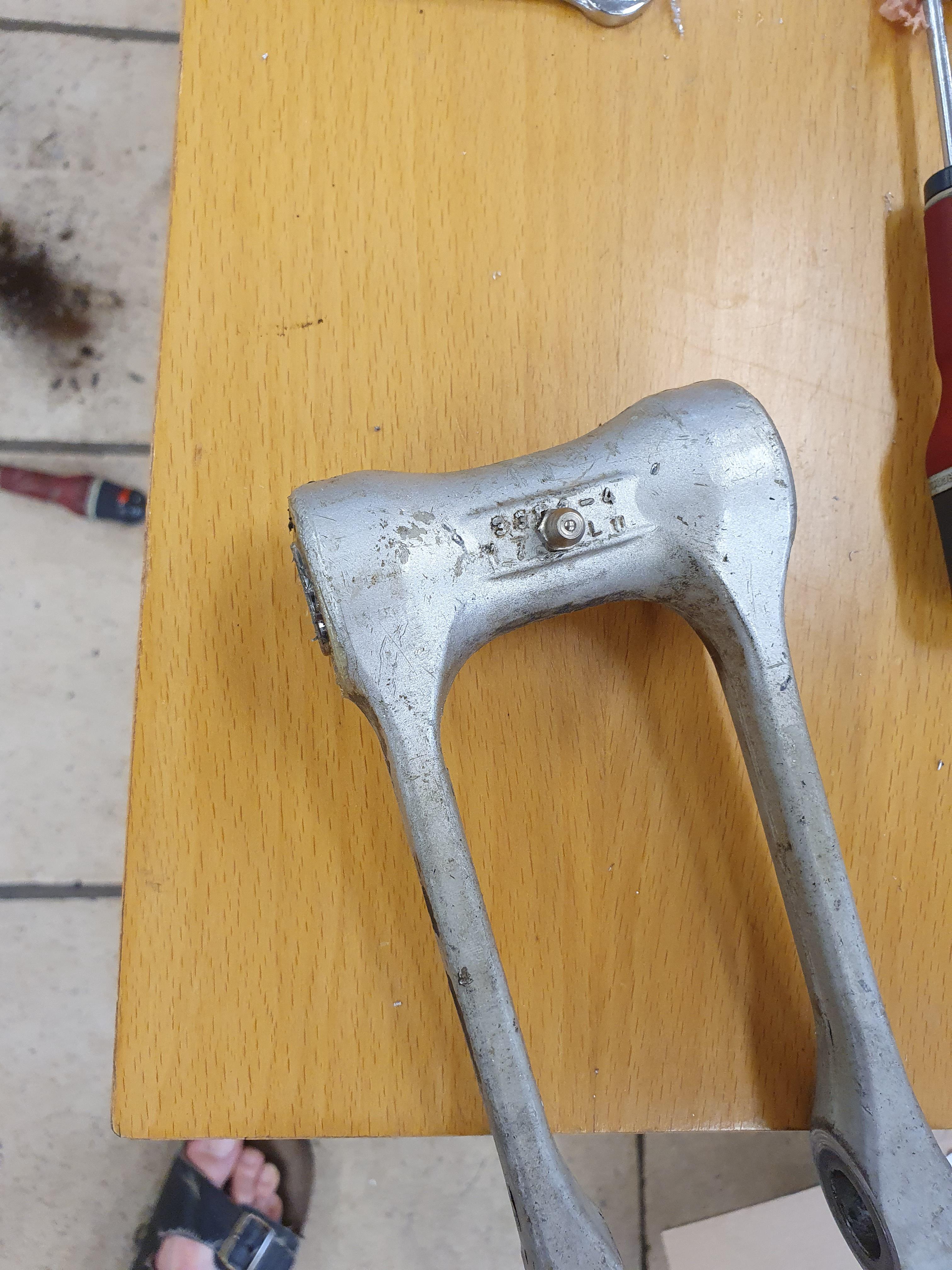

This might be abomination on a dirt bike, but I actually put grease nipples on the swing arm now..
And here, on the dogleg(?)
Not on the part that connects it all, that is a lot easier to change bearings in than the rest.
It might be possible to do on that too, but I would have to test the movement without a spring to see if there are clearance.
And drill the holes when the bearings are out.

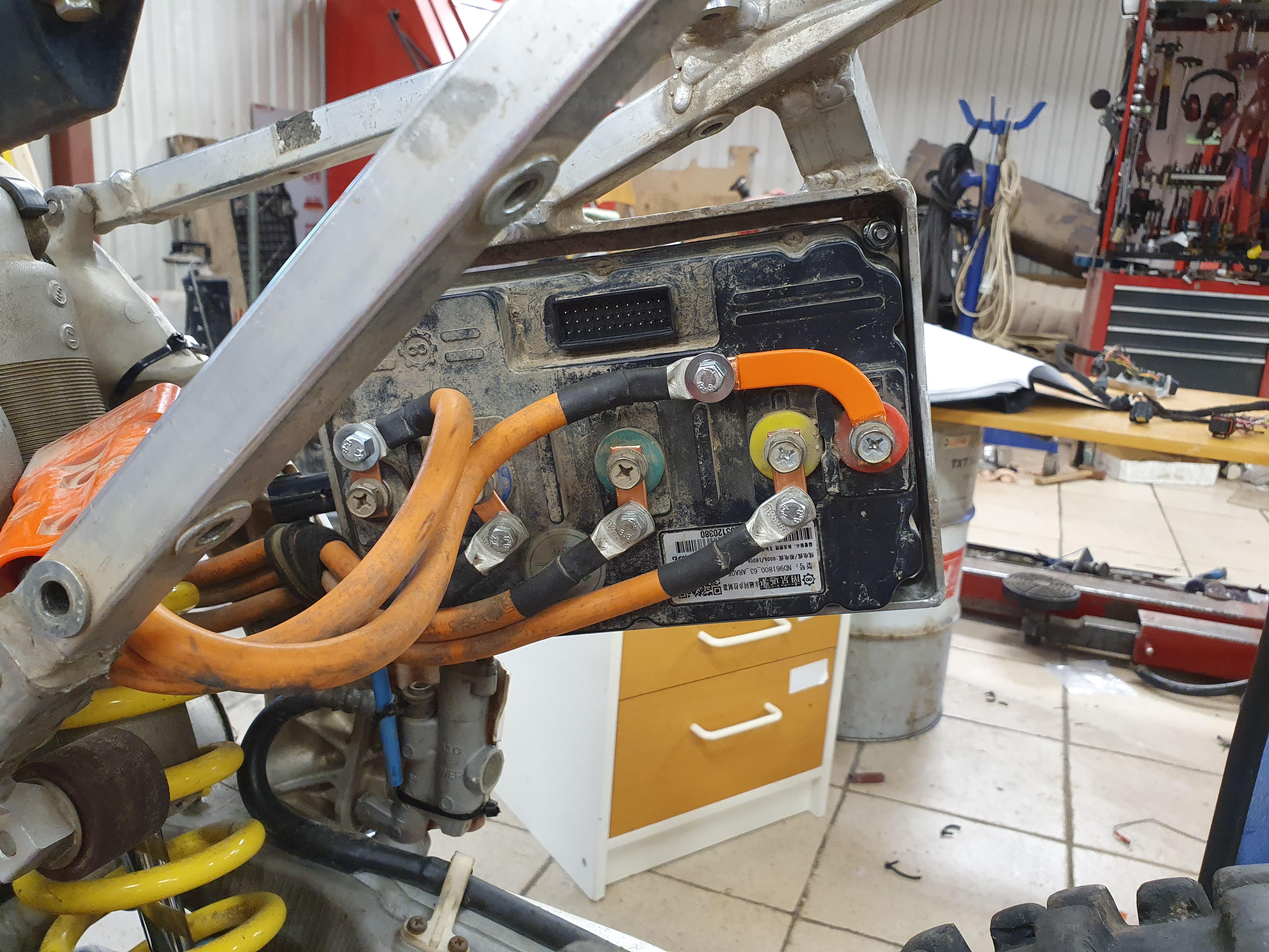

Working on getting the fardriver back on the bike with as little modifications as possible :rolleyes:
Was able to save battery and phase wires, will have to cut the rest.
The thought sure has crossed my mind to build a wiring to each controller so it would be easy to swap.
But dammit, it should not be necessary:confused:
