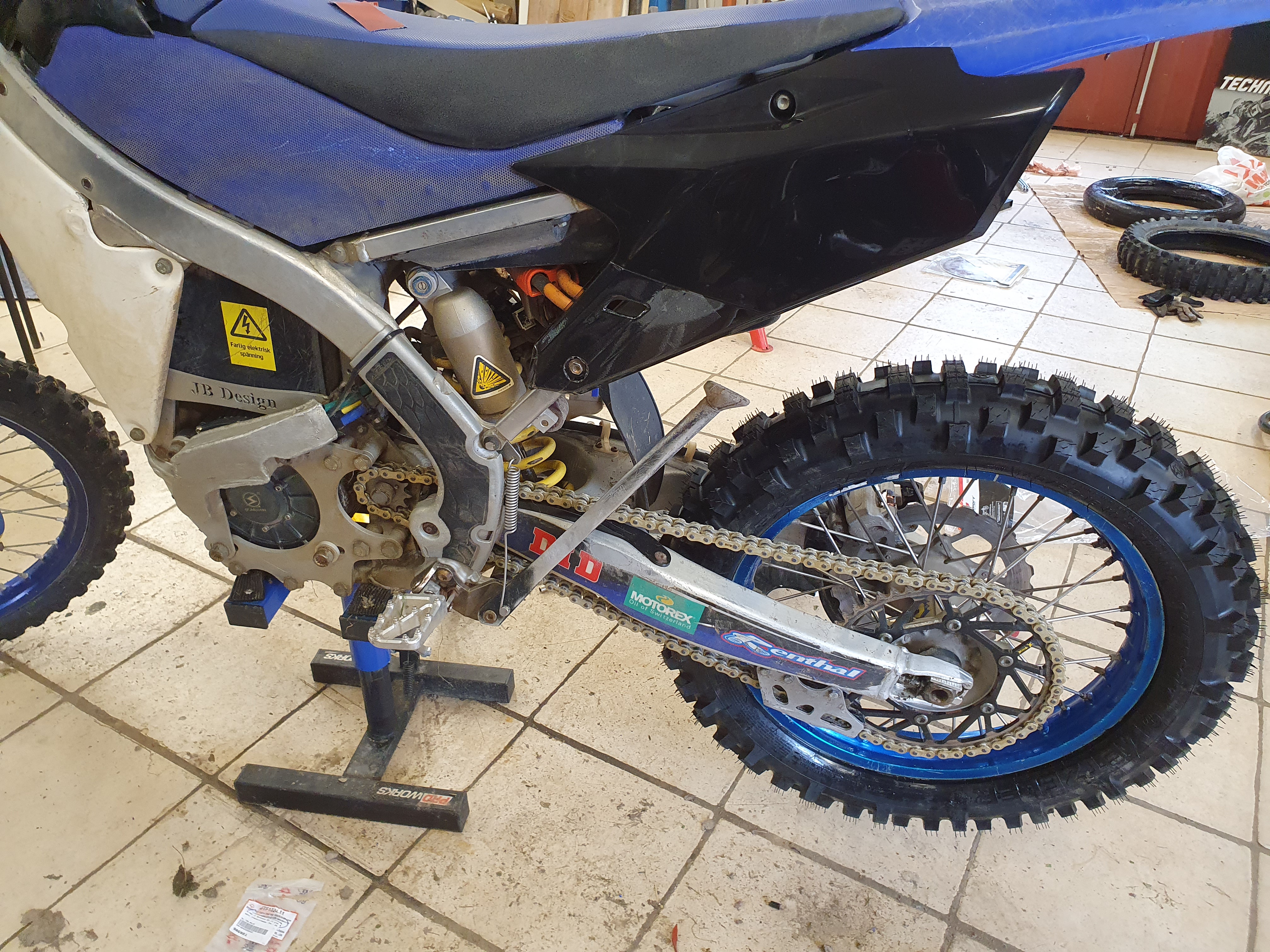

Yamaha YZ250F
Im not really scared to push the bike to its limits, I am rather happy to put it to the test.
I mean, if it cant take a little mud and water it is no real dirtbike.

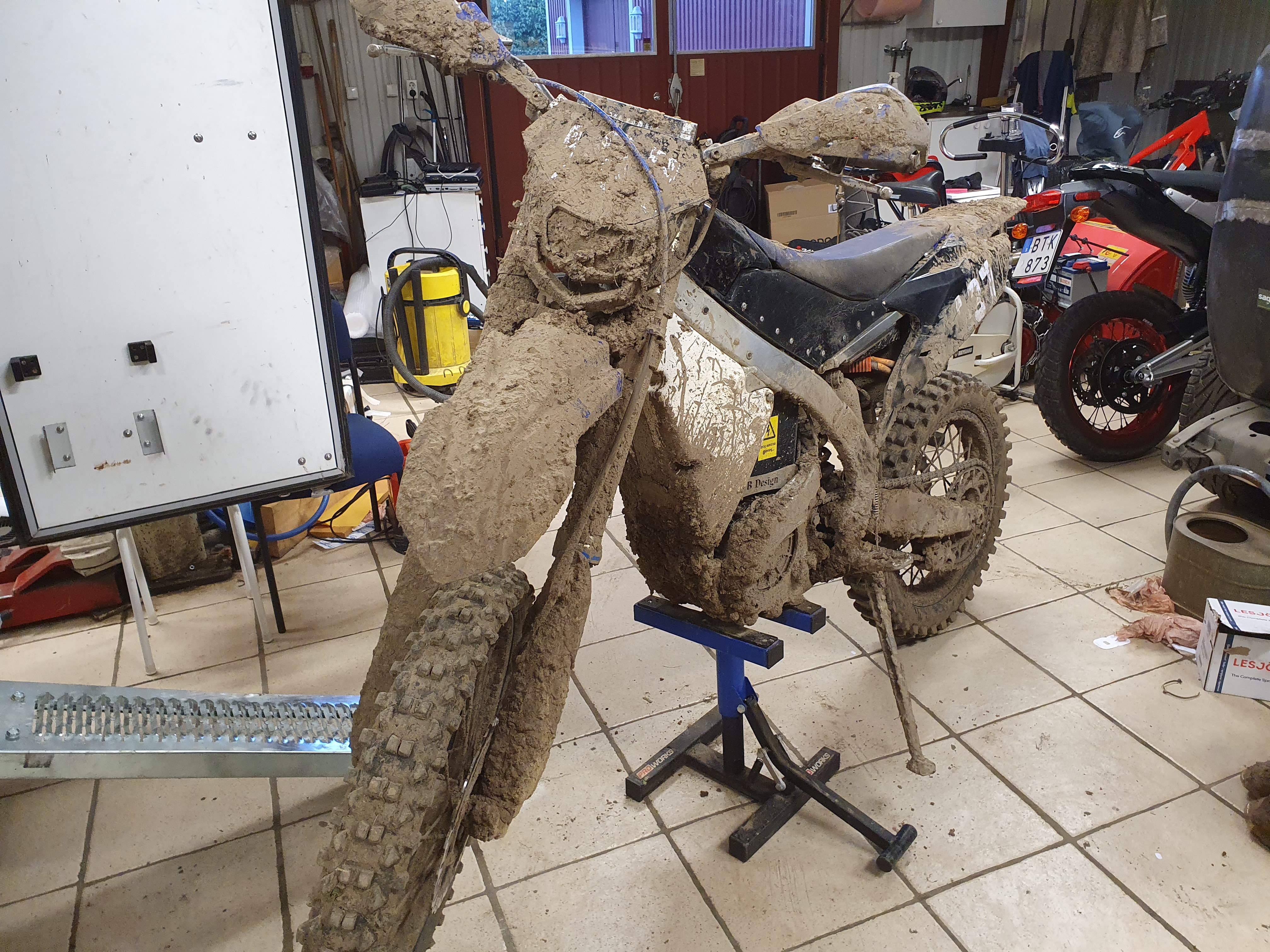

It was muddy, and it dosent really show on picture as usual. But here is one for now:
I will write up a race rapport for those interested later ;)

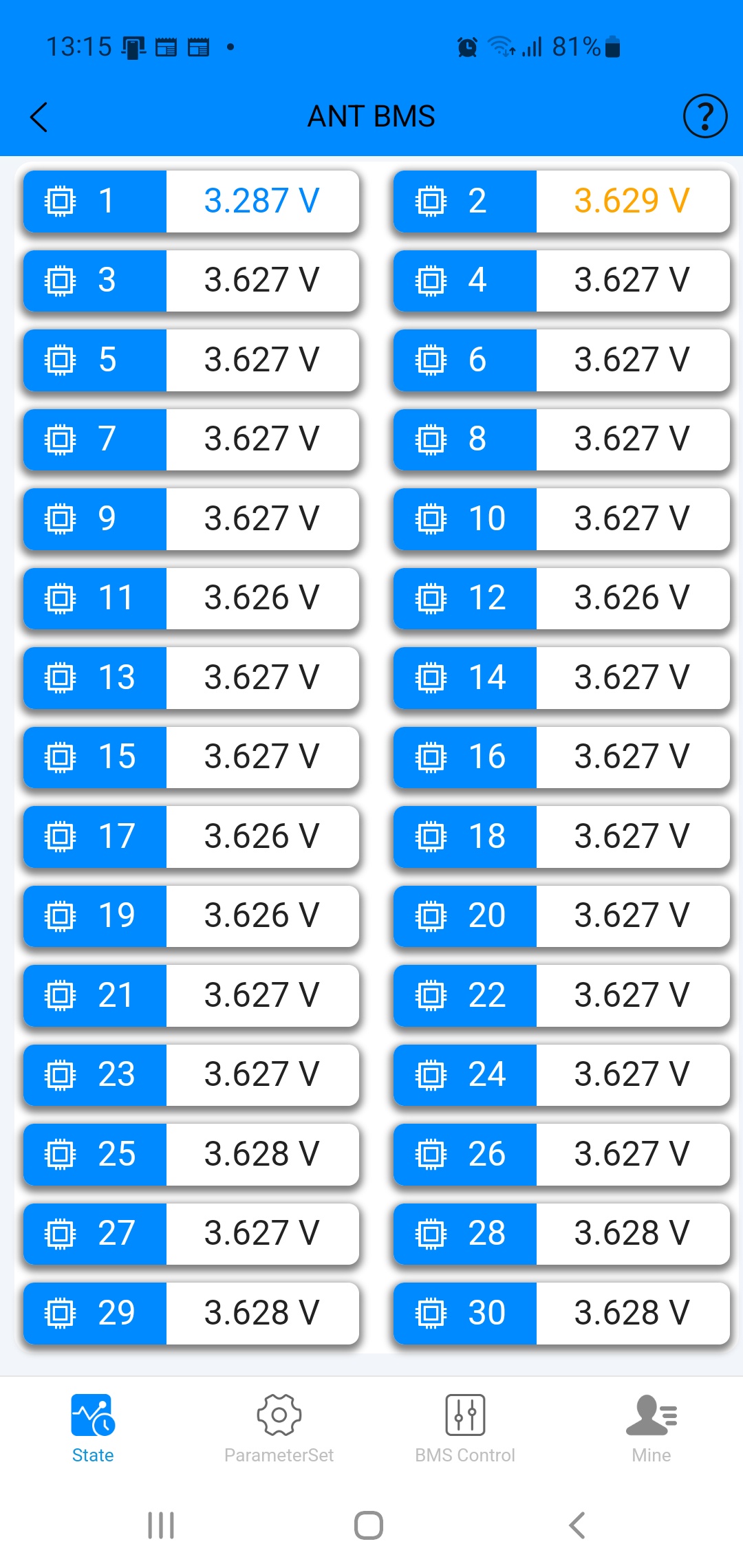

I then notice that cell 1 reads 0,4v lower than the rest, shit 😧
I didnt bring any charger or anything, so I need all 3 batteries. I change battery and save the problematic one for last, at least I wont be stranded on the first lap..

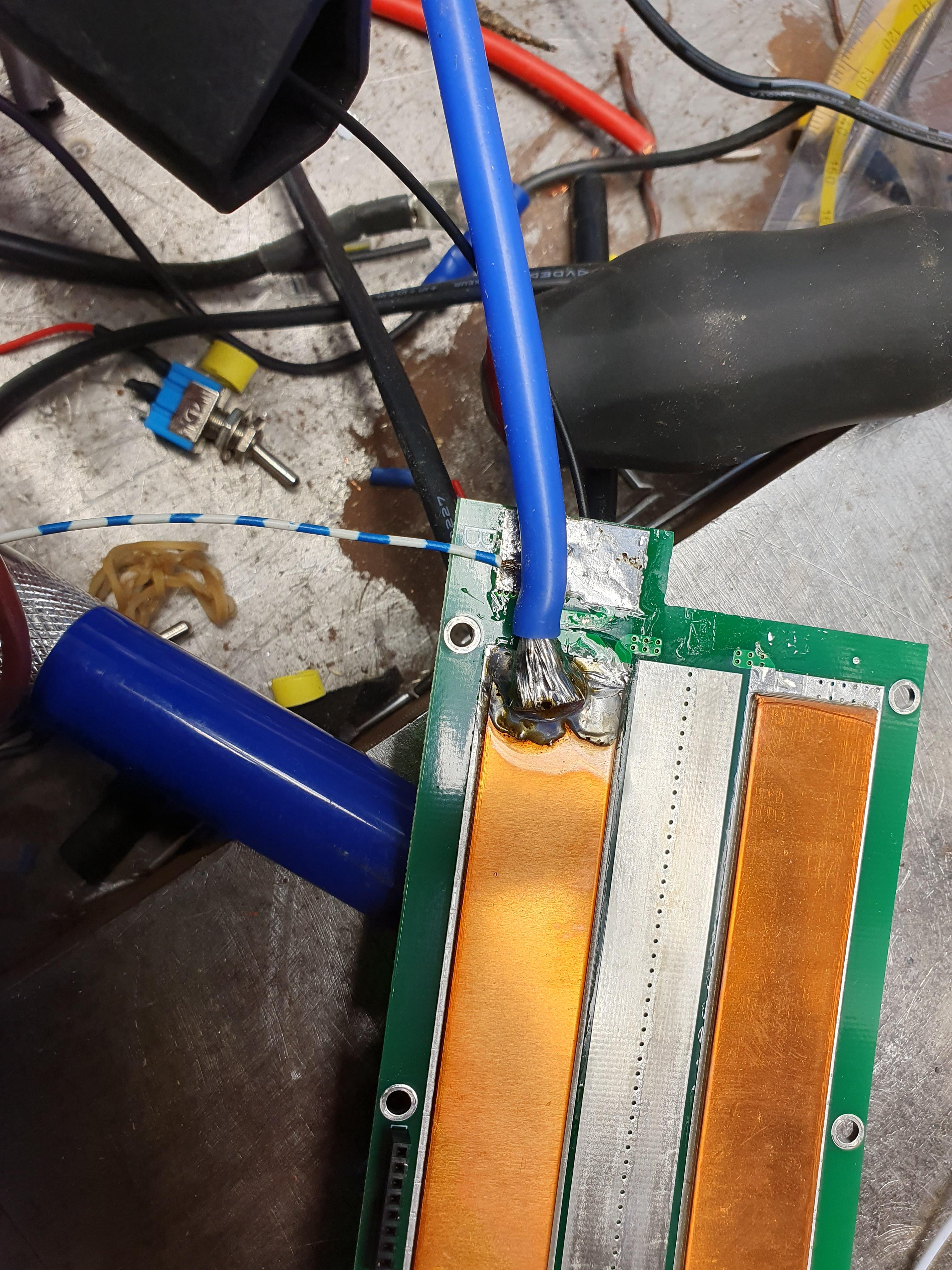

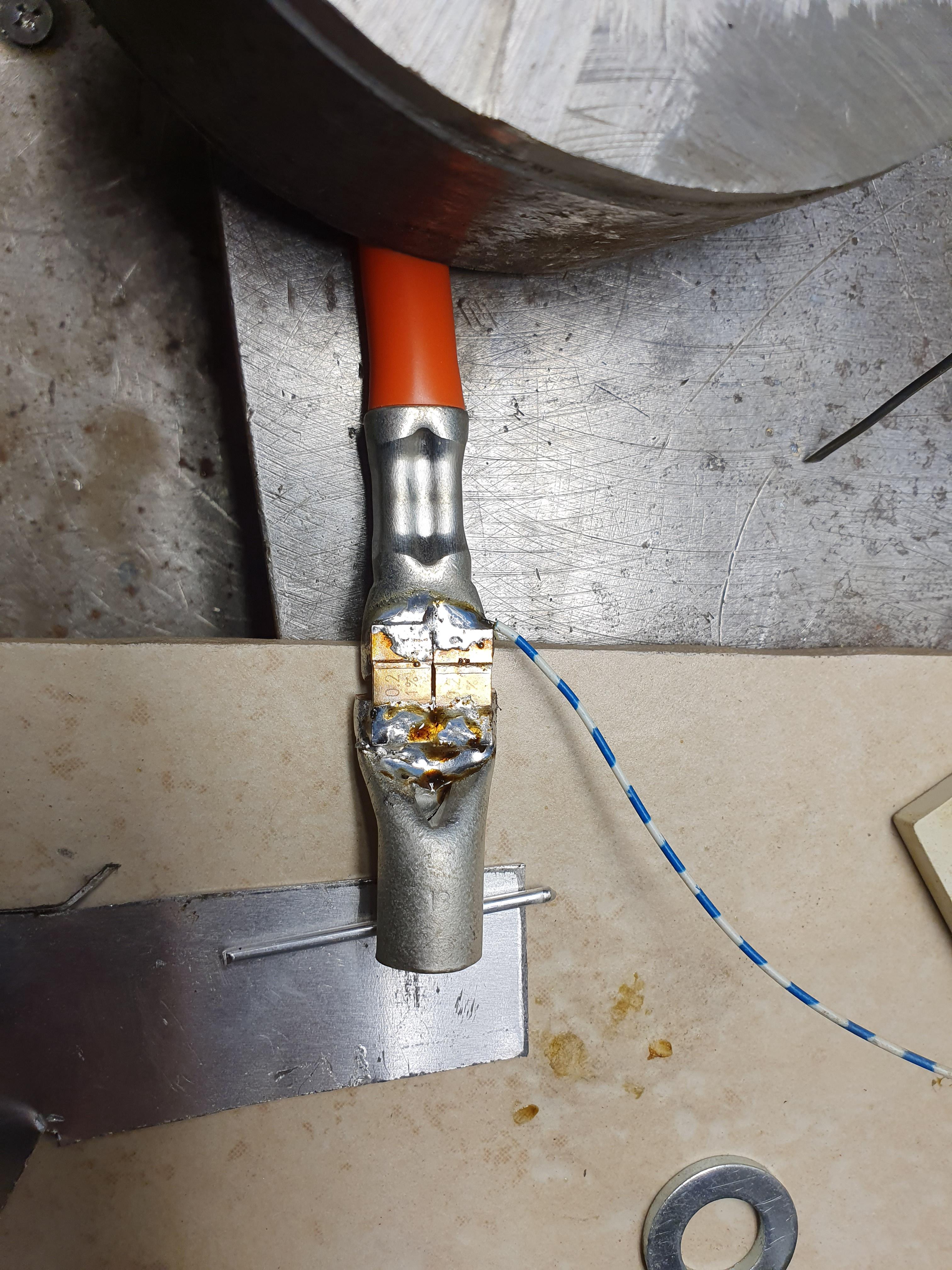

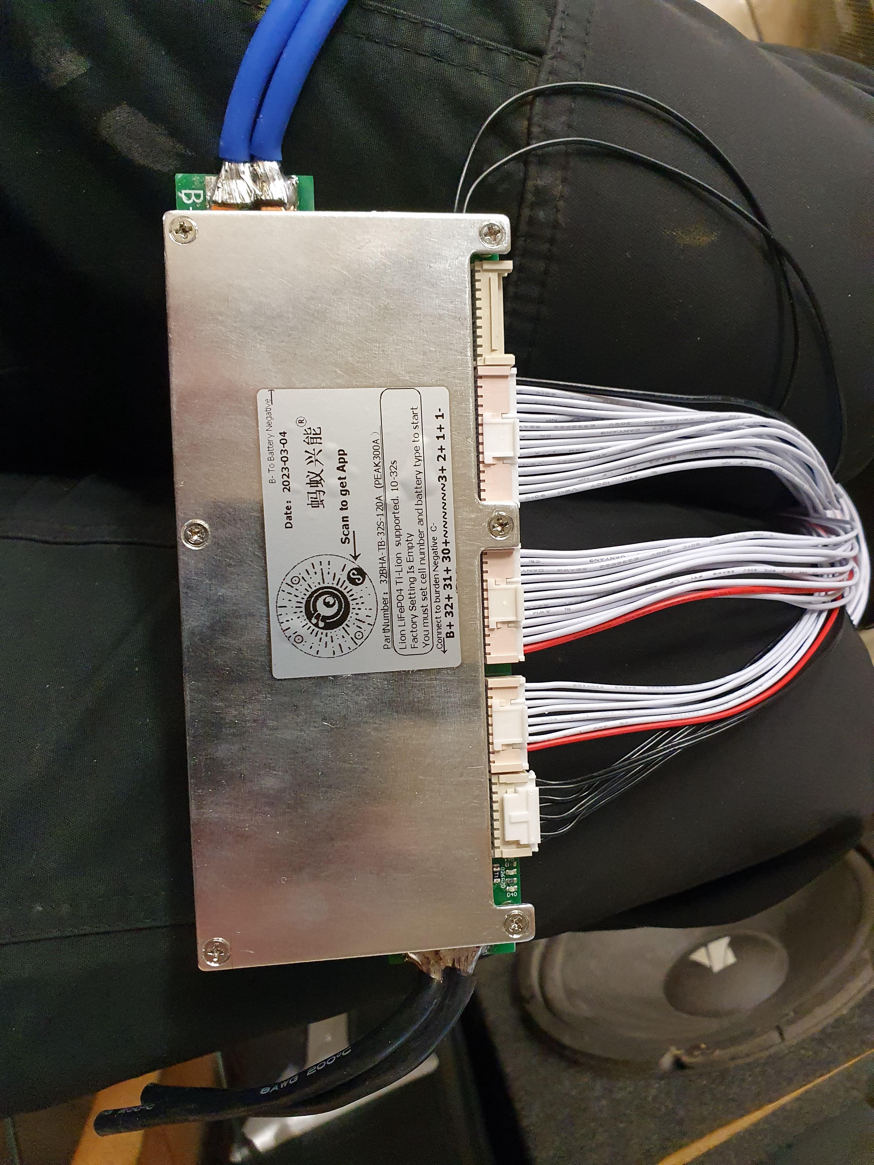

I am pretty sure the low cell 1 is a bms issue, as it has happened twice before on the same battery.
The question is why?
I have modified the bms by moving the shunts to the wiring so I can bypass the mosfets for discharge, and still read the current.
Ant 32s 300A bms.
The shunts on the powerboard of the bms.
The shunts moved to the wiring, notice the small wire on the side connected before the shunt.
Here it is connected to the bms where the shunt should have been. Also a thicker blue wire for charging.
The trace on the pcb on the other side of the shunt is cut and a wire is replacing it just in case there would be a small voltage drop in the blue, thick wire for charging.
I have done the same mod on the other 2 batteries and had no issues with them.
Then I bought 2 more bms:es of the same model, but it was a newer firmware I suppose as it needed another app to set up.
One that needed gps position, I dont know social status and bank account nr maybe for it to work.
One of the bms:es had this problem right away, or very soon after install. I changed wiring, battery module etc. that didnt make any difference. I changed the measurement part of the bms, then it worked.
I contacted the seller and got to send the first bms back to have it repaired or replaced.
After a few mounts or something the second bms got the same issue, reading the wrong voltage on cell 1.
I then changed to the measurement part of the repaired/replaced bms, and it has worked for a year or something until now.
The idea with the post before this was mostly that people more knowledgeable in electronics than me could give suggestions to why this happens, and can I do something about it? ;)
Can my mod be responsible somehow?
Or just if anyone have had or seen the problem mentioned anywhere else?

I've got one of those bms... I was going to just rip the FET board off.. I'll post back when I've had a poke around in it.

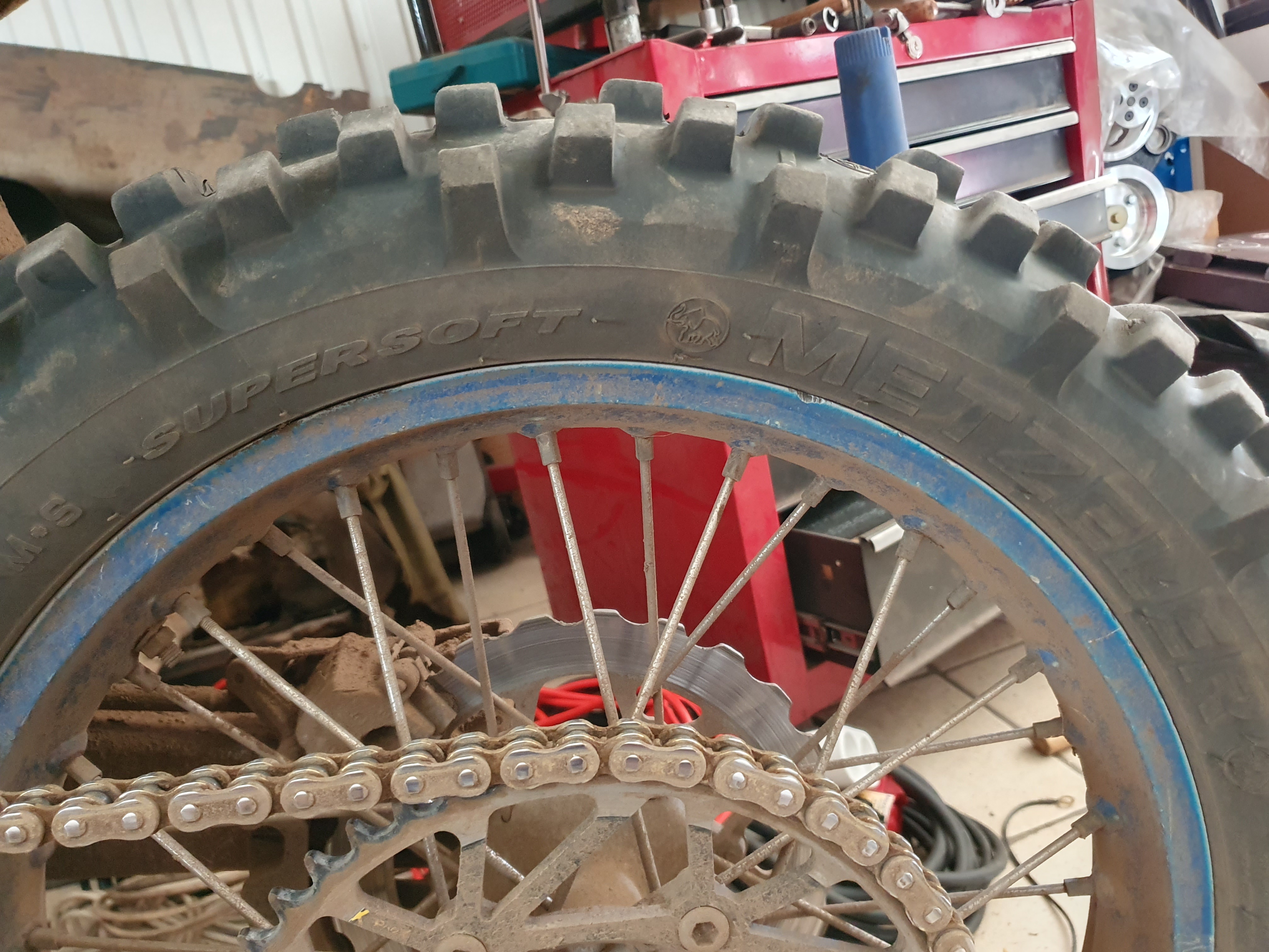

Anyway, got like 2 more km before I hit something and bent the chain guide so the chain jumped off:
(it was on the inside then)
Was able to bend it back a little with rocks and branches, got the chain on again.
The bike locked up when I tried to push it :oop:
Got the chain off again and pushed..

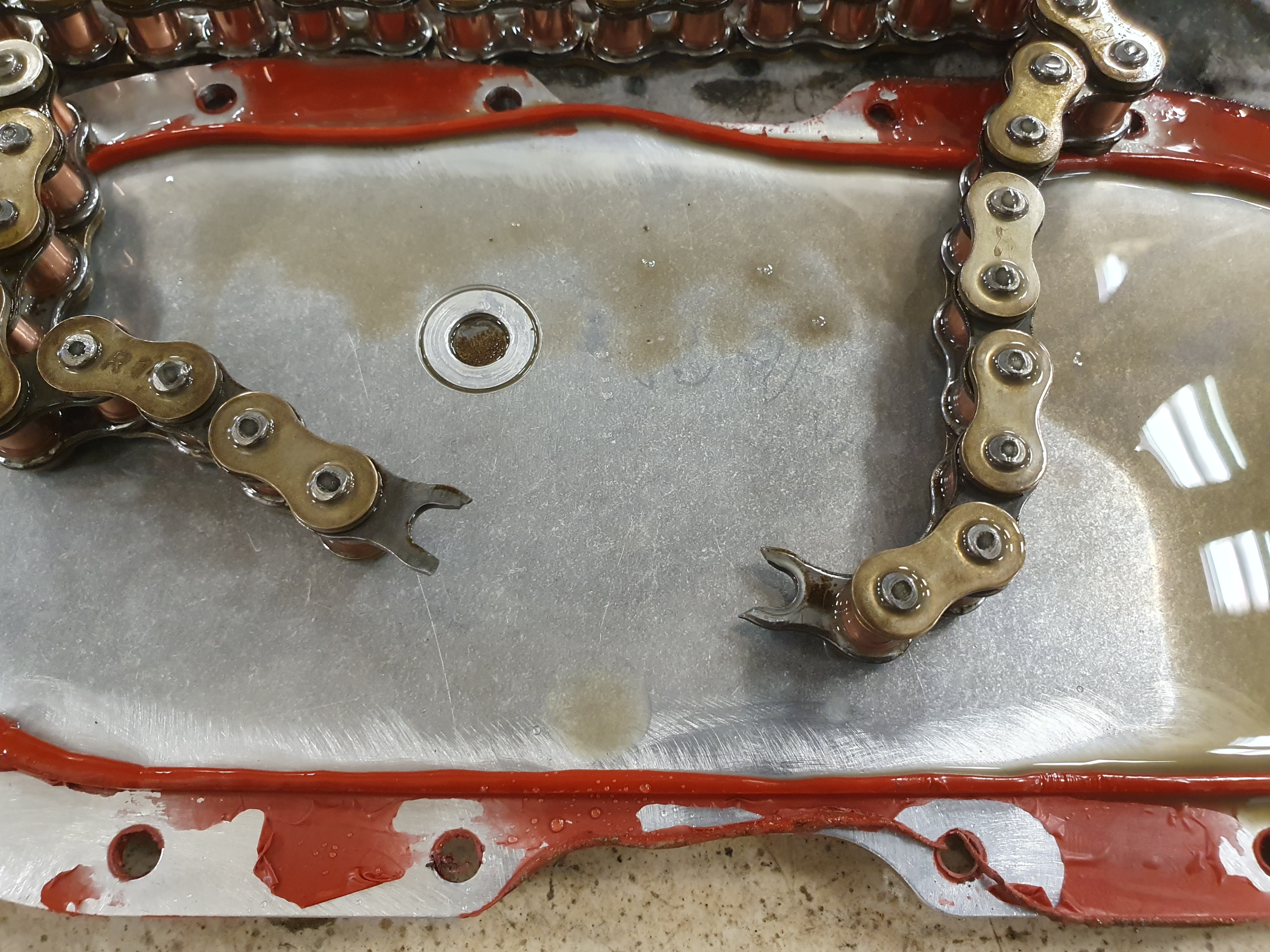

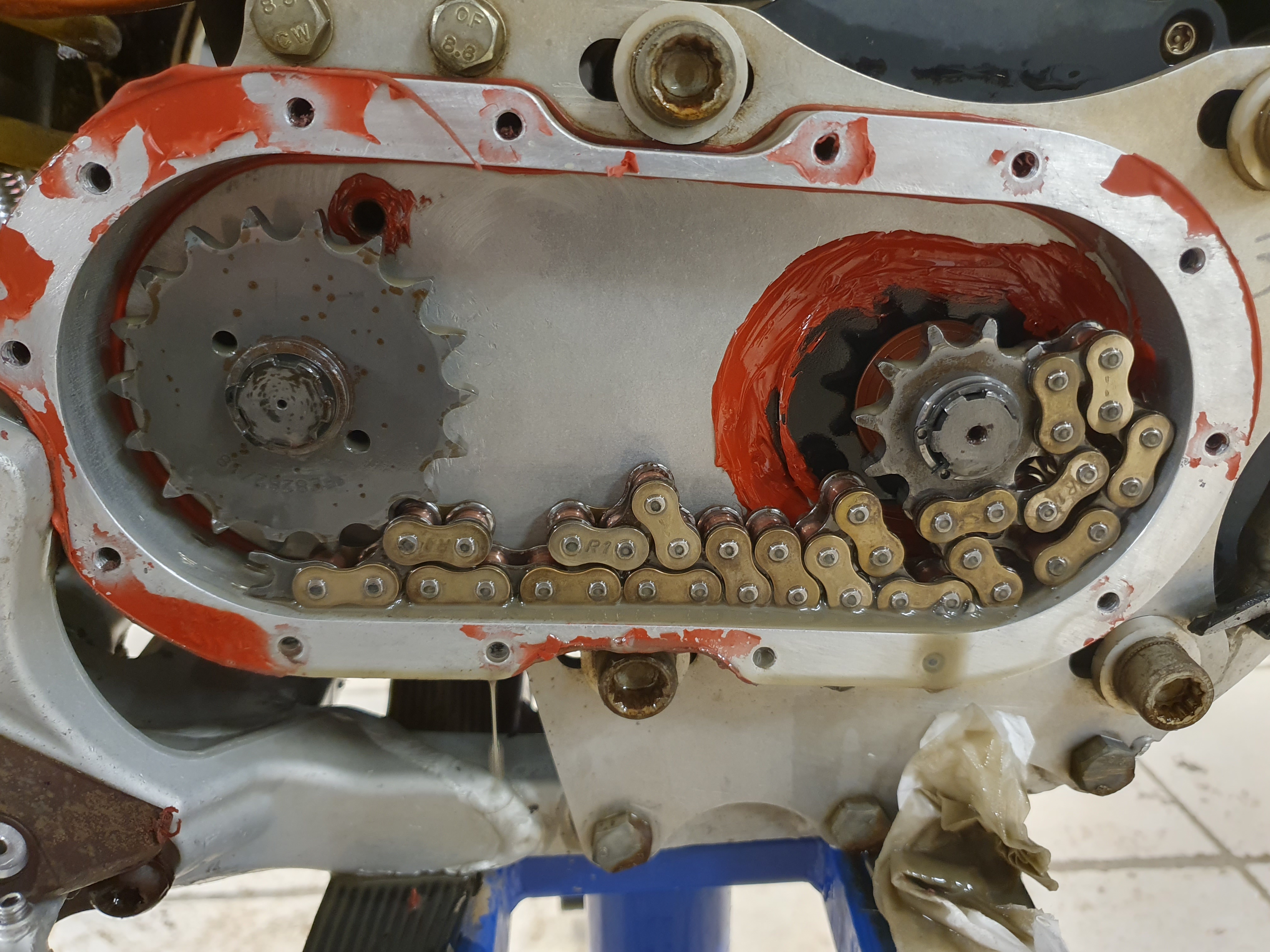

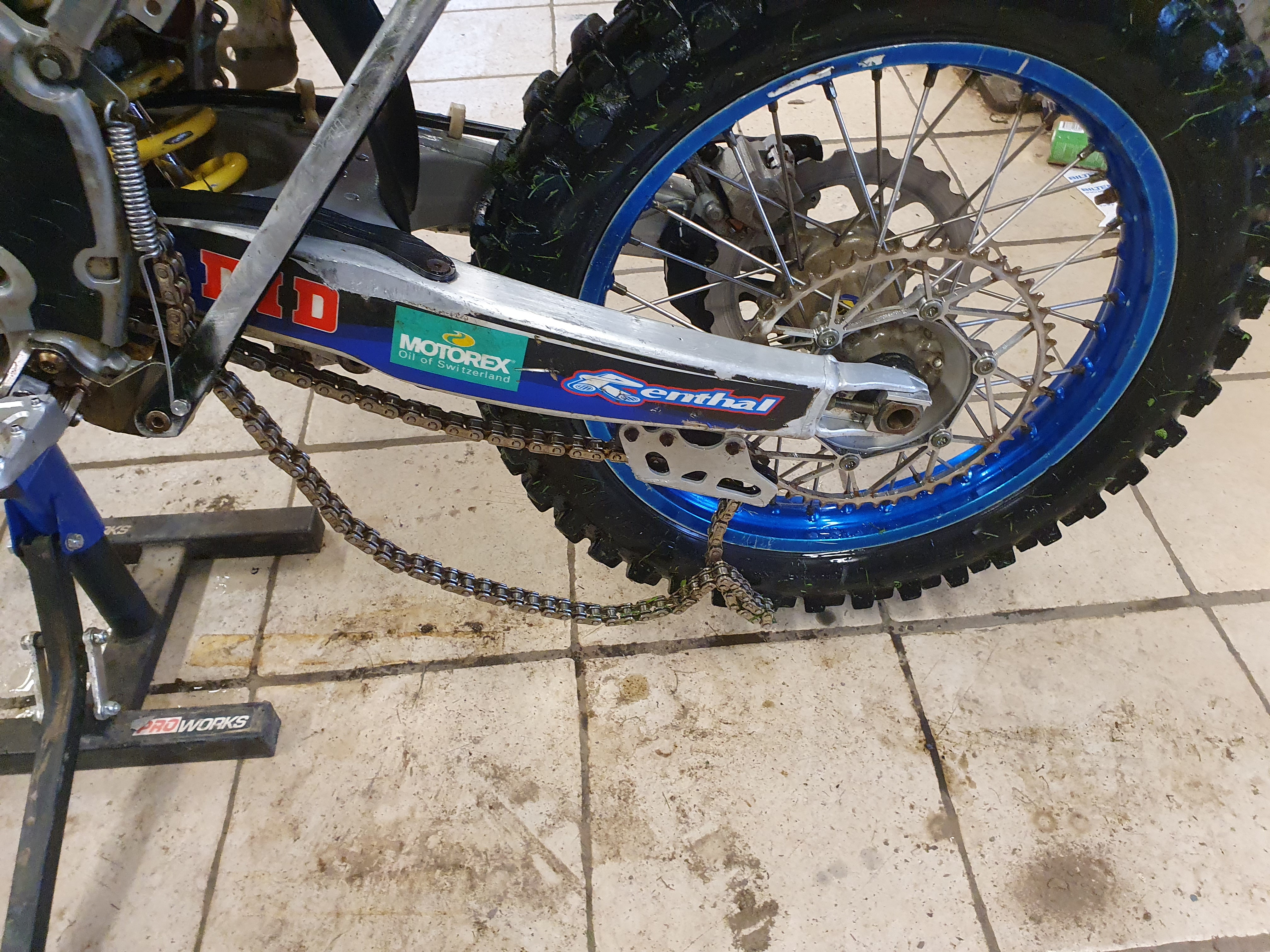

Opened it up and checked what happened:
The damn chain snapped right off..

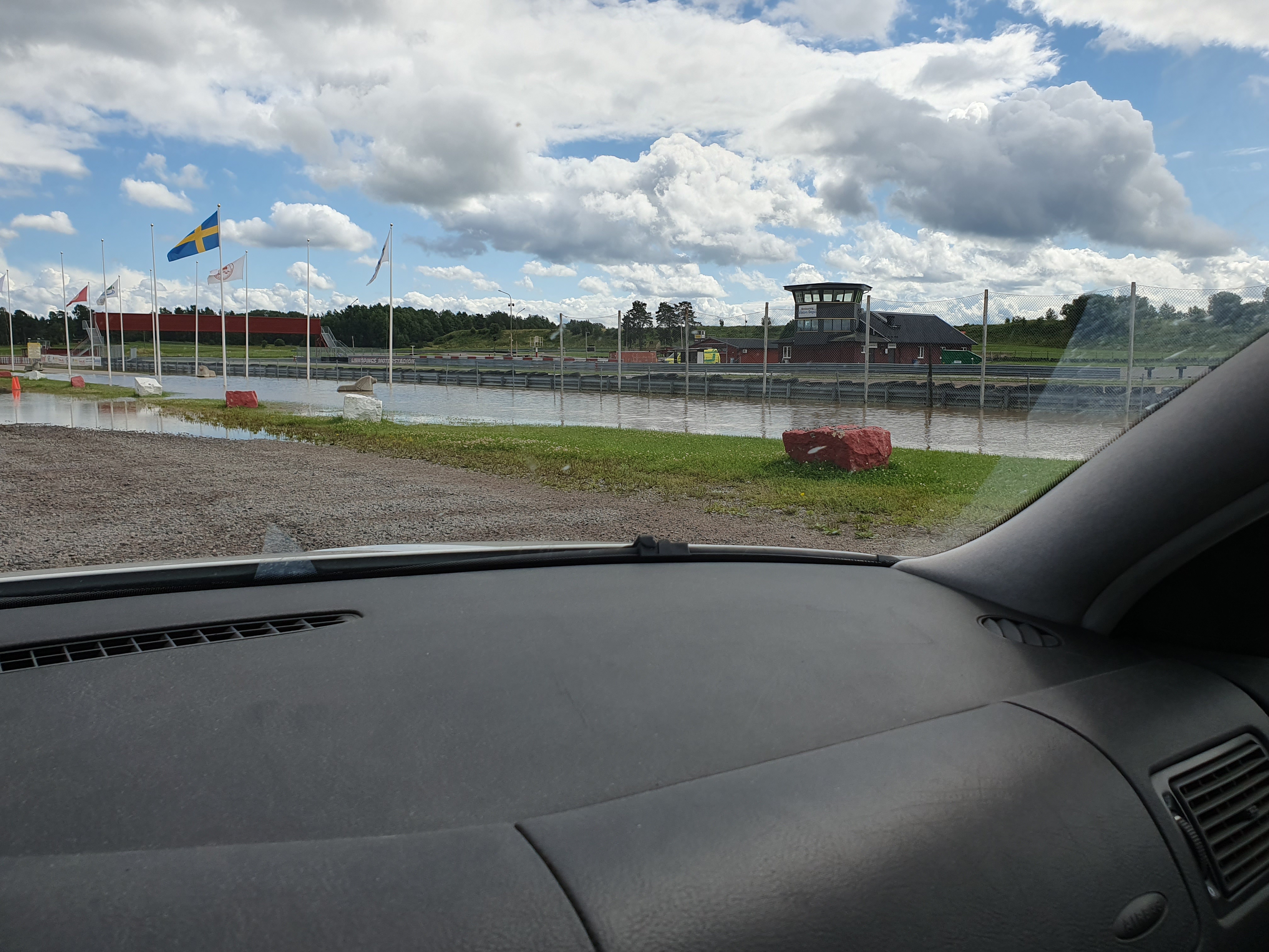

I saw that there was practice at a track nearby yesterday, and decided I wanted a revenge from the day before.
I fixed the chain issues, but didnt have time to look in to the electrical. Maybe it is not that wet anyway right?
The road is on the other side of the flagpoles, the lion statues are on the road..
The track was pretty much the same, not all of it was under water though.

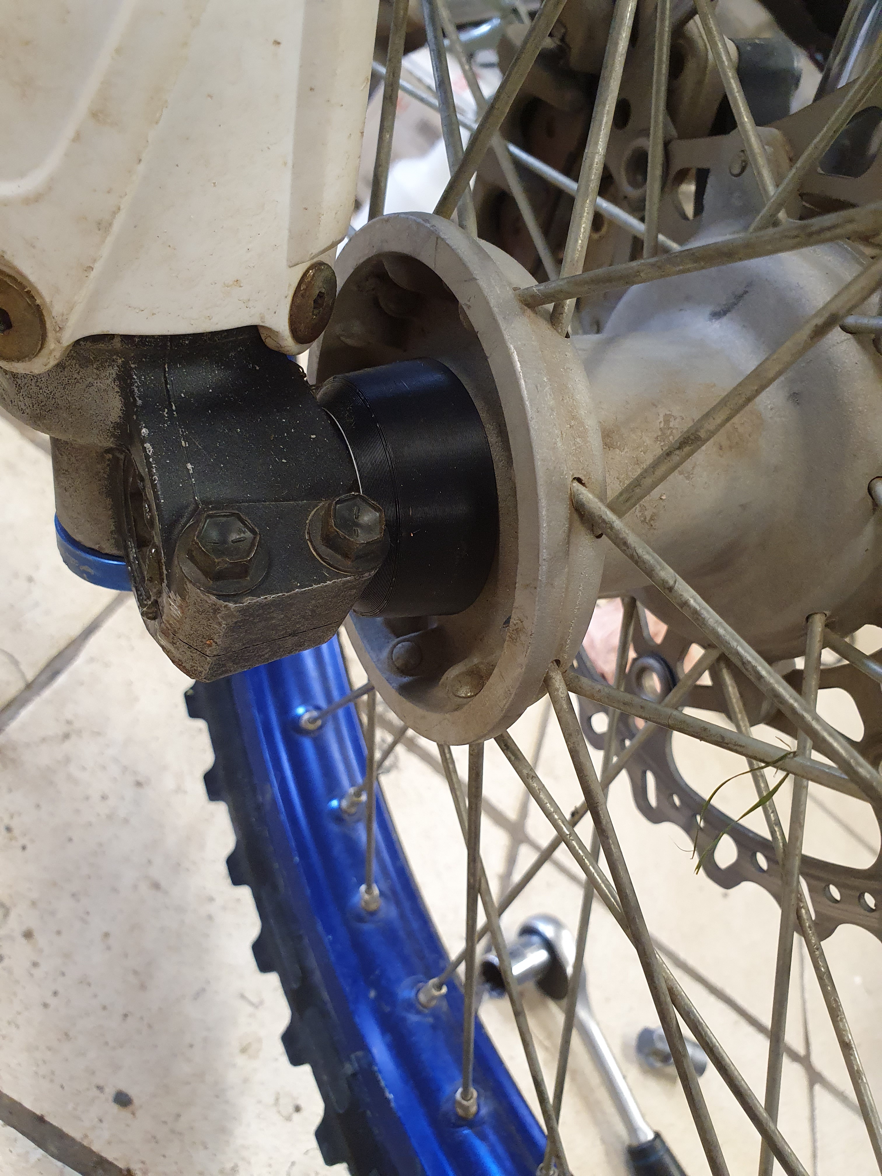

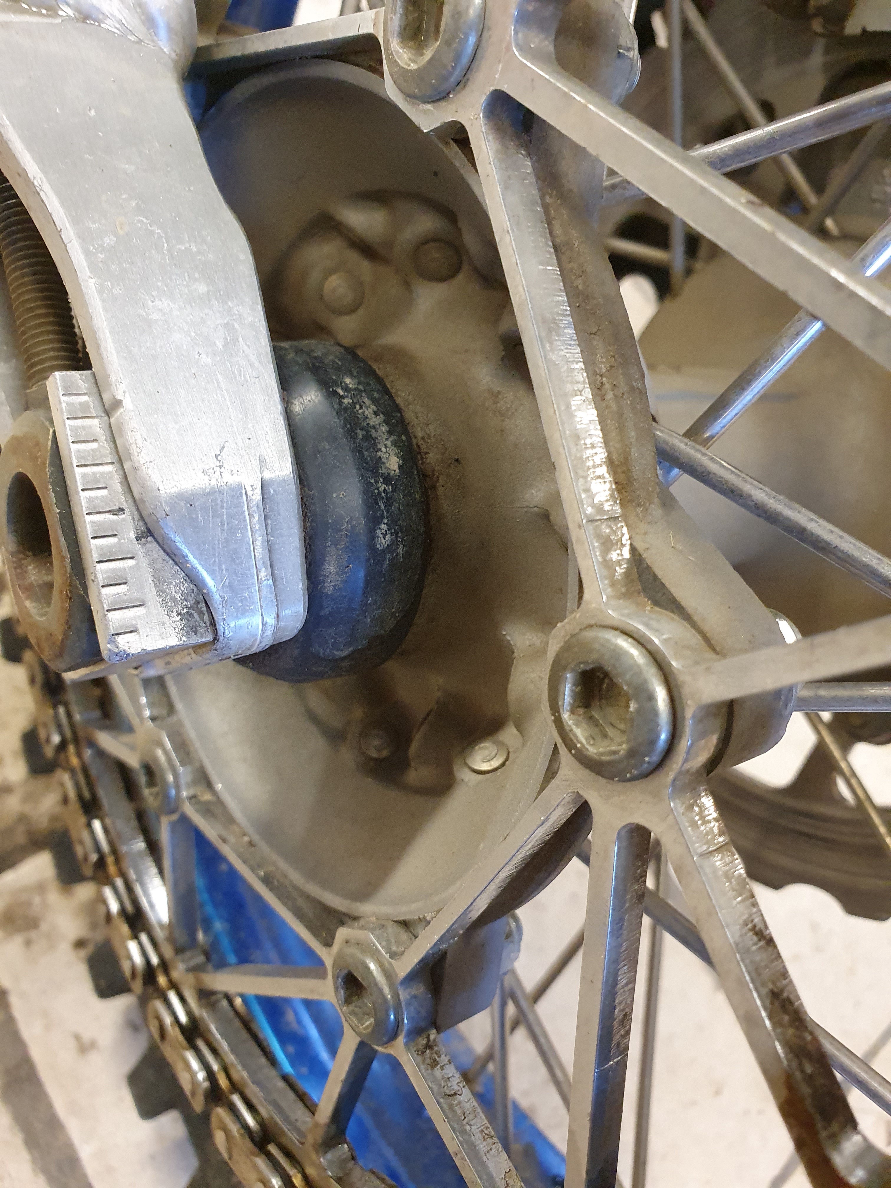

I changed front wheel and noticed the bearings are starting to go bad again.
I think I have changed them 3 times already, but never changed the rear wheel bearings.
They have these dustcaps:
I have thought about making something like it for the front wheel too, but have never gotten round to actually doing it.
Now it was finally time:
I will still have to change bearings one more time, but I hope it will be the last..

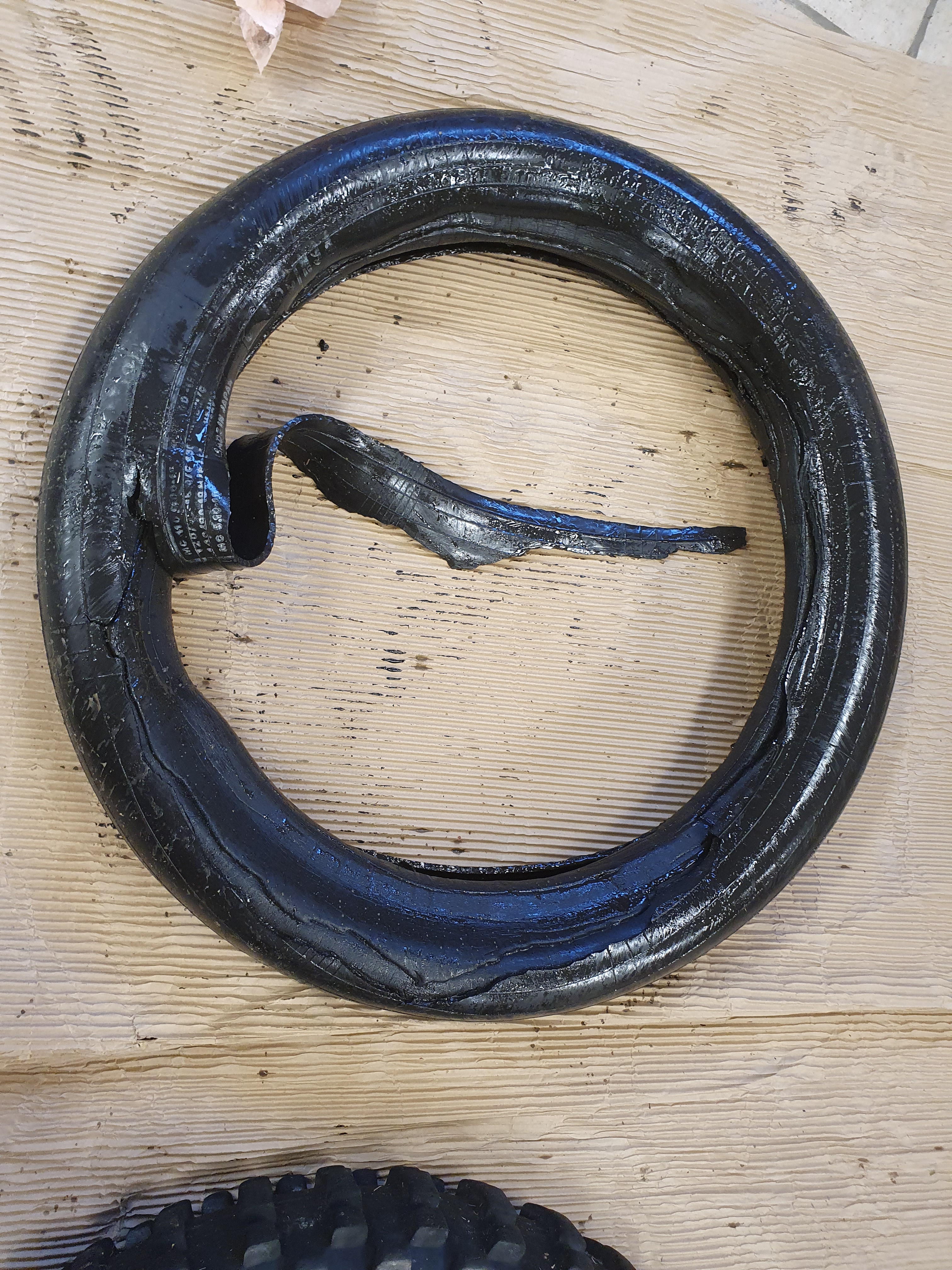

I have been running tubes in the practice wheels and saved the expensive mousses for race lately.
But now I think it was time for new mousses and tires, and get rid of my cut up tubes for extended life ;)
In the rear the tube was broken :oop:
Interesting to see how the mousse has shaped itself after the tube.

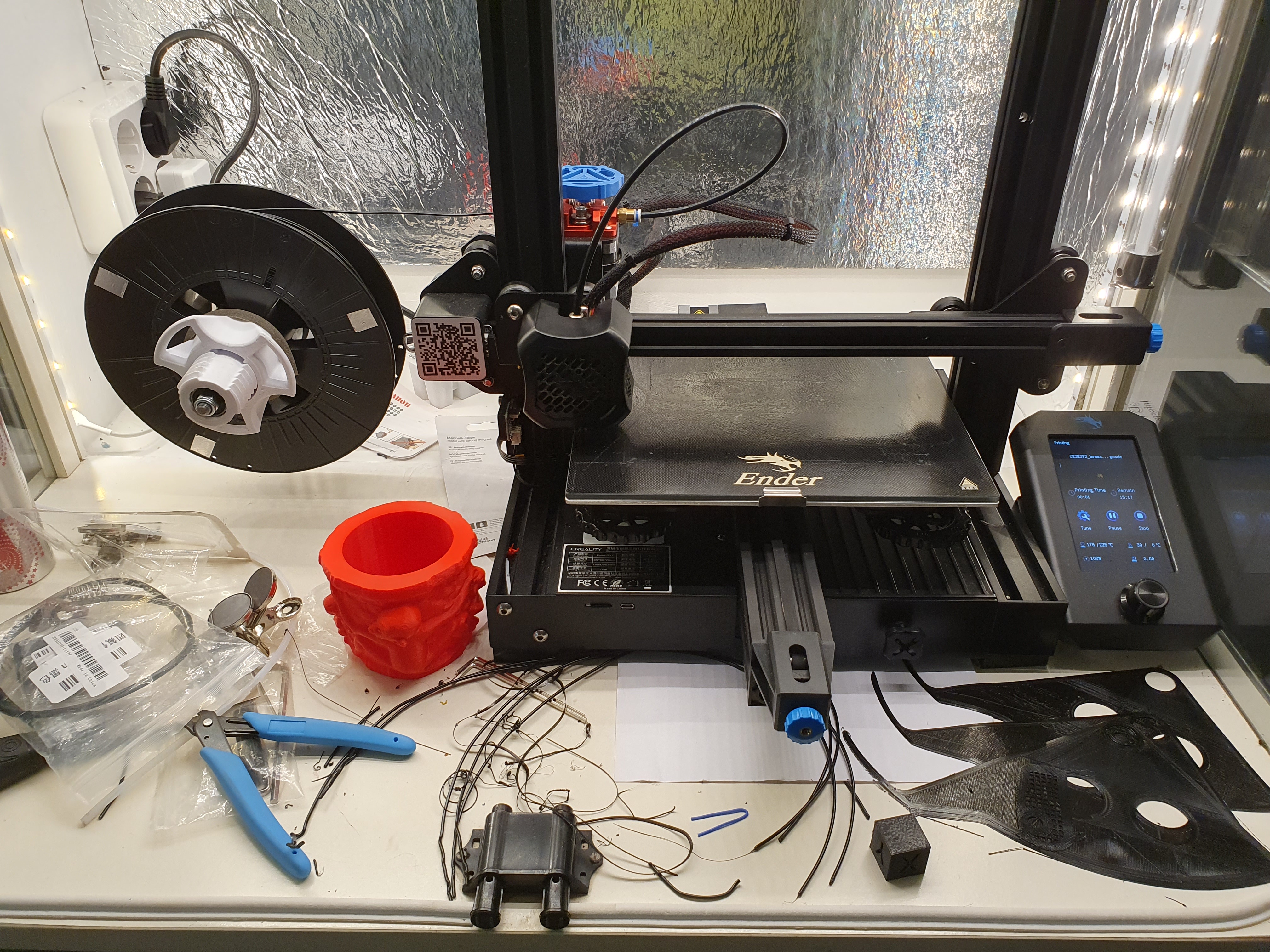

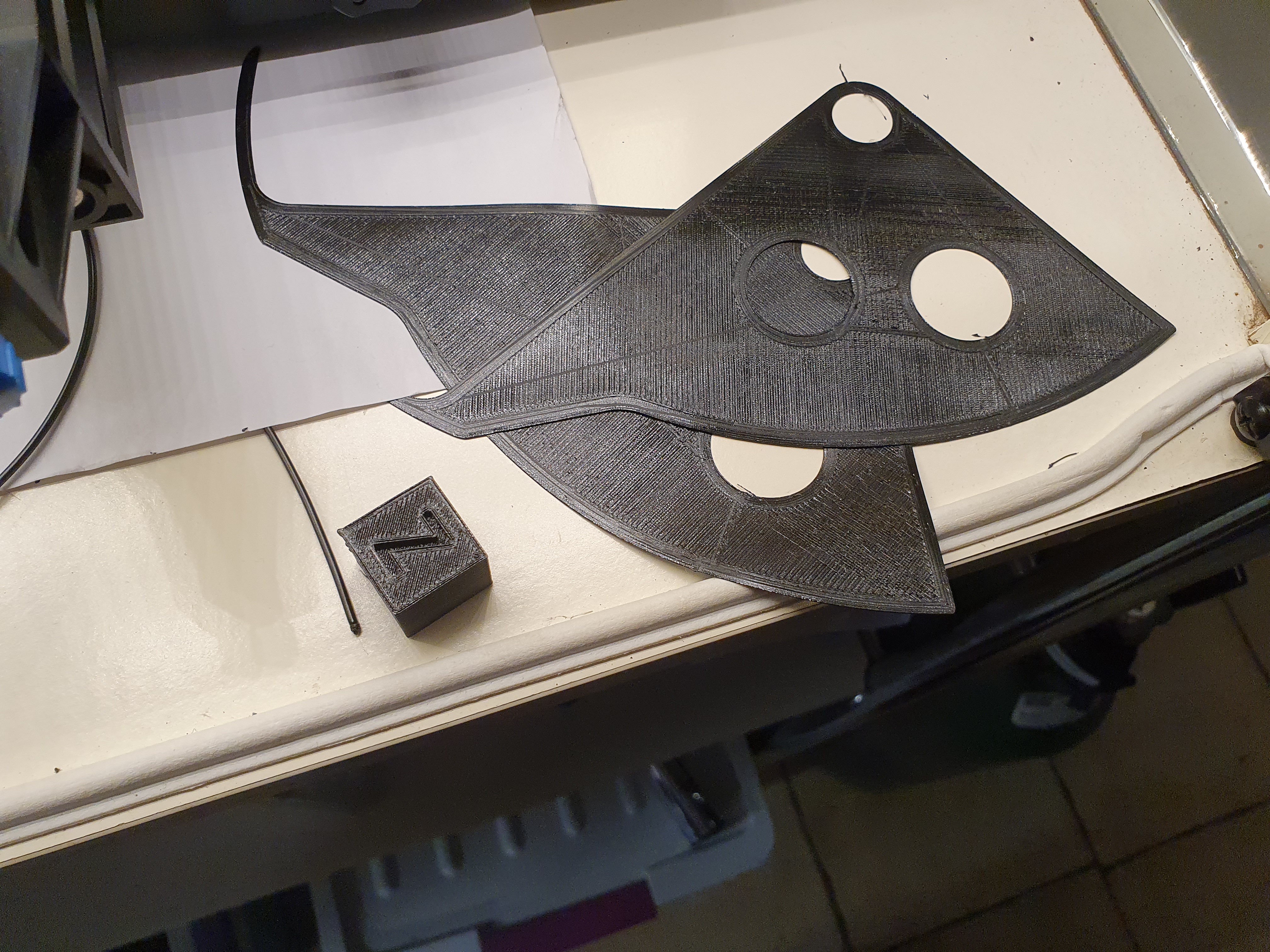

I did some research in the TPU matter. 95A seems to be the most common hardness, and also the stiffest of the more common ones. Therefore also the most likely to succeed on my ender 3 printer.
I got a rather expensive roll locally (the only one I could find locally), but I am having rather limited success.
I have been able to print a calibration cube rather successfully. It is relatively soft, but with a more plastic than rubbery surface.
But when I try to print my discguard it jams after about 2 layers.
I tried changing from 0.4mm to 0.6mm nozzle, but it didnt help.
Maybe I should get one or 2 other brands and see if they print easier?
From what I have seen on youtube it seems like they can vary pretty much even when they are supposed to be the same hardness.
What's your speed settings? If it's jamming after 2 layers, id decrease speed 10 percent and increase temp 5 degrees

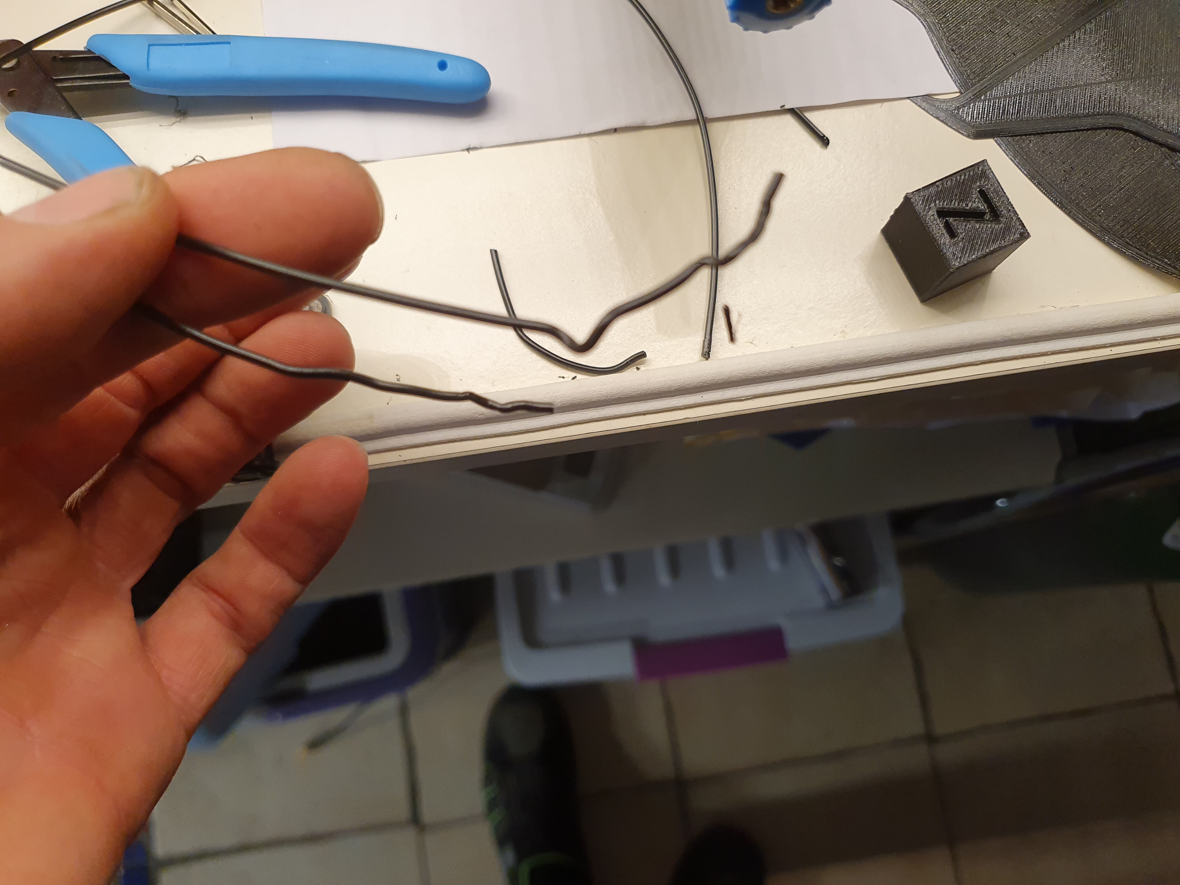

Probably the best tip I could give you about printing TPU is to simply just don't make the extruder gears tight at all.
What you want is the TPU to almost slip between the gears. This way if anything goes wrong is will simply slightly underextrude instead of getting definitely clogged. In this case not tight enough is better than too tight.
This simple trick solved 99% of the issues I had with this material.
A bigger nozzle diameter, slight increase in temperature and slower print speeds help as well. Also don't forget to disable the fan or at least lower its speed, and disable retractions until you find the most reliable settings. Also, usually the filament gets much stiffer when it is cold, so if you really have some terrible problems printing it you can find some way to cool it down before it enters the extruder. Last but not least, TPU is very hygroscopic so be careful how you store it because if you get water in it it will print terribly, with bubbling , horrible surface finish and weird results.
But yeah, start with just making sure the filament can slip between the gears in case of problem and you should be good to go.
Thanks for the tips, I dont think I can do much about the extruder.
It is a simple single gear and a roller type, with just a spring keeping tension on the roller.
I could find a different spring maybe, but there is no obvious adjustment of the tension.
I already went to 0,6mm nozzle, I suppose I can go bigger. But I think quality will suffer if I go bigger?

I have started a print again today, I did enable retraction again.. Maybe I should have left it off for now.
I had it off on the print before.
Keeping the filament cool, didnt think of that. I leave the doors open to the cabinet with the printer this time.
However, I thought I printed in 30mm/s but I probably had 50mm/s. I changed that and will see what happens.
I have 240degrees, I left it there for now.

Really?
That's weird, all the printers I worked with had at least some kind of adjustment mechanism.
Could you share a few pics of the extruder, maybe there is some hidden screw or something?
If there is no way from factory then I suggest either finding a new spring a bit of tubing or whatever, or using something to jam the mechanism so it can't apply its full force on the filament. Either way you need to find some kind of workaround to adjust the tension

Not necessarily, but who cares, it doesn't need to be beautiful, it's just a chain guard ;)
0.6mm should work just fine, I did some enormous TPU prints that took almost 24 hours with 0.4mm nozzles without any problem (I printed the seat for my red motorcycle this way)
