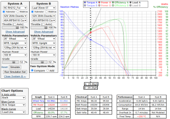

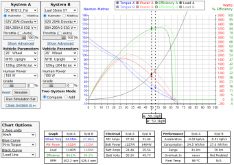

Here's an example of what i mean about the dimensions of the motors mattering.
When you start climbing something.. the efficiency situation on the leafbike 1.5k versus rh212 flips.. the slower motor is not only going a little faster, but producing less heat while it's at it..
And as you can see, from a stall the slower motor is making a bit more torque per amp instead of more heat.
.. that's why i say this would be the best motor for off roading or hill climbing. The watt rating on the RH212 is a little deceptive.

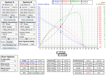

And the smaller the wheel, the better, if you have a 29er, i'd downgrade to a 27.5" rear, using a slightly bigger tire at most. Notice i used a 26"?
Here's that same test with a 29".. notice that we go from overheating in 6.7 minutes to 4 minutes..

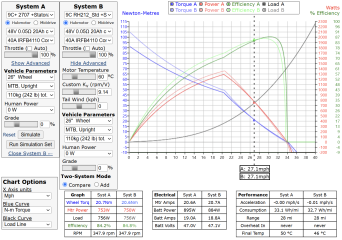

.Some of the motors modeled in the Grin Simulator have a few options. Stock motor, motor with Statorade, and motor with Statorade and hubsinks. Here's a standard wind 9C motor with and without Statorade, climbing a 6% grade. The motor without Statorade melts in 11 minutes, and the one with Statorade can just keep going, with a final temp of .>250C vs 123C. I don't like running over 100C, but the cooled motor should climb a long while before getting to 100C.
1749245528057.png11 minutes

Here's that same test with a 29".. notice that we go from overheating in 5.7 minutes to 4 minutes..
Hey dude, was the last graph supposed to have the 29” tire? I don’t see that option was chosen.
Fixed
