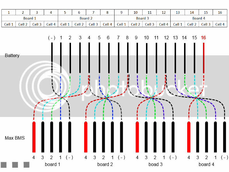

One question about this schematic.
All wiring going from the BMS boards go to the negative for cells 1 to 15, but the last wire on the battery cell 16 goes to the positive? Is this correct.
