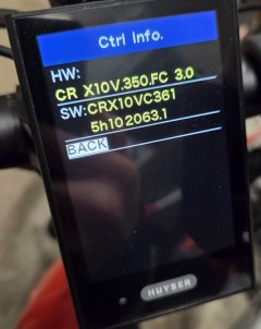

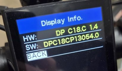

Please help me to restore the controller or bootloader firmware. I messed up and accidentally interrupted the firmware process. The display and Canable no longer show the SW and HW controller information. The firmware I am trying to install is specifically for my engine.
Now, using the old motor firmware method, it reaches 98% with a 20-second wait and a 99% error as shown in the photo.
At the same time, the DPC245 v3.0 display does not respond to pressing the power button when it is held, and it does not turn off at all. The error appears and disappears. I do not have a Besst tool. What advice can you give me and what should I do now?
Motor - Bafang M420.
Controller - CRX10V.350.FC 2.2

Is it possible you mixed the extracted one from your controller and the one i had send you? According to HxD the .bin you used (fw.bin) is a match with mine. So that is probably the wrong one for your controller.
A warning, if you do not have Besst tool or K1 flash i would not attempt to try to flash your extracted bin.
If you get error 30 like me IN the process of flashing, even Besst can not reach the controller anymore via the normal way..
And what should I do if I get error 30 because I interrupted the update process?
@Deko
1) What is the voltage of your motor?
2) Did you had a try with selector at "Motor controller" BEFORE you decided to use "old motor controller" or was "Old motor controller" your first pick ?
It should still work, just needs the correct update, that is if your motor can use one of the available procedures.. If an update fails and have error 30 then best is to switch off bike. Disconnect the battery for a few minutes and also close running program and remove canable and then try again.
I do not know if someone already tested M420 but there are at least 2 versions and i think in your case the "old motor controller" method is not for your motor version but i can be wrong of course because i still not have such M420 controller (i'm checking M410 at the moment). But from what i can see it looks like you need to select "Motor controller" to do your update.

Battery 48v. The firmware was previously set to 43v. It seems that the old motor controller was the first one, and then I tried all the methods. Did you also have no control information after an unsuccessful update attempt? Does your display also not respond to the power off button? Can you provide the exact procedure for flashing the "motor controller"?
Yes happens many times to me in testing that i have also error 30 and then it is normal, because of failed update, that you can not read information anymore because error 30 means no communication between controller and display. If your display does not respond to power off button, remove the battery for a minute.
Then put battery back in and for the display you now should be able to turn it on, of course error 30 will come again.
Now try if you can switch display "OFF" again. If you can now switch it off, leave it off.
Connect canable and go to firmw update tab. Select mode "Motor controller" and then select your correct bin file.
Click "start update" and then right after immediately press display button "ON" without releasing it HOLD it pressed down! No release in between! You now should see the % counting up, still hold on/off button pressed down till the log shows 100%.
The thing is, M420 is untested as far as i know but chances are it can work with the mode "Motor controller".

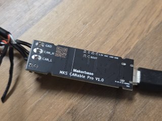

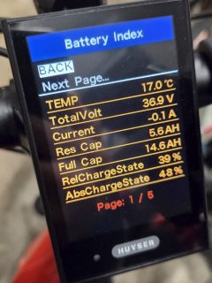

Hi everyone,
I messed up and accidentally connected orange and brown while hooking up and starting the canable pro with this software.
Of course the software did not give me any readings. After I disconnected my power button does not power off my ebike so I had to disconnect the battery (I disconnected the entire night just to be sure) Then sadly, I could not seem to power ON my ebike anymore.. I tried all sorts of things and luckilly I found a way: holding power AND the - buttons at the same time gave me a fully working ebike again..
The only problem is, I cannot seem to power off at all anymore and I have to remove my battery and use power & - buttons to power on EVERY time..
No error codes or warning codes are visible in the display.
After properly wiring my canbus setup I still cannot get any info in the software, at the end of my message is part of the latest LOG.
How much trouble am I in?? :eek:

After you messed up, according to your display it still can read the canbus data. So does bafang canable pro program recognizes your canable? Does it show the canable name? if it does and you click connect it should work... So check your wiring again. How did you actually made the wires connection?
Keep in mind that if you used an extension cable to tap in the canbus lines it needs to be one having the bafang colors and then you only tap in the green wire for can High and white wire for can Low.
Just curious, when you messed up, how exactly had you connected the brown and orange wires??
Today I went to my dealer and got a replacement screen under warranty (i just told them about my button problem and they never asked if I did anything, so I was not lying about the reason why it didn't work). They had a BESST tool and software and checked all sort of things. Updated the HMI (display) but to no avail. Eventually they tried a new display they had lying around and that solved my problems. I am so happy that the issue is solved that I am afraid of trying anything again 🥲
But to at least answer your questions:
The software does recognize my canable, (although it does say "(by bytewerk)" at the end of the adapter name). But I can click "connect" and "disconnect".
I just get no info through to the software.

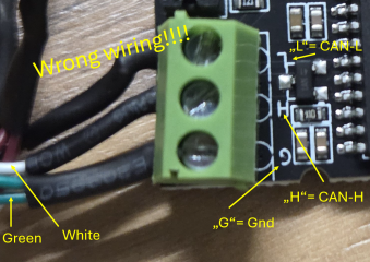

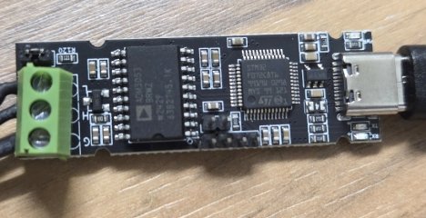

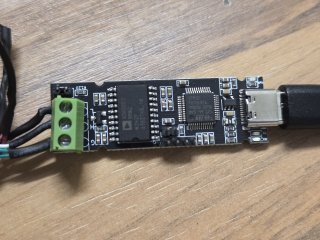

This is my wiring, top to bottom: black, white, green:
Or when upside down: green, white, black:
So totally wrong :eek:
You have connected
Green to Ground
White to CAN-H
Black to CAN-L
It has to be:
Green to CAN-H
White to CAN-L
Black to GND (is not necessary)

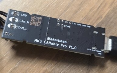

See the picture in the github repo. Different manufacturers use diffentet pinouts, so you have to read the imprint on the PCB carefully ;)
@ daft
yep your wiring is / was totally wrong.
It has to be like stancecoke mentioned:
Green wires to H
White wires to L
Black to G (is not necessary)
Then it should work.
