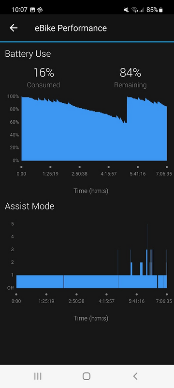

So after doing 4 full days riding, the only 2 big things I really wish to improve are the customize assist levels and have walk assist.
I also saw that M500 EBike battery SOC and M500 assist level are recorded on Garmin activity, meaning I can analyze the progress over the entire activity -- see here:
And here an example of one of the days where I charged at lunch time. I can now see when, how much battery SOC I used and how much was charged:
Note also the assist levels graph:
And here comparing the assist levels with the elevation - as seen, I always use the minimum level 1 and I usually increase only on hills to level 3 or 5, but never to level 9. Level 1 is to much for me and is a barrier for me to improve my fitness:
