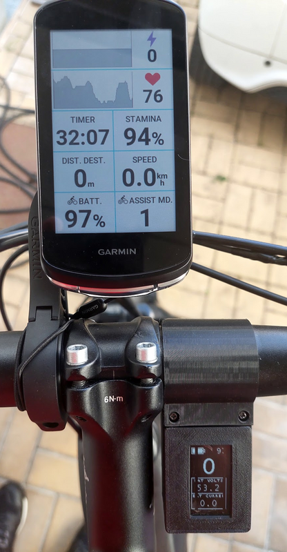

I did first test ride with the Garmin Rally XC200 power meter pedals + Garmin Edge 1040. On the EasyDIY display, I have the regular 3 buttons and I also have the 4th button specifically to change the Garmin Edge pages.
The EasyDIY display is very small, shows only motor data and is hard to see outdoors. But since this display is implementing ANT+LEV Ebike, I am seeing the motor assist level value and battery SOC directly on Garmin Edge, which is showing important data as seen on the image: my human pedal power; my heart rate; my stamina; etc. There are other pages that I am not showing, like the map navigation page, elevation graph page, etc.
The pedal power meter seems to work very well, no issue at all for being installed on an EBike. And I was also using my Garmin Fenix 7 watch, where I also paired the pedals power meter, meaning I was receiving and recording the same value both on my watch and on the GPS cycling computer. This is the advantage of ANT compared to Bluetooth.

Caisanho the set up you have is looking pretty cool now with the pedals and Garmin integration. Starting to think I may have to go down your LCD display route, well done though and it opens up so many possibilities.
There is a lot going on for me. On next 4 days, I will be riding about 100 kms and 1300 D+ each day. And I will be on a group of strong cyclists (I will be the only one with EBike).
As I am an obese diabetic and so I am on a Ketogenic diet where I almost do not eat carbs, so all this is hard for me as no one around me is doing the same, in fact, are doing the contrary: eating a lot of sugars / carbs while riding.
Recently I did a similar day and I bonked... about 1h30 before finishing, luckily I was using my EBike, because at that time I could not pedal harder or run, I could only walking slowly. So I used the motor at a good amount of assistance.
And I can see my blood glucose values in real time the Garmin, so I were able to see that I went slowly going down on glucose on the blood until I bonked. Interesting is that Garmin Stamina also went to near zero a bit before I bonked!! So my plan is to manage very well my energy output, for that I will keep a look at my power on the pedals and my target will be around 200 up to 250W. I will also keep a look at Garmin Stamina and adjust that my power output so I can finish the day ride.
Here the Stamina and my blood glucose when I bonked, at about 5h30 of riding:
So, I will need to also manage very well my motor power / battery range... that is why I need a very low assist level of 33% of current minimum assist level on my M500.
I have many data to keep an eye while riding, including the GPS navigation, but that guys are fast and will not stop, so I can not stop either. That is why is so important to have Garmin Edge page change implemented on the EasyDIY display remote 4th button, so I do not need to stop and use the touch screen every time I need to change the page to check the various data on the display pages -- and this is already working perfectly, the 4th button for Edge page change. And the most important thing about M500 for me to see is: battery SOC; current assist level, and that also works very well right now.
