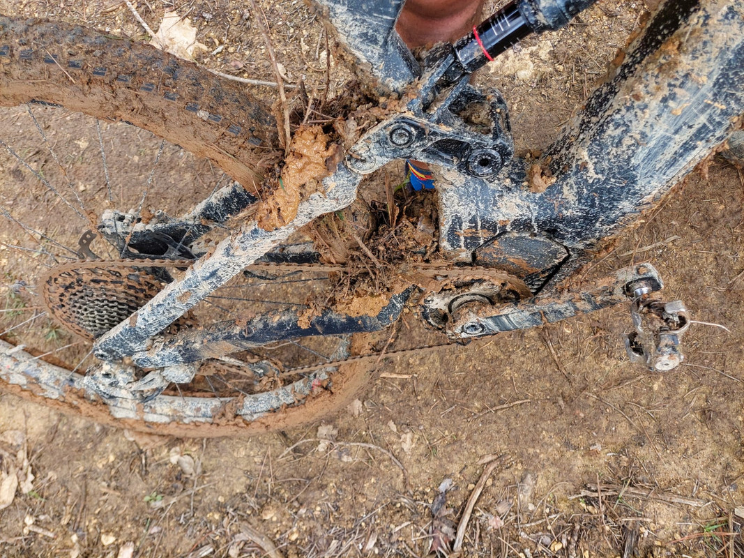

So, I am being riding my EBike, and here is a picture of a full day riding but with a lot of mud:
