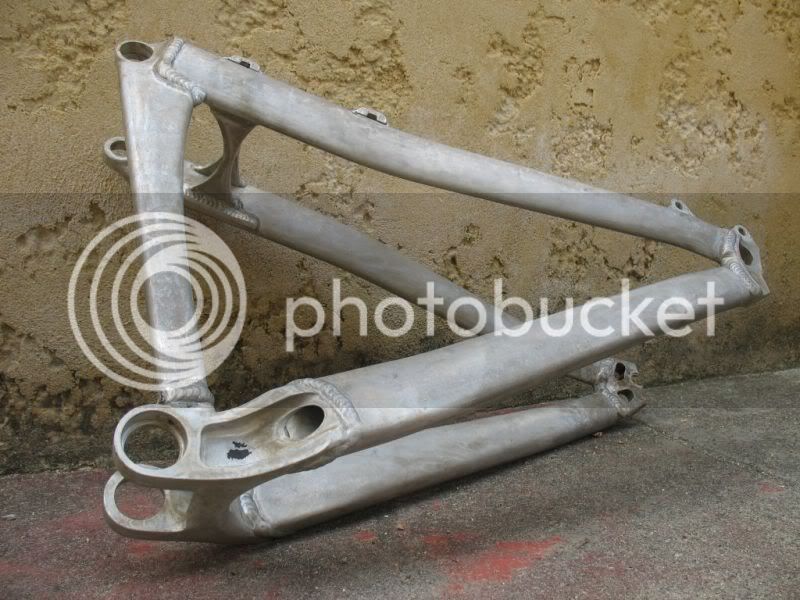

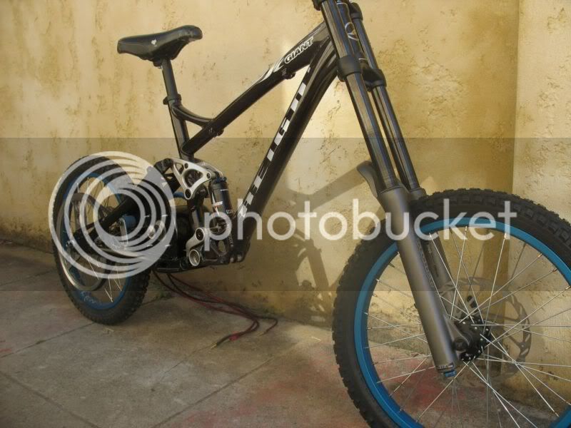

Just a quick photo showing the rear frame triangle after the acid tank, ready for welding.

Looks good Matt!! I didn't even think to tell you when i was speaking to you then, mate SnaPPeR

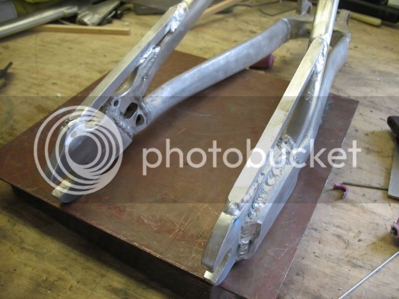

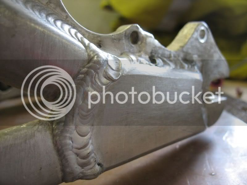

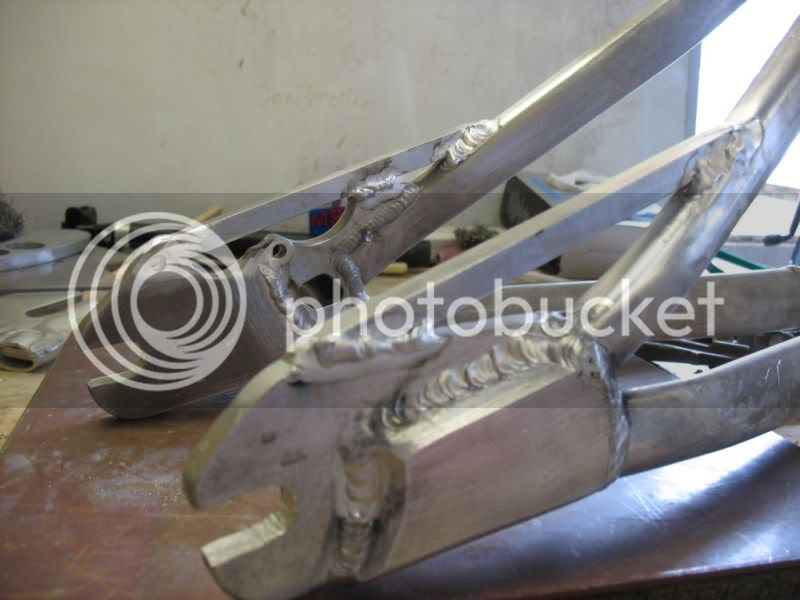

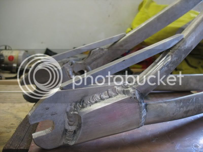

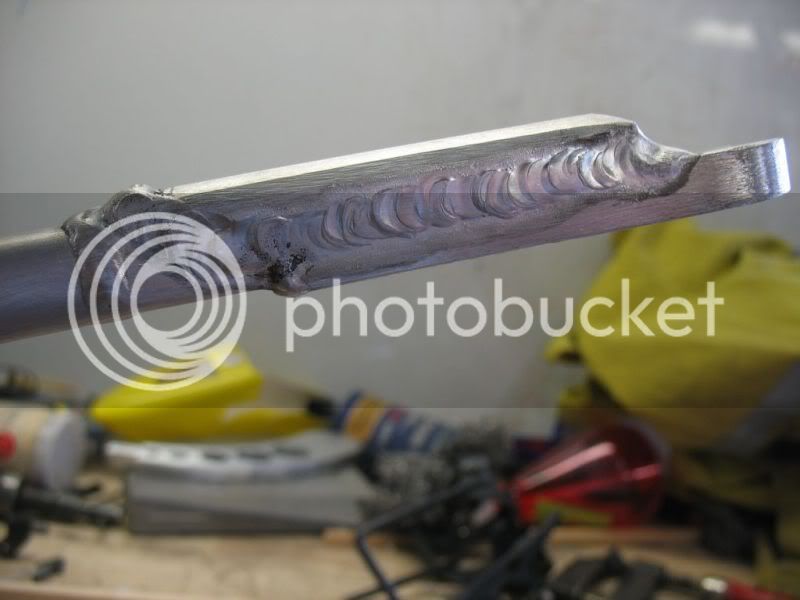

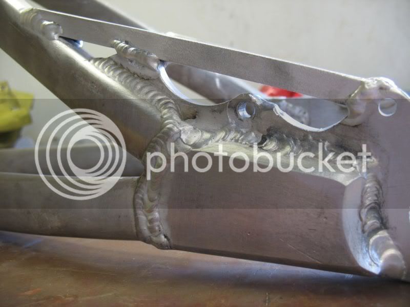

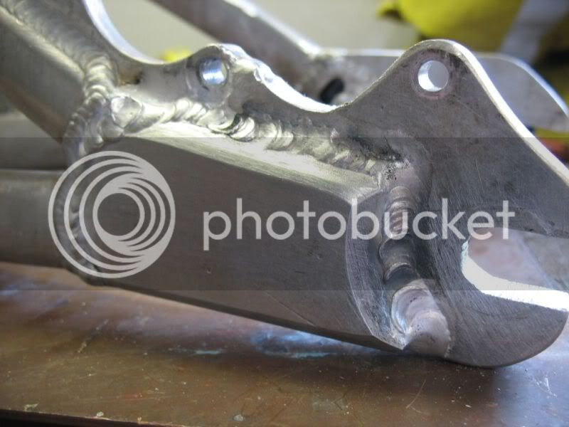

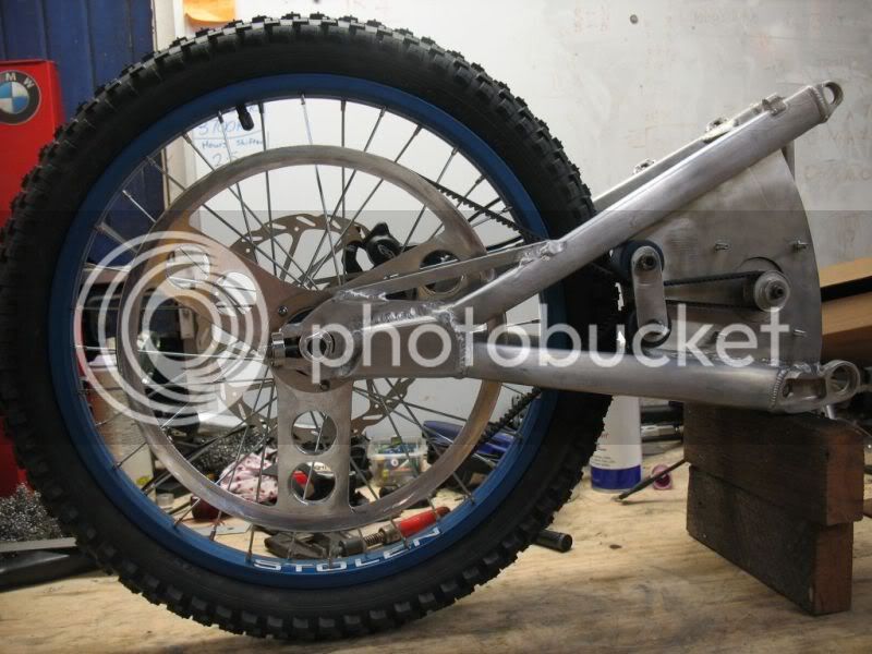

I have finally found some time to weld the extended dropouts on to the rear end. I added some 10mm x 10mm bar at the top to help brace it all together.
Simply beautiful Matt! You're welds are fantastic and that dropout is SOLID!

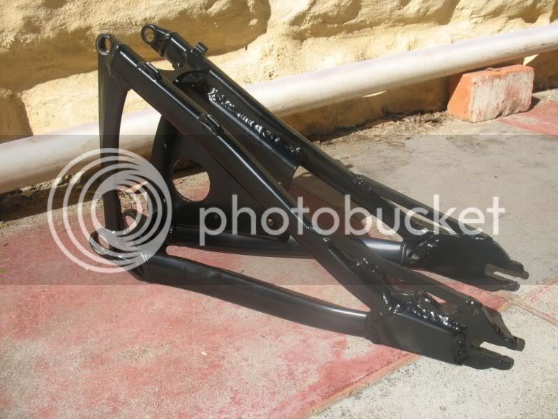

Just curious if your planing on doing any sort of heat treating on the frame now that you welded it? Doesn't it create uneven strength on the metal creating brittle and soft areas from the heat?

Excellent Matt, looks like there should be plenty of strength there.

I'm hoping that I have over engineered this set up enough because I'm not planning on any heat treatment.
Whats involved in heat treating aluminium after welding it?

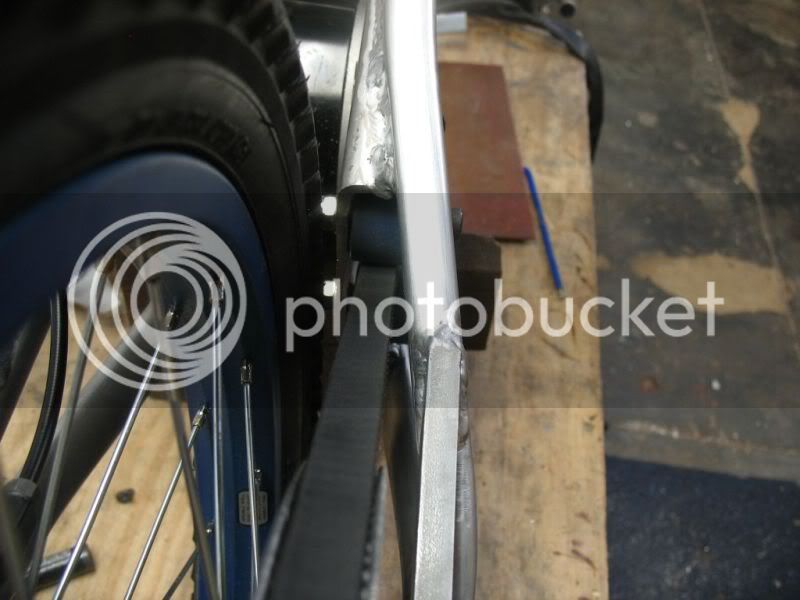

This photo shows why I needed an idler on the drive side of the belt to clear the frame.

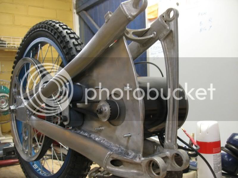

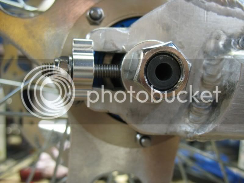

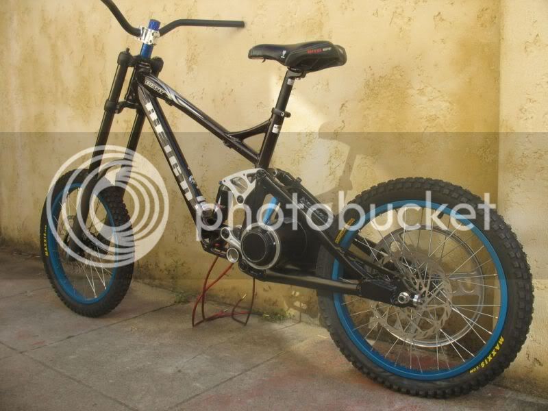

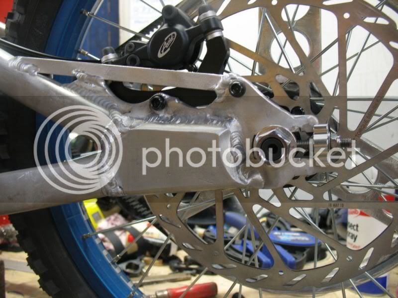

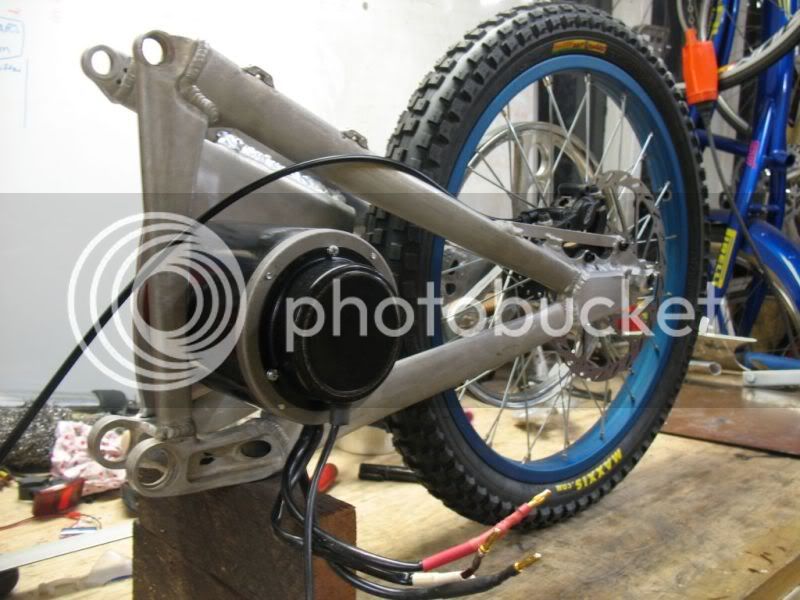

Ok, I have the rear end pretty much done now. The motor mount is in and the belt drive runs true and smooth.

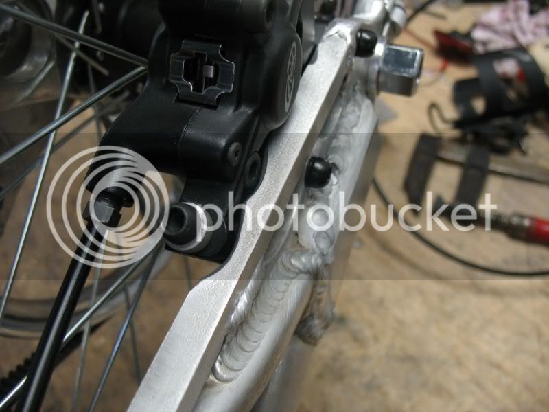

I had to weld some small tabs on to the drop outs so I could use these nice tensioners that were kindly donated by Aussiejester.
Some minor interference with the brake caliper.
I made a plate to help brace the idlers.
Some general photos.
Looks good! You can normalize the part in your oven at home if you wanted to. I'm no expert here but around 500degrees will realign the grain structure. I've heard of people using the oven clean setting to get their parts up to the required 750+ degree F it takes to get back to T6.

I can attest too the oven to re-harden 6061 aluminum when I did the front bumper for my custom 1/5 short coarse E-Maxx (my "SC-Maxx"). After annealing at 1000f+ so I could do the bending, it was very soft and very easy to bend, I think softer than 3031. To re-harden it I think I shot for about 375f for 7 hours in the oven. Doing this brought it back to I'd guess about 80% of it's original hardness.

I guess AJ won't let you get away without a few more lightening holes in the motor mounting plate. :) That cyclone motor isn't small at all is it? Looking sweet anyway dude.
Simon.

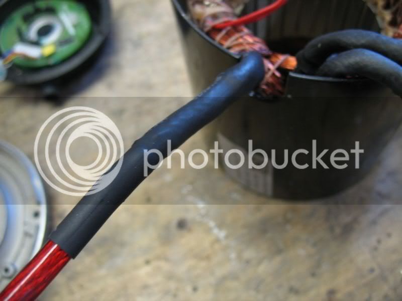

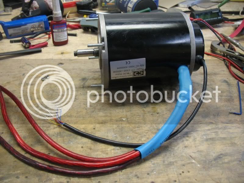

Nice to see the extra effort for efficiency Matt! 8)
I wonder what can be done for ventalation of that motor?
You could certainly get a higher continuous duty rating if you could get some air exchange over those coils.
Jay
Nice and tidy! Looks better than I thought it would, I wonder if putting a longer shock on would not disturb the handling too much and allow for better peg clearance by jacking up the rear a bit. I pray for your swingarm survival, those little loops for the bottom pivot scare me the most. Is it possible to reinforce them with just a plate cutout and welded around the profile?
I was thinking the same thing, however I think I will leave it as is and see how it all goes.
How come the loops worry you? They are unmodified.

If putting this rear end in the oven on high for 7 hours will help strengthen it up, I will do it.
I need to find more info on normalising Aluxx SL aluminium. I found this in a search "AluxX SL starts with a 6061 alloy but mixes in a trace amount of copper to form a stiffer alloy"

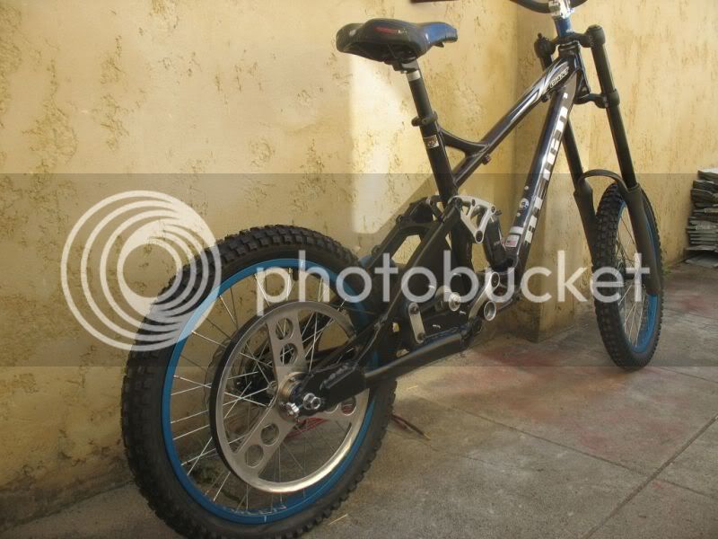

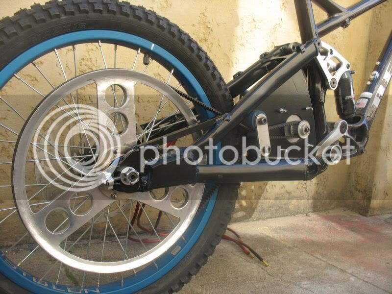

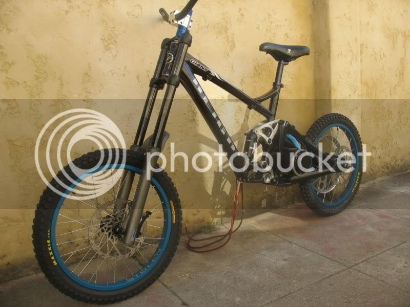

Ok this has been on the back burner for quite a while.
I just got the rear triangle back from the powder coaters, done in satin black.
I have done a quick assembly to see how it will look. The next stage is to mount the battery and controller and make a cover for them out of lexan.
