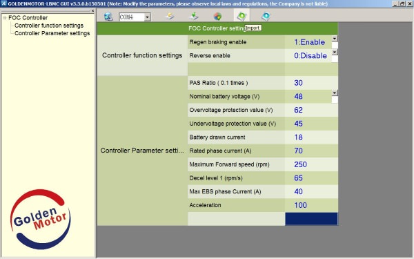

52 nominal volt (max charge of 58.8 volts), 11.5 ah, bottle type case, Li-Ion batteries.
Bullfrog said:
B. What maximum battery amperage to you run to the controller?

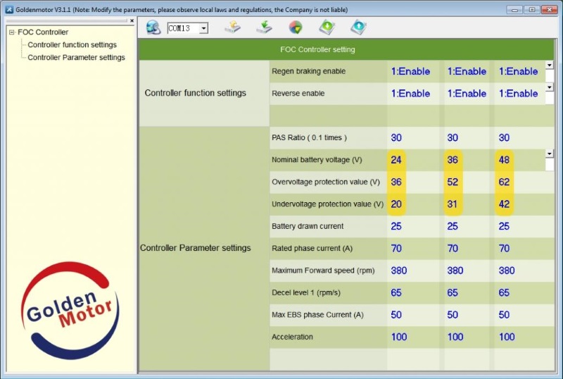

As mentioned previously, my set-up has been de-rated to provide 20 mph at WOT and 750 maximum wattage. (1 H.P.)
I achieve this by setting maximum Battery Drawn Current to 18 amps. And Maximum Forward Speed to 250 RPM.
I believe that the controller standard setting is 25 amps.
This is a composite screen shot with all three voltage settings displayed at once set side by side for comparison.
(provided by Bikemad)
This is a shot of my present settings... (full disclosure, I did have to reduce my regeneration current to 30 IE: less braking force)
Bullfrog said:
C, What maximum phase amperage does your controller send to the motor?
I believe it to be 70 amps as per the factory setpoint settings as seen above. (never changed)
