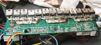

So after blowing out my 72V 35A controller I tried to fix it.
First I replaced the FETs. No good. One phase is still 'stuck.'
So I took it apart again, instrumented it and tried a few things. Removing all the FETs from the bad phase resulted in a motor that would sorta spin (with some help starting) and I was able to capture some plots. (Three phase motors can often be made to spin with one phase not working, as long as you help it start.)
I looked at all the signals going to the "bad" FETs and found one bad gate resistor. Replaced that, added yet more FETs, and tried it again. Still nothing! I tried spinning the motor by hand, and it started up. Experimented with it a while and it works fine once moving - but won't start from a stop.
So it looks like I've created a "pedal first" controller from an "instant start" controller. Wonder how I did that?
Before I reassemble it I want to get some shoulder washers so I don't have to deal with these cheezy shrink-tube-insulated screws. With my luck it will wear through and blow out again.
Edited to add- by the way, my controller had no FET drivers, just a triple 3-input AND gate that did the throttle signal gating and drove the FETs directly. Odd.

Cool scope displays.
Is that a Crystalyte controller?
Does it have a C1246 commutator?
If one phase is not working, the motor will not start on its own from some positions. It may start from other positions. You can attempt repositioning the wheel many times and see if it will start.
In your case, the signals appear to look OK, so I'm not sure why it wouldn't start on its own.
If you look at the high side gates, you'll typically see one of them get the PWM signal when you apply the throttle. The PWM usually drops out after a couple of seconds if the hall inputs don't change. This is a locked-rotor protection of some sort.
If you spin the motor backward with the controller on (no throttle), you should feel a steady resistance. If one phase is out, you will feel a pronounced cogging.
With the motor attached, the BEMF from the motor might give a signal even where one of the phases isn't firing. You could disconnect the phase wires from the motor, but keep the halls connected. Give some throttle, spin the wheel, and scope the phase wires from the controller to make sure they're all switching properly.
Label - "Crystalyte 36-72V 35A immediate start"
Yes, and the 3525. But no FET drivers. Odd.
After further experimenting, I discovered that it wants to see a zero throttle signal before starting. I'm using an adjustable pot, and when it's set to about midrange it won't start until I back it off and ramp it back up.

i have never seen a crystalyte controller with no ir2101 drivers, but i heard they were coming out with a new design, and you never know what pcb the chinese will stick into the same box. from your symptoms, i would suspect what i call the "watchdog" circuit, which keeps the pwm from working if there is no switching on one of the output channels.
look at pin 10 of the 3525, and if it is being driven above 1.6v that will shut down the 3525. this is done with an op amp driven by the right hand channel on the controllers i have seen. when you first power up the signal should be high, and it should go low when you move the throttle. if it dies right away there may be a problem with this circuit.
can you post a picture of the controller pcb?
Sure, although there are so many extra wires going to this thing it's hard to see:

The 2101's are hiding under the capacitors. See pic.
