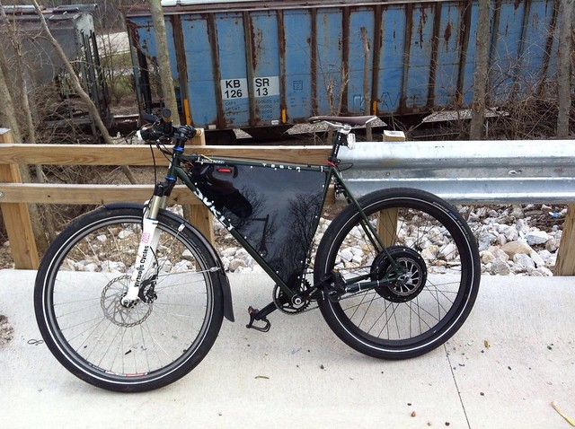

I'm in the process of redoing the panels. One more to go. I plan on trimming off all excess aluminum. I'm pleased with the appearance. I hope you like it to. The reduction of the panels will make it look more like a normal bike (with tubes present). I am looking into printing off fake water bottle cages and water bottles for an effect ;).
I decided to route the phase wires through the bottom of the enclosure so that precipitation cannot dribble into the controller from above. This will also make sealing the top corner of the enclosure much easier.
I'm exploring adding some removable, screened scoops that throw air at the controller in hot, dry weather. These can also function as ports for accessing programing cable and checking get temperatures without having to take all 20 screws out.
I will upload a video soon of it in action. CAn't wait for cromotor. This 9C is going to burn up (and I'm glad it is). If I don't like the performance with this 12 FET and the cromotor, I will try to make a heat pipe or something that pops out of the enclosure so I can run it at 60-80A at 66V. 140A phase. :)

Currently I am doing finishing touches on the revised edition of my triangle enclosure. Per recommendation and from my existing interest in trying to paint behind the clear polycarbonate, I tried it on one side with matte black. It looks phenomenal. I will leave the other side clear temporarily for trouble shooting and testing. I also screwed it up when I milled it out so I'll be making another set probably for $25.
I will post pictures this weekend after I have it all done. I still will have a lot of work to do closing up the top portions from precipitation (which I won't address for some time cause I want it to WORK!)

It's beginning to look more sexy... But still lots of work to do to make it torrent proof. Took the 9c out today with shitty 2.5:1 pedaling ratio.. I need to make revision to my 11T freewheel adapter.. It I'll be getting a cromotorxo that won't even fit so I might forget about that modification. 9C gets vey gummy especially after stopping for a minute, cessating the air cooling. I don't know if I will paint the other side for some time because I want to be able to see any problems. A lot of wiring and a lot of cable management! Takes a lot of energy and strategy to fit all this in a 2" space. I'm already thinking about higher energy density cells and I haven't even put 30 cycles on this pack.. New cut off is 60V.. And cells were in 2.8-3V range pin lvc. So good.
I think for the next panels I'll do some sort of color scheme that matches the bike more.
Bike charges in 40-50min with dual hyperions at max output. I have to make sure though that the precharge switch at mid pack is off before I connect the leads. Does anyone know the best way to protect the chargers in the event the switch is accidentally turned on in net mode?

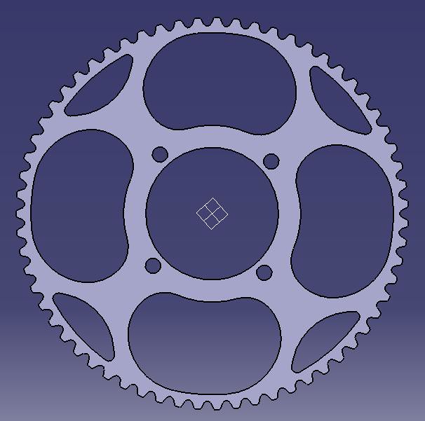

I just may make a 63 tooth chainring so I can pedal at ~90rpm at 30mph. It would cost me about $40 to make it from .125" 7075 T6. I am doing away with the 11T freewheel coupler because the cromotor will not have any space. I wish I knew more MEs so they could critique my design. I'm sure I'll end up beefing it up more.
That chainring will be pretty intense. I've got a 52 tooth and think that's great. Great looking build. Well done
