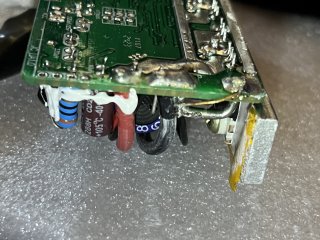

With help from @fechter from this thread, I did the shunt mod on the controller on my iScooter i12. I am starting this thread so I don'tt further hijack @casainho 's thread.

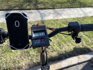

The shunt mod made hill climbing acceptable. Before that it would bog down to 5 mph or less on hills. I hooked up a thermocouple to the controller and took it for a 9 mile ride in local park yesterday. On 8% grades, the hottest temp seen was 110F (not that hot). Battery amps went from 15A before, to 22A after the mod. Maybe I can increase power a bit more? I'll ride it more before deciding.

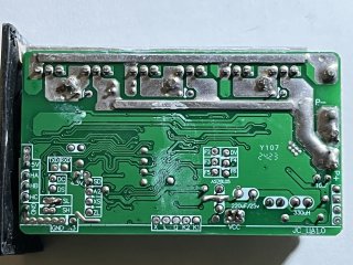

It'd be even more fun if I can defeat the 15.5 mph speed limiter! Here are photos of the board. Which wire/ signal do you think is the speed limiter? I did disconnect the single wire connector with the yel/gn wire (signal A3) but it didn't do anything.
The real area of interest is on the top side buried under the hall sensor wires.
I have not seen this particular board before, but many others have a 3-speed switch function with connections labeled SL and SH.
I see these on the board (but they may be something completely different).
See if the SL pad has anything connected to it. If SL is grounded on the other ones I've seen, it puts it into low speed mode. If SH is grounded, high speed. If neither of them is grounded, speed 2.
You can also measure with an ohmmeter from B- to the SL pad and see if it looks grounded. If so, see if you can unground it.

Does the white wire go to the SL pad?
If so, you might try moving to the SH pad and try grounding it and see if the top speed changes.
There are 2 white wires on the SL pad (no wires on SH pad). One goes to a multi pin connector that goes up to the handle bar. The other to a multi pin connector that goes to the motor. I’ll do more measurements/ tracinglater.
I would try disconnecting both of them first and see if it makes any change. You could also measure the voltage on the SL pad with them disconnected. This may have nothing to do with the speed, but it's my best guess. Typical speed switch connections would have around 5v with nothing connected.
With both white wires disconnected from SL pad, rear wheel does not spin. Connected white wires, wheel spins.
There is 5V on SL pad with white wires disconnected or connected, does not matter.
No voltage on SH pad.
What do you suggest I try next? Standing by.
Seems like it might be the “self-learning “ function. It was worth a try.
Does the main chip have a number you can read?
Randomly putting 5v or ground on other pads might blow something up.
What does the A3 wire go to?
A3 wire goes into the motor harness via a single wire connector, along with the 3 phase wires and a 5 wire connector (3 hall sensor wires, +5 and gnd ?).
A3 wire has 1.78V with power on, 11k ohms power off.
Yeah don't want to ground anything with 5V randomly. I'm willing to ground anything through a 10 ohm resistor though if that's useful. I have a spare controller. Ok if I blow one of them.
@fechter Dug out my old Tektronix scope, soldered a wire onto SL pad to probe it. The 2 white wires on SL are the brake cutouts! When I pull either brake levers, 5V on SL goes to Gnd.
Anything else you want me to try? Thanks for the help!
edit: What are the other signals on the board that we haven't looked at?
I searched around in the forum and found some other controllers where the 3-speed switch was wired to the pads marked K1 and K2. You could try grounding K2 and see if that does anything. The functions of the pads depend on the firmware and there doesn't seem to be any real standard. Even if K2 is for a speed switch, it may do nothing if the settings for all 3 speeds are programmed the same.
Grounding K2 or K1 didn't make any difference.
I moved the shunt to give it more power and went for a ride and to my surprise, max amps dropped from 22 to 18.
I didn't touch where the shunt was soldered on the PC board, just unsoldered where it was soldered on the shunt and moved it a little further away. Is that wrong?
It should have gone up. Maybe a not-so-good solder connection on the end.
I re-soldered the 1mm copper wire by bridging the shunt on the solder side of the PC board. Will test ride this afternoon.
With full throttle, re-soldered shunt peaks at 30A for a split second then quickly drop to 22A. Thermocouple on the controller casing never got past 88F. The previous shunt, highest was 110F. Difference may be the cover on controller housing was off today. After the 10 mile ride, motor was warm, not hot to the touch.

65F outside, 5 mile ride to the grocery. With controller cover on, climbing some 8% grades, highest temp observed on the thermocouple meter was 125F.
