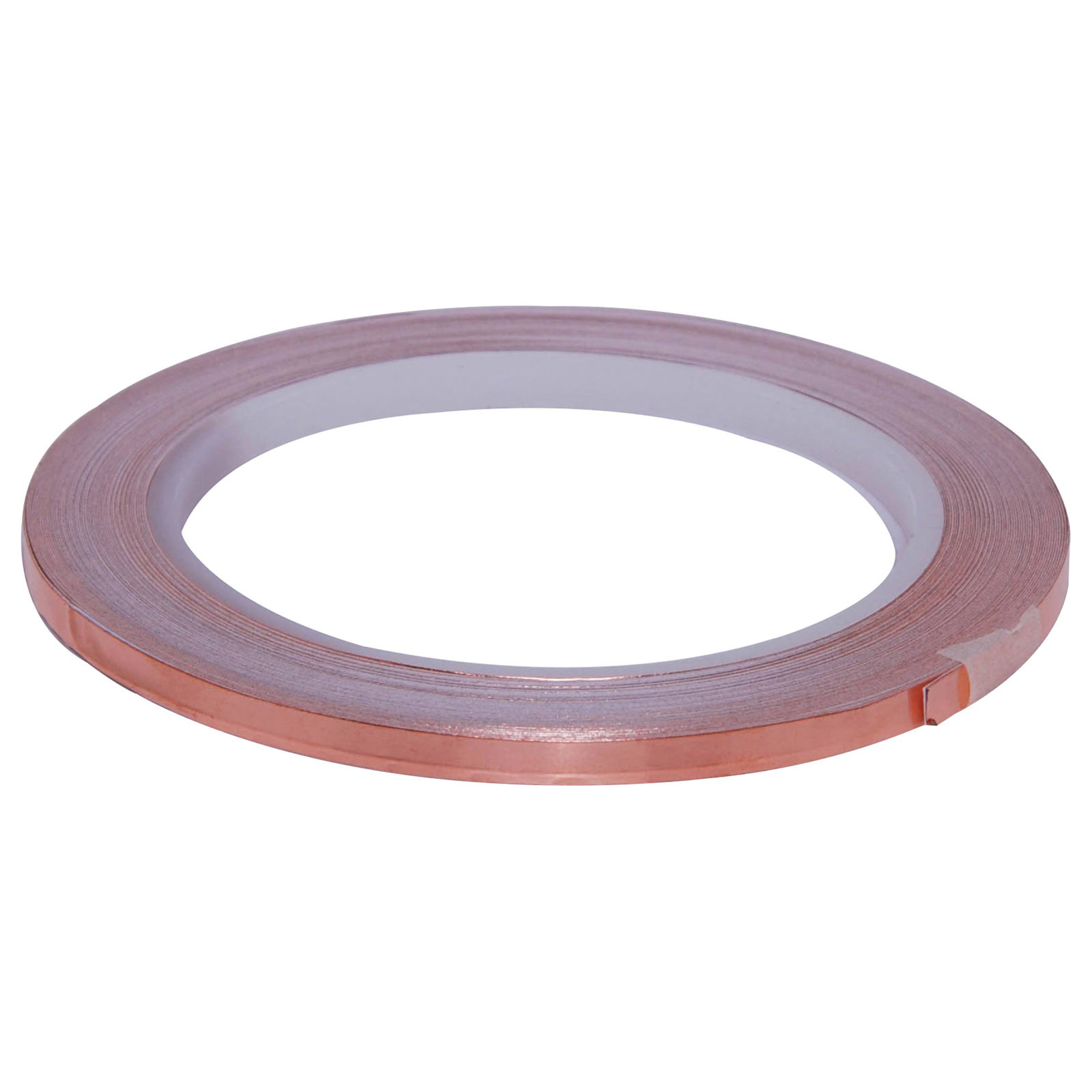

Maybe I’m missing something about a build constraint, but why not just nickel-copper-sandwich your tab connections?
I have copper adhesive foil I can stick over the nickel. I mean, that might help right?
It sounded so stupid I had to try it... And, it kind of worked! Pulls 100 A before glowing red hot.
Hehe, unfortunately my 12 year old DeWalt cordless drill is still chugging along, so I still can't use the interchangeable battery system.
I've made enquiries with Sunstone about finding an Australian business who has recently purchased a pulse arc welder. If there's one locally I might try and get the battery pack welded up using 0.2 mm x 8 mm copper. Otherwise the 0.2 mm x 8 mm nickel will be my only option. And the copper tape is too hard to ensure reliable contact, so I think that's the wrong path.
An update to the copper tape story - I read on another thread here on the 'sphere that you can spot weld a nickel-copper sandwich with a regular resistive welder. As you can see from above the copper tape definitely helped, but it's not exactly consistent.
So this afternoon I decided to try welding the copper side of the bi-metal tab to the cell can... and it actually worked surprisingly well. I only used the 8 ps setting on the Sunkko welder (higher than I would use for nickel, but not huge) and it took some effort to peel it off.
The proof was in the discharge test though, so I repeated the experiment above and managed to pass 60 to 55 amps for a good 7 seconds and virtually negligible heating of the tab! I could hold it with my fingers as it discharged at nearly nearly 15C.
So while a pulse arc welder might to a tidy job, for a one-off project like this I think the copper-nickel tab might work.
For reference the copper is 0.1 mm thick, and the nickel was 0.2 mm thick, and 8 mm wide. The adhesive smokes a bit when you weld it...
So youre saying the layers were copper tape->nickel strip->cell body? Do you have a link for that copper tape w adhesive?
No, nickel, then copper, then cell. According to this the tape is 0.07 mm, but the adhesive was probably the rest.
