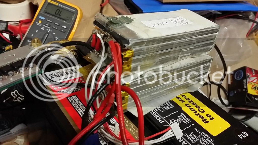

I tried to weld .3 nickel and added two 3s 20c 5000 turnigy packs. I also added the diode.
My recommendation is do not try and weld .3 99% nickel. It is too thick for consistent welds, the welds are very burned. I can usually get only 1 side to weld properly. I don't think it is worth using because of too many inconsistencies. .3 99% nickel is simply too thick.
The way to probably weld .3 nickel is if you can get a really high amount of amps and use higher pressure on the probes.

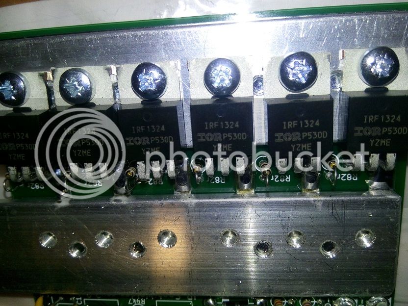

To top it all off, after about 15 test welds, I turned my pulse time to around 15-18ms and when I welded I heard a noise from my JP welder, saw some smoke, some burning smell and now voltage between the probes is constant 12 volts. I obviously blew my fets.
SO even with this diode modification, you can still easily blow your fets with too much battery power.
.2 99% nickel is probably the max I believe for spot welding.
If you want thicker nickel for more amps, then get wider nickel. Like .15x12mm .
These are just my thoughts here and you obviously will have to experiment.
