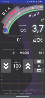

Thank you for your reply stancecoke.
I didn't know that the second number in BlueOsec also was a control state.
But there's a slight problem, (1 | 17) is shown when the wheel (that the DD motor is mounted on) isn't spinning, and (1 : 34) while it's spinning.
No matter if I pedal or not. My speed limit is set to 50 km/h and I doubt that I can spin the wheel over 50 km/h by hand 🤣
Would be great if you helped me out with this one. Is there something I'm missing?
I'll double check the settings you've given me and reply with the result.
Angrubean
Aug 28, 2022
20

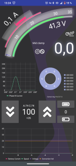

So I have flashed the controller with new parameters.
I've set the speed limit to 100 km/h on every occasion (offroad ,no pas, limit)
I've also checked my wheel circumference and set it to 2230 in the software.
I also counted my magnets and divided them by 2 as in the wiki. Which results in 23 pole pairs/gear ratio.
I powered on the controller with everything hooked up and pushed the throttle, but nothing happened. Everything is as it was before.
(Pictures with pas and with throttle)

Hm, you pictures show a duty cycle of 255, this means full power. So something's really wrong. I'm not familiar with the BluOSEC App. Please flash in diagnostics mode post the output. Does the wheel block, if you operate the throttle? Then you have a wrong phase- and hall wire combination...

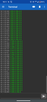

Unfortunately it doesn't seem to be that easy, the wheel spins freely while on full throttle, should I do something while in diagnostics? Like spin the wheel, push the throttle or pas?
Here's a clean output when the controller isn't connected to anything.

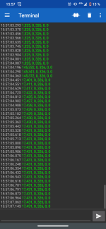

Push the throttle, then second column should change.

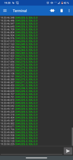

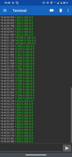

Doesn't even flinch. (Keep in mind, the controller is only connected to the battery, hc-05 and throttle at the time of diagnostics).

But the log is OK. The controller reacts to the throttle as expected. Connect the motor and try again, the 4th column should change with the throttle then also.

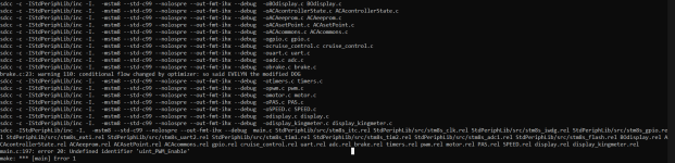

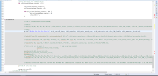

Sorry, again: what is your line 194 now. You don't seem to have edited the line according to my suggestion, otherwise, the momentary throttle would appear in column 6...
You're right!

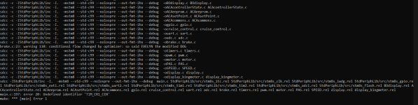

SDCC doesn't seem to find uint_PWN_Enable. And therefore nothing was flashed onto the controller.

uint_PWN_Enable is not exported from the ACAsetPoint.h :-(
Sorry, I think you have to go too deep into the code, to fix that.
You can try to read the register directly:
Code:
 printf("%u,%u, %u, %u, %u, %u\r\n", ui16_control_state, ui16_setpoint, ui16_motor_speed_erps, ui16_BatteryCurrent, TIM1->CR1 & TIM_CR1_CEN, ui16_momentary_throttle);

It seems that "TIM_CR1_CEN" doesn't exist. I suppose you meant "TIM1_CR1_CEN"?

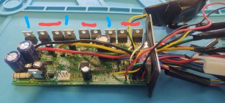

I see, you print out the duty cycle now, too. Everything seems to be OK on software side. So I guess, there is a hardware fault. Do you have a scope for checking the Pwm signals?

Sadly no, I don't have access to an oscilloscope. Do you know any other way of debugging? The PCB looks fine, there's at least no visible damage. May it be an incompatibility of IC's? I've searched through this thread and I couldn't find anyone with a 3PEAK TP104 op amp. The sensor should be compatible because of its frequent appearance, It also matches with the "spec sheet" of the s06s.
You can check the voltage on the gate pins of the MOSFETS. On low side, they should be about 5V, on high side a little higher than half the battery voltage, when the contoller is switched on, but no throttle is operated. (center aligned PWM has 0.5 duty cycle when the current is zero) But be careful with the probes, don't produce magic smoke ;)

No magic smoke on my watch;). But there is a slight problem, the MOSFETs marked with blue(K150E09NE) are the only ones that receive any gate voltage, which also is strange. You said that the low side should have 5v, and the high should be at about half the battery voltage. Now the only reads I got from the blue was 13v that doesn't seem right as my battery supplies 40v.

OK, so it's a nine FET...
The blue ones are the high side FETs?! The 13V should be the output voltage of the LM217. You could check the voltage on the PWM processorpins directly, this should be 2.5v exactly and standstill with no load. (5V @ 0.5 duty cycle)

By following these notes bmsbattery_s06s_controller_hardware/S06S.Txt at master · KingQueenWong/bmsbattery_s06s_controller_hardware
And this pinout
I could read 2.5v on all of the PWM high pins(26, 27 ,28), and 3.5v on all the PWM low pins(20,21,22). With the throttle disconnected.
