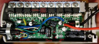

Does this mean that the 6 FET and 9 FET controllers have a close or same phase current limit? And would it then be fine to use an integrated 6 or 9 FET with this firmware? Like the ones attached.
I don't know if the "integrated" boards are the same as the standalone ones. If "integrated" means they are designed for OEMs to use in their bikes, or in bottle batteries, etc., they could have different original FW, or even different hardware designs that won't respond the same to FW not specifically written to handle those differences. There may be info on that in this thread or in the Github repositories or the main OSFW website, etc.
I would guess that the phase current would have to be about the same for 6 and 9 (and 12/15) FET controllers, because the single FET on half of each bridge would be the limiting bottleneck, no matter how many FETs are in the other half.

That's great news! Then I'll order an integrated 9FET and hope for compatible hardware :ROFLMAO: I've long searched for a flexible solution for my ebike and now have seem to found one!
I suppose you've tried it on a 9FET integrated like the one attached?
I bought mine from topbikekit.
I used the 22a battery limit like the original and twice that for phase amps. It was fine and didn't get hot. I don't think the stock plug can take more current than that, but I don't know the limit of the controller.
Thanks! Then I'll buy a 9FET integrated from the same shop and use the same settings for the phase and battery current. Hopefully I won't experience issues like the other 9FETs.
