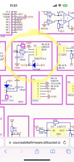

Hi guys,
Wonder if any of you KT controller gurus can help me out !!
I have a 45a KT SVPRK-SLS02G controller.
I'm getting throttle 01 abnormality error. I fix a lot of KT controllers for customers and haven't come across this issue before.
Known working throttle has been tested.
Re flowed 5V throttle, signal and ground where it meets the PCB.
I've changed the CPU chip from again a known food working 45a controller.
I'm getting 4.85v when the throttle is active. All hall sensors good etc.
Both adjust voltage regulators are good.
All fets are good no shorts; charging and dog charging correct values etc.
The throttle works for a bit then just stops and throws the error 01.
Im thinking it's something to do with the throttle circuitary. I've post the schematic about the throttle circuitary. Anything on it I should try changing or testing ?
Thank you in advance.
Nathan
Managed to fix it - it was 1N4148 zener diode on the throttle schematic above. Was reading 1.3oHms when it should be 0.51kOhms. Swapped out for a good zener diode and throttle & controller works as should now.

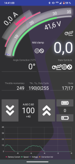

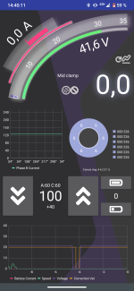

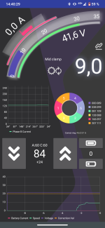

Hi everyone!
I've just flashed the firmware onto my controller and I'm having this strange problem where, I got everything hooked up (PAS, Hall sensors, Phase) but the when I turn the pedals and my PAS sensor starts register movement. The motor just doesn't do anything and spins with the pedals. While connected through the BlueOsec app I see no current flow while pedaling, even if the controller seems to get the signal. The hall sensors are in the correct sequence (4, 6, 2, 3, 1, 5) but the Phase B Current diagram remains as a straight line, is that how it's supposed to be? Also, when I spin the motor fast enough (no matter the assist level) at some point it starts to break and BlueOsec shows negative current (-0.3 A - -1.3 A) and the Phase B Current diagram shows for a second a small wave.
While operating BlueOsec shows following control states
While spinning: (1 | 34)
While still: (1 | 17)
I have the following configuration:
9FET KT36/48SVPRM - Rated current 12A (25+-A Max current)
STM8S105C6T6
ACS711 as current sensor
3PEAK TP104 as operational amplifier (may not be compatible?)
Does anybody have any clue to what's going on?
So is the motor working on the throttle?
I'm living in a country where e-bikes with throttle isn't legal, and so I don't use any. Instead I have a pas sensor installed. But no, I've tried to turn the sensor individually and with no luck. The motor remains still but BlueOsec does seem to register pas activity.
Edit:
I got my hands on a throttle and after plugging it in and testing it with my setup nothing changed. BlueOsec does see throttle activity but there's no movement on the motor.
Tried both with throttle and pas.
