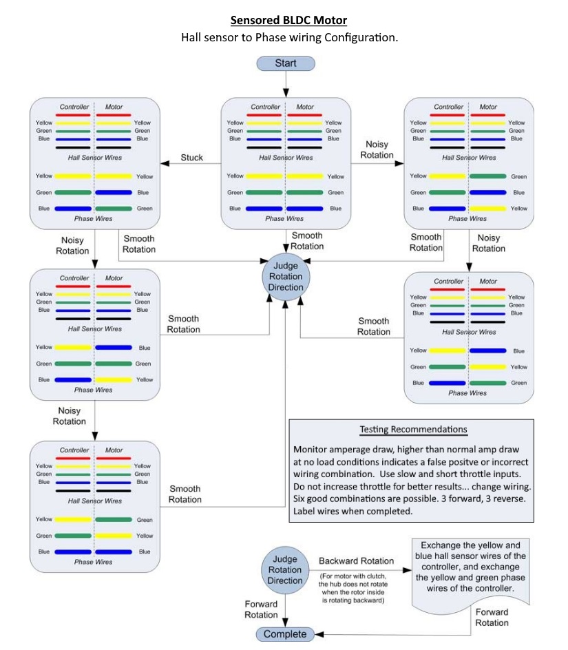

Okay, so i went trying to ride the thing (just in circles on my yard, with a really haphazard wiring setup, lol) on sunday night,
and like regardless of the motor angle or whether interpolation was enabled the torque was really ... grumbly?noisy? at low speeds.
This made me realize that I never like 100% verified verified that i got the correct wiring order for the motor phase wires
(it did seem to spin okay with the kunteng fw, but i didnt try for long, and it was only freewheeling).
Which made me realize that the firmware has no settings for swapping them around. Excuse me? How barbarian are we? Making people re-plug actual physical cables around up to 6 times (or even more if they messed up something else...), when you could instead just press a couple of buttons in diagnostics mode to try them all out, in the space of under a minute (same for hall wire order, it would be even simpler to re-map those in software, but AFAIK i got that one down, so ... project for after i get my bike running).

I use a 6 fet "hailong" style Kunteng controller.
May it be that my motor isn't compatible with the firmware? Could it be that the phase or hall wires are different from the original Kunteng firmware?
I'm ready to supply any information that is needed to solve this.
How would the motor be incompatible?
I don't understand this question. The wires themselves are not part of the firmware (which is just software, not hardware or wires).
If instead you mean the *order* of the wires, you just change those physically between the motor and controller to find the correct phase/hall combination (combo); there are quite a few threads and posts about how to do that with any non-self-learning controller.
If you mean something else, you'll need to clarify with exact statements and descriptions.
Yeah, that's it. May it be that the firmware has a different layout from the original?
Is there a diagram or text resource I can use to compare and verify pins?
I'm sorry to ignore the problem Voron has (this is the problem with these megathreads), but an update on my issue:
Okay so, I didn't have the hall wire order right 😅 - i realized this after having written a little hack to remap phase wires in software on the fly (with uart keypresses), and accidentally spun the wheel in reverse (and it sounded fine-ish)... then i took an another detailed look at the hall sensor states and was like "uhh, that's reverse."
So, effectively i was trying to run the wheel in reverse from what the software was expecting (and no surprise that interpolation doesnt work in that situation).
A little bit of experimenting (and applying a fixed software remap to the hall sensor order - i'm not resoldering the wires going to the connector lol) later and I just did a nice test run (it runs silent and has torque). There's still plenty to do but atleast I have a way better starting point 💚
So I've just in case probed the phases and hall sensors of my hub motor but found no abnormalities. Now I've confirmed that there's nothing wrong on the motor side and this is a controller issue.
I've also tested the mosfets on my controller and found no issues.
I'll try to switch phase wires as in this post and see if anything changes.
Edit:
As expected it didn't make a difference. Could it be that the new controllers have a different layout?
Is there anything else I can try? I doubt that there could be any electrical error on the circuit board as I did everything following the wiki and met no problems along the way.
Edit 2:
I've used this resource to verify my pins and traces, pwm high and low, hall sensors and all of the remaining pins line up with their "documented" destination.
I'm lost, does anyone have an idea of how I should continue debugging? Any specific parts of the circuit I should inspect? Or any values I should provide?
Edit 3:
So I don't know what happened, I used a Windows 7 virtual machine with usb passthrough, installed sdcc 4.1.0, java 8 and stvd, compiled the firmware and flashed it through the vm.
Somehow this worked and my motor is now turning!
