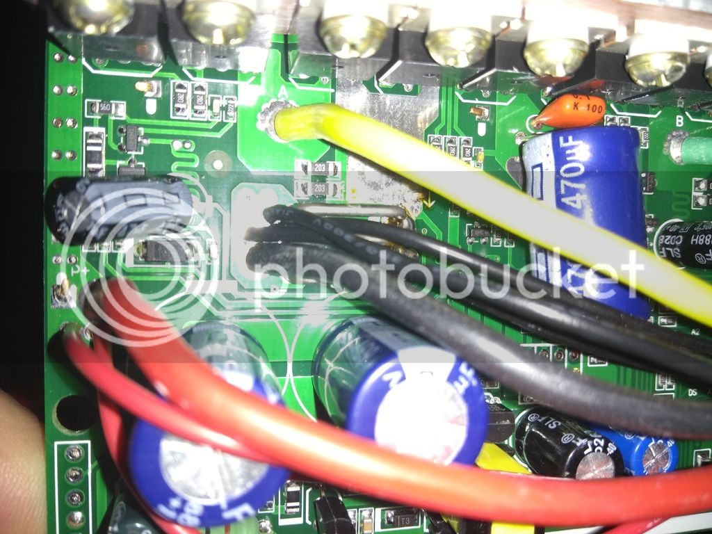

Hello, Sorry it's taken so long I've had a busy few weeks, but here are the photos of the controller circuit board.
Here is a bad picture of the shunts sorry the wires are very tight.
I've got a few more if they're needed.
Yep, those are you shunts. However I don't remember anyone around here with the knowledge to read amp ratings from looking at the shunts. Modifying a shunt is not hard. a blob of solder will do it. However it is pretty-permanent once done so make sure you are 100% sure your controller doesn't have a setting to go to 40a.
Check out how John in CR did one. https://endless-sphere.com/forums/viewtopic.php?t=31643
If you still need help trying to discern your controller, show us the connectors, and the pads (the places where the little wires are soldered to the board, and the ones that are also empty) Maybe someone around here will recognize what you need to do to get 40a from your controller before you do any mods.
