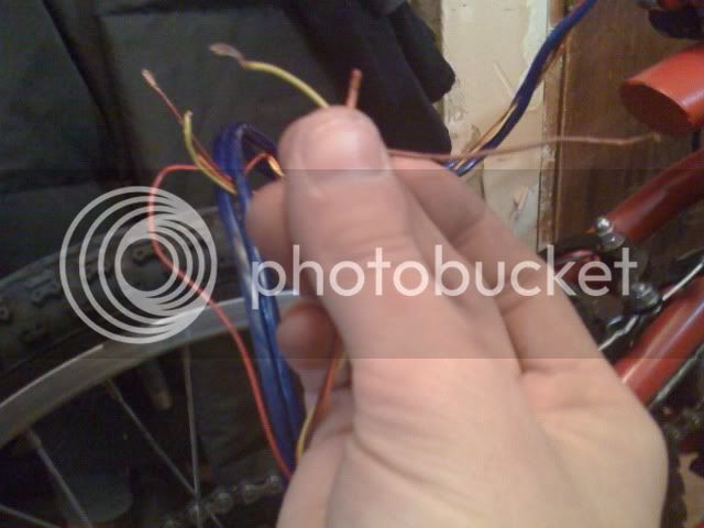

my tether gets caught in my rear tire and brakes and gets severed like string
what my odometer reads before something went wrong...i guess thats why im running it through its paces...lol
on a good note, i think this is my top speed i clocked before i broke it...lol
i am definitely pleased with my bike so far except for this incident that just happened.

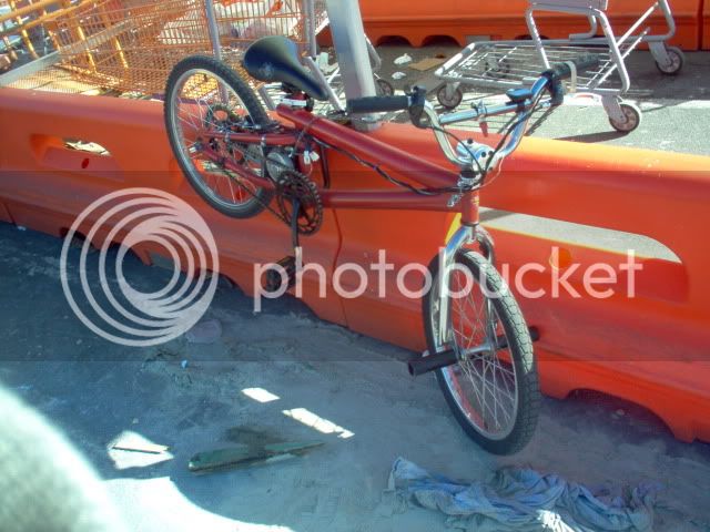

so today i finally took it for its maiden voyage(well the first ride that i ever took that wasnt a test run). i can honestly say that it is in working order. nothing fell apart, broke, went up in flames, or something bad happen to it, yet *knock on wood*. the combination of my 3-speed hub for the pedals, and the direct drive of the motor really goes together smoothly. i gotta say, it is pretty fun riding this thing around, the only thing is that it was cold(about 37F). heres a pic that i took for fun. i went to home depot to ironically buy chain and a lock for my bike...lol.
its locked, but with a crappy lock that you could probably cut with a pair of wire cutters...lol. i was sweating the whole time i was in the store.
also heres a vid of me riding it home. close to the end of the video, the batteries started dying. darn SLA's...lol
[youtube]ijhGQZkxZPE[/youtube]
