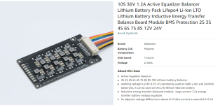

Problems with an active balancer:
#1 hides problems (until severe failure)
#2 makes problem worse (equalizes weak bank at "empty" causing weak bank to hit possibly dangerous high voltage with normal charge, at minimum, rapid further deterioration} & (weak bank discharges faster and deeper for more heat and more rapid deterioration)
#3 drains all good cells to feed weak bank
#4 Hides self discharging cell(s) by cannibalizing healthy banks until self-discharging cell fully shorts
#5 not needed for good battery! Does nothing!

I read what DA. said about active balancers and almost every thing on that list also applies to a BMS. Unless it is a Bluetooth BMS.
The fact my newer 10S Laudation and hoverboard packs that failed miserably proves that BMSs can also be garbage as well. frocking useless !!!!
The best thing for a large pack is the Bluetooth BMS - AND an active balancer which is UNHOOKED 99% of the time and only used when necessary. Then all those negative aspects of the active balancer do not apply.

Yea. I am not happy with that. I do not see a Bluetooth.
I really did not want a BMS as would need two as the 10S packs will be physically separated.
What I really wanted does not exist as far as I know and that is a 10S meter / balancer like the 5 in 1 - 7S and the two 6S external balancers I own.
It looks like I have no choice but to use a piece of wood with nuts and bolts if I can not find a 10S meter or Bluetooth BMS. I do not want to pay for two - 80 amp Bluetooth BMSs. It is NOT happening.
If anyone knows of a 10S meter and 10S balance plug male and female connecters with wires. Pleeeease let me know.
Thanks.
LC. out.
latecurtis said:
file.php
I use something similar to that on a 13S pack, and it's been effective for a few years.
Thanks for posting.
Good to hear from you.
Yea.
Do you have it hooked up all the time for run and charge or just when your packs need balancing ????????? I planned on using the active balancers at home like external balancers and not while I am running the packs.
DA said that active balancers can do more harm than good but that could be for old 18650 packs. Not brand new LTOs.
I just like the blue tooth app. I think it would be really cool to have that phone app. onboard like my GPS app. when it works and GPS speedometer.
I just wish they made a 10S cell meter. Even if it don't balance I could check my cells without having to hook up a piece of wood with nuts and bolts to a 10S male balance plug.
I guess if I get that tool bag I will not need to cover the terminals and just use a multi meter to check the cells. A meter or Blue tooth device would be much better though.
A simple blue tooth transmitter glued to the end of the wood box wired to the cells and a digital dashboard display would be awesome. I am not spending hundreds on two BMSs that will go in series. That much I know.
If such a Bluetooth device exists that is under $50 which is NOT a BMS or balancer , or a 10S meter , please post a link.
Thanks.
LC. out.
latecurtis said:
Do you have it hooked up all the time for run and charge or just when your packs need balancing?
I leave it hooked up permanently.
Why can't you just hook up two of those 5 in 1 7S units to grab your 10S?
Heck I remember playing with them toys ---> rc charger and lipo and cutting a balance connector from a 8S down to 5S.
Just because it says it has a BMS does not mean shit.
BMS - (B)attery (M)urdering (S)ystem

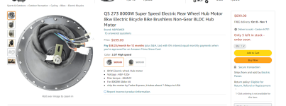

I remember the main reason for buying that 1.800W brushless motor was it is 3,000 rpm @ 48V.
so.
3,000 rpm / 48V = 62.5rpm * 54V = 3,375 rpm.
1,800W / 48V = 37.5W * 54V = 2,025W.
Thanks.
LC. out.
