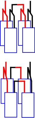

Are you certain that plug is fried?
About 8 pounds. The BMX 20 inch forks are short and stout. Double the brackets I used for the MY1020 motor
Should accelerate like a rocket. Sorry totally broke. Trying to forget about no plugs and possible fried controller. Doug checked the wheel hook up. perfect. I can install motors. Just cant hook up wiring
If you are certain that plug is fried ... then you must have reversed plugs somehow.
Red + battery plugs into + controller input, might be labeled Bat+.
However ... if you are certain that + was properly plugged into + ... be aware that this connection will produce a healthy spark-snap when connected!
Might just be a small spark mark rather than "fried"?
Use multimeter to confirm positive connection and total pack voltage.
Install fuse! ~30A slow blow. 40A+ if 40A controller etc
Rig ordinary light bulb between Battery + and controller as final connection.
If briefly lit then very dim or off, then might be proper connection. (Should be able to run very-very low throttle tests - 100w light bulb 120V/50V = possibly 40W of possibly 2000w full throttle, just a slight whisper of a throttle turn or regulated current will "fault" controller)
Some switches use a similar pre-resister to lessen the initial surge-spark.
If you do get positive results you can try quickly disconnecting light bulb and connect properly, should be retained current in controller reducing initial spark.
But install in-line fuse 1st!!!

Use your multimeter to check and confirm your voltage and polarity! (Positive and Negative)
"Reverse Polarity" message from your charger told you you had the battery hooked up backwards.
Apparently you then hooked it to your controller backwards.
Use your multimeter to check and confirm your voltage and polarity!!!
And add a fuse so you don't destroy everything!
Didn't look close enough but got the impression Dan's discharge harness was wired parallel first then serial. In that case you'd need 4 cables like the one linked below to duplicate it. You'd also need 4mm bullets to convert the banana plugs and a series adapter. Some work will still be needed to finish the harness. You can't buy a ready-made harness like Dan's from eBay or hobbyking. Has to be a custom-made harness like Dan's or one from icecube57. And either of theirs would cost more than the $25 you want to spend. Wiring diagram is the first one drawn below.
The other cheaper way is to wire the lipos in series first and then parallel. In that case you'd need 2 cables like the link below, bullet connectors, and a series adapter. Wiring diagram is the second one drawn below. This way takes more work (disconnections) to charge on 6s chargers than first way.
This is just for connecting the lipos to the controller. Doesn't consider charging, balancing, or ease of use.
Big spark, scorch, and melted plastic when you connected battery to controller is not a good sign.

I always wire my lipos in parallel first so that The individual cells are put in parallel. I use Deans plugs because you can buy the leads ready made from Ebay. You can also get the parallel leads for balance wires there. Here's a schematic of how I do it:
http://s451.photobucket.com/user/d8veh/media/batteries/lipowiring_zps83600915.jpg.html?sort=3&o=16
d8veh
Your diagram is exactly how I wired those two harnesses up I pulled apart all the tape on the one which had the burnt plug and the red wire went to red and the black to black. I was not that drunk when I made them up. I only had a few beers. The other harness I can check with the multi meter. If it does not read negative 44.4 volts than I did not reverse polarity. It could have been something with the parallel board. I hooked the batteries to the board 2 packs in parallel to each side. The wires coming from the board were white for positive and black for negative. Could it have been the fact that the controller was turned on when I hooked it up and the packs had been sitting for awhile and there was a difference in voltage between the 4 packs that caused the big spark. I just don't see how I could have hooked anything up backwards. I will go and get all my stuff from Doug's house today. I am not waiting forever for him to fix it. It was not the deal I was looking for when I gave him back the tablet. He wants to install the brake levers because they are longer and have better leverage for the brakes. He also wants to hook up the sensors. I don't care about all of that. I just want the thing to work.
