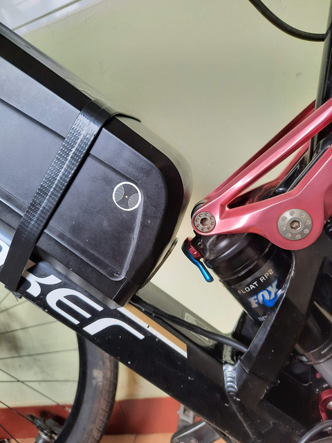

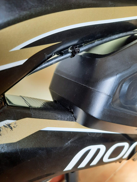

Finished today my new build, it´s a Mondraker Foxy R 2010, size L
Battery is super tight to fit inside the frame, have to remove the base and cut a litle bit in the front of the battery and sealed it with black silicone.
Made a L shaped bracket fixed to one of the water bottle holes, and fixed the battery with stainless steel hose clamps wrapped with black duck tape.
It sits super tight, doesn´t move 1 mm, i´m pretty happy with the result, unfortunately it isn´t easily removable.
The bulge at the front of the top tube looks like it was made for the battery. It looks nice and organic. I think you were lucky to get it in there at all. I suppose you just charge it on the bike?
Yes, I charge the battery on the bike, too much work to unscrew the clamps everytime it needs juice.
