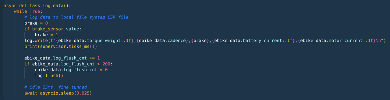

Python is a fast developing learning and easy to learn. I am seeing Arduino shifting from C++ to Python.
For me, it is very important fast development!! Other all this advantages of Python (nice even for new developers, as anyone can develop Pyhton code), CircuitPython also let us develop/program/debug the code wireless with out phones -- because of this I am being testing the EBike application while riding and using my phone on my pocket, no need anymore to have a computer and connect a specific cable to development and debug, this is way faster!!
This is how I edit the code on my phone, wirelessly while the Ebike board is installed inside the EBike motor:
And here is the prints data on the terminal:
And I am also writing the debug data on a CSV file inside the board, so on the same file system the Pyhton code is being run, it can also write and read files!! this is magic, it seems almost a Linux system. Although, all this magic needs much more processing power / energy and yes, doing all this is kind of slow but works ok for my application:
Ok, can see the benefit from the point of view of not needing to build/flash etc. makes life a lot simpler - and I know it's something that's useful to learn, i'm just not sure I have enough time to start from scratch with python.

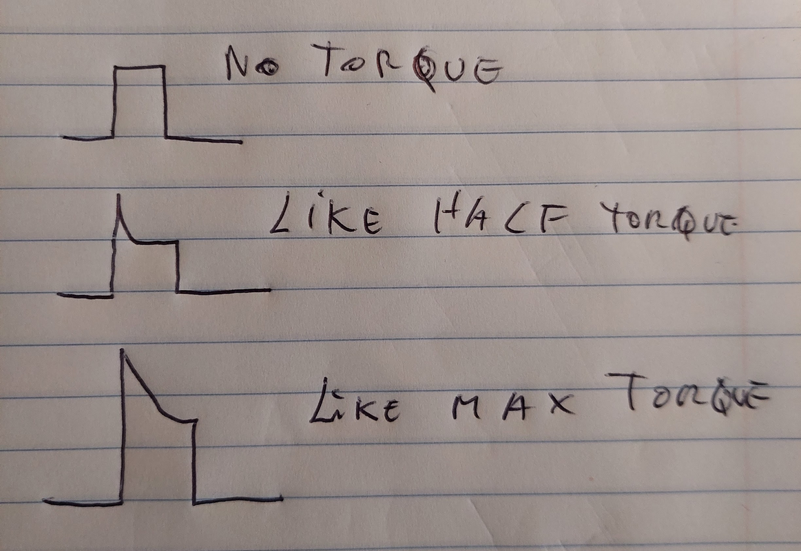

Can anyone help with how the torque sensor works from an electrical point of view and how i might interface it to the nrf? Reading the value with an adc pin is no problem - it's the 'exciting' part that I'm not sure if I need additional circuitry for...
"The torque sensor signal is measured on ADC channel 3. There is a specific circuit to excite the primary coil of the torque sensor and it needs a pulse signal that is generated on PD3 and has a period of 20us and a 2us Ton:" - taken from https://opensourceebikefirmware.bit...TSDZ2_mid_drive_motors--Motor_controller.html
It's the 'specific circuit' part that makes me think I can't just use a 5v pulse from the nrf to excite the torque sensor. If it's not a logic level device I presume I need to switch a mosfet/transistor to provide a bit more current to excite the torque sensor circuit?
I found this - but doesn't help unfortunately https://endless-sphere.com/forums/viewtopic.php?f=28&t=79788&start=9300#p1713302
beemac said:
beemac said:
Hoping I have enough pins on the nrf for everything - buttons, pas, torque sensor, speed sensor etc. think I'd better work that out before I start soldering!
I wrote that text about the 2us pulse (50kHz 10% duty-cycle), etc. I did that by observation with oscilloscope and then I just replicated on our OpenSource firmware, and then it just worked at the first try.
I would say there is some "power" circuit to be able to drive the coil, starting from that input pulse of 50kHz 10% duty-cycle. I would look at the TSDZ2 motor controller to try figure out what can be the circuit, but probably just some mosfet to switch on/off that signal. And the reading back circuit, I have no idea, but as this motor controllers are kind of cheap, anyone can try to use a new one just to figure out the circuit.

Thanks - i just also found this https://github.com/elem01/V-0.19/blob/master/How-TSDZ2-torque-sensor-works.md
" In effect the sensor is an electrical load that varies with torque"
This is the key I think - but my limited knowledge of analogue electronics means I'm still not sure how to interface it - I'll do a bit more research - I'm also getting a donated controller to de-pot soon so I'll have a look at what's under the epoxy!
edit: Ok, can see how this might work - I need to use a mosfet to switch a pulse to excite the coil - then measure the current the coil draws with a shunt... I wouldn't need the cascaded mosfet arrangement we used for battery voltage since I'm only switching 5v - so a single high-side mosfet and a shunt hopefully... Please anyone with more than my rudimentary electronic knowledge chip in and give me some guidance :)
edit: do I measure the current on the ground side? I assume that's best then one side of the shunt is 0v - otherwise if I have the shunt on the positive side the each side of the shunt is higher than ground which is problematic to read without additional circuitry. I've always wondered why we measure current on the ground side - is this the main reason why or am I barking :)
edit: so something like this??
Or is a mosfet overkill - so something like this with a shunt in the negative side of the load?
Really need a controller to gut and properly test the voltages and such - but can see that it does look like the circuit is broadly as I thought, but maybe with some additional bits for filtering or suchlike - see image below - shows the back of the board with the torque sensor wires - and what looks to be a shunt resistor (R44 - ringed in green) on the negative side - and a mosfet (Q4 - ringed in blue) with its drain connected to the red wire of the torque sensor.
The images are a bit shaky - but I think the resistor marking is '2001' which is 2K ohms. Hmmm that can't be the shunt resistor - seems far too high a value....
Since I remember, when I applied torque on the pedals, the square signal then got a peak like I did draw here - I hope you understand. So, the circuit to read the torque signal, needs to look at this:
I would say it needs a subtract circuit, to subtract the original no torque square signal. Then after, use an integrator (??) / low pass filter (??)...
