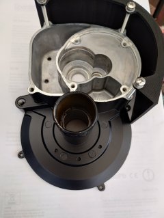

I have just checked a spare TSDZ2 body I have and it is a 3 screw as is the "new" spare TSDZ2 mid-drive I have boxed up, can you easily check the size of the thro' hole to see if it is 88mm or 81mm to to see if it is a 2 or 2B mid-drive.
