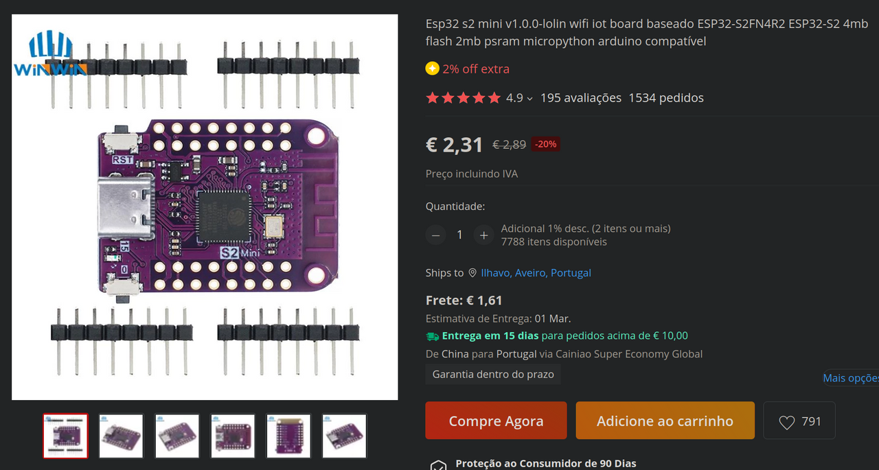

I will try switch to this ESP32 board, which is small and cheap, with the advantage to have Wifi for the wireless programming. Maybe we could work together on the EBike application. I plan to use the same application for my Xiaomi EScooter, the only difference is that I will use a throttle only and the motor also brakes, so I will need to apply a negative motor current.

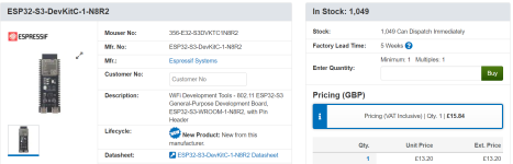

Why the potential move to an ESP-S2 rather than your current S3? Doesn't that lose you BLE? I thought you were keen on ANT+ etc.
the dual pin rows are a bit of a pain for soldering as well. Is the below board the current S3 board you use? I like the form factor better - can socket it too to make easy replacements if I blow it up!

Oh, really I didn't saw that of missing BLE on S2. I think BLE is important so we can connect to the "Smart BMS Bluetooth".
I wish to try ESP-S2 just because the board is smaller than S3 but since it misses the Bluetooth, I think I will keep using the ESP-S3 board.
For ANT+, I plan to keep using NRF52840, like an external module. There are ANT+ modules but the better is to use the NRF52840 to have much higher flexibility.
I use this ESP32-S3 board:
And to be clear, I just like ESP32 because it run Pyhton and can be programmed wireless, otherwise I would probably keep using the NRF52840.
