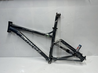

I can only go on what I have seen with these small trailers, I would try anything for a few pence if it stopped the corrosion, perhaps waterproof grease or something on the threads as I am more a dry weather rider and do not jet wash the bike down I have had no problems with galvanic corrosion. I only seem to get a bit of surface corrosion on the die cast casings due to the paint being knocked off on the underside, so just clear the area with fine wet and dry, paint it and then cover with gaffer tape. then fit a "sump" guard I 3D printed. But they do have a better version on Aliexpress. https://www.aliexpress.com/item/1005010425222638.html Do have a couple but not fitted as of yet. They stop the crap only, might try one on the hard tail I am putting together, but that may still change to use a 26" Specialized Epic Comp Frame I have, have to check if the battery will fit in the triangle of the Epic though.
