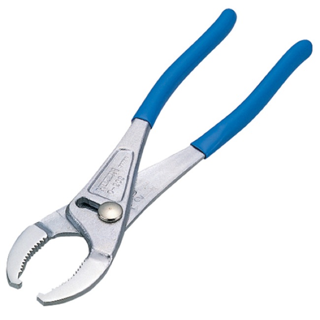

tomjasz said:
What a shame, not using typical Shimano sizing like Bafang.
Lockring pliers care not what size!
That's what I used to install the inside lockring on my BBS02.
EEK! Seriously? No bike tools at home? After many years, 50+, of working on VW air cooled, Modern Vespa, and now 5 bikes I remember swearing off pliers at least 49 1/2 years ago. Maybe it's my not so strong hands but I found pliers are a sure way to mess-up parts. Especially questionable steel. A nice Hozan lock ring wrench does a fine job for the inner ring.
The Shimano BB socket is perfect for the BBSxx Outer.
The Hozan lockring pliers are at the bike shop. They're the best we've got for most kinds of lockrings. Least likely to slip or get damaged. You can tighten down more with them than with a spanner.
It's the teeth at the ends that fit into the lockring slots. I don't know why they have serrations. Opening stubborn beers maybe?
