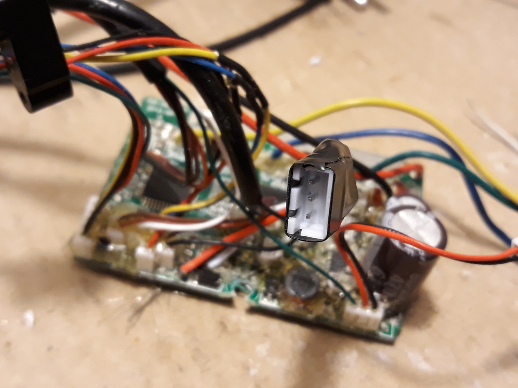

pawepie said:I wired up to the controller using and STLinkV2 clone, and with pinouts according casainho's development guide:https://opensourceebikefirmware.bitbucket.io/development_tsdz2/Development_tools.html
(I think if I get a speedsensor cable (from PSWpower), I could splice it without having to remove the controller)
I got the rest of the information from this german site: (instruction on how to change the voltage...still have to figure out which are the amperage values)
https://www.pedelecforum.de/forum/index.php?threads/software-f%C3%BCr-tsdz2-sfm-du-250-350-mittelmotor-umbausatz.50939/

Thank you very much for your response. I will have to study all that and see if I am up to making my own custom usb to motor wire. I would like to be able to use full power 52v batteries, and also be able to use a couple of 6s batteries wired together in a series. I am not sure what battery we will be getting after we move to Europe but I would like to carry 2 6s 4ah batteries with me so we have at least some power until a larger batter can be purchased.
