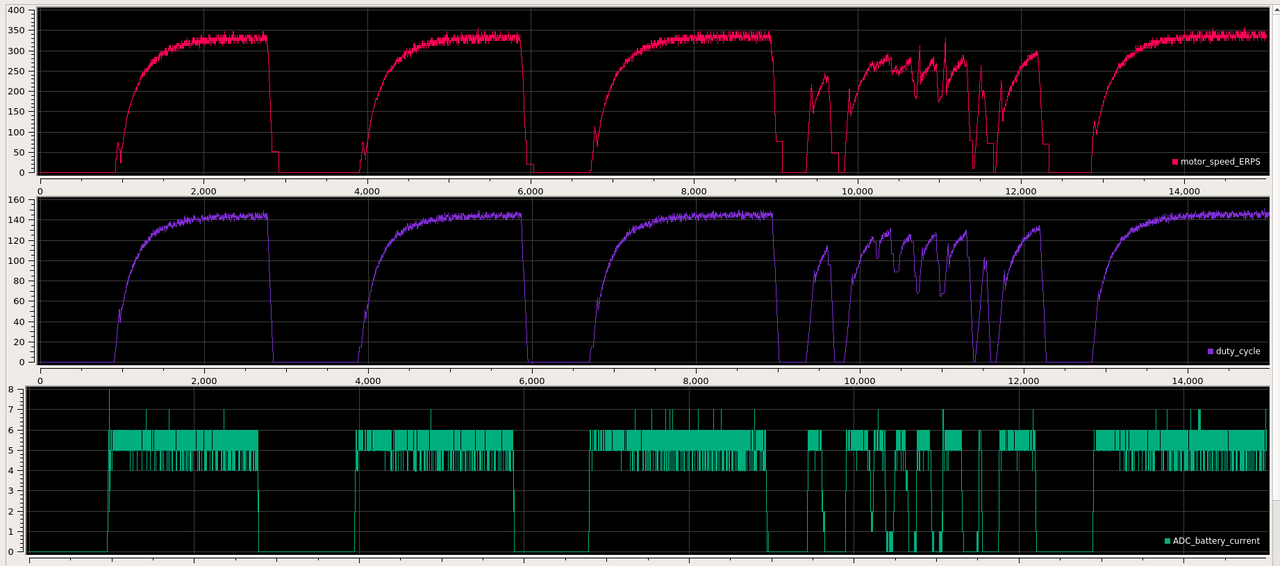

Another test, to see the current controller working. Current was limited at about 3 amps and that a value of ADC = 6, as seen on green line. I hit the throttle fast and put it at max value, as we can see, the current jumps almost immediately to the limited value and keeps there, so this means the torque is constant and well controlled. And the speed, as we can see on red line, increases with an increasing curve because the wheel was loaded...
The purple line is the motor phase voltage the firmware apply, in a way to keep the current at the max limit.
I think the firmware for the motor controller is working very well. If anyone want to try (using a throttle only for now) but must use a fuse and a battery with a BMS.

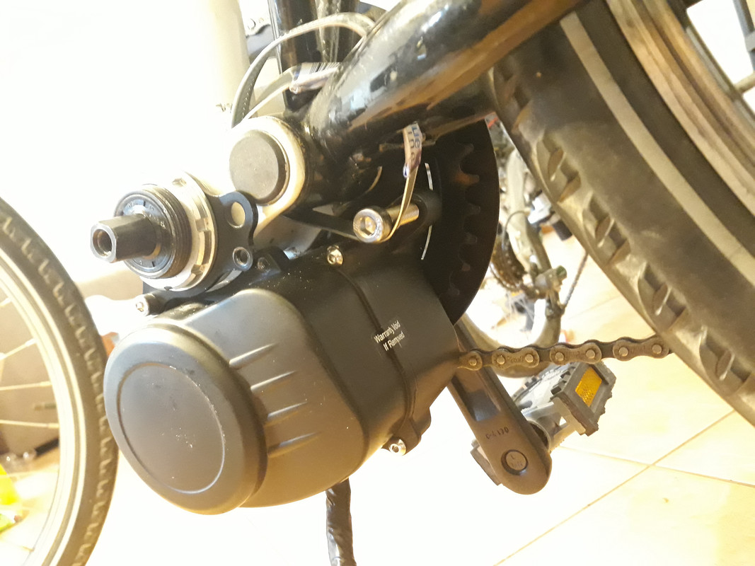

I checked some images on the web.
fetch
index.php
Seems like gear ratio is:
outside 92/10
Inner wheel: 36/8
So all in all
92/10
36/8
9.2 * 4.5 = 41,4 / 1 ration
so 4000rpm / 41.4 = 96rpm cadence
so with the 48v motor i will reach 4000rpm/96rpm with full 13s battery and 2800rpm/68rpm (70%) with empty battery?
and with 36v motor i will reach 4000rpm/96rpm with full 13s battery and the same with empty battery?
is that correct?
