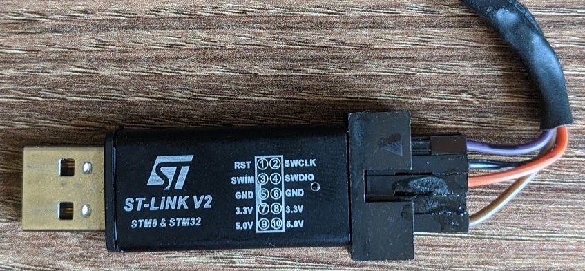

I’m starting to make cables for J-link while waiting it to come. I’m little confused.
I think Segger j-link has 20 pins. In diagram picture from doc folder is only six visible. Which pins I should connect wires. Pinnout is from Segger web page.
J-Link Interface Description
Segger_pins.jpgDiagram-TS 32-bit Mid Drive Motor Controller Programming Cable (EN).jpg
View attachment 366097View attachment 366098
Some Jlink devices are delivered with an external board (pcb) that contains several connectors. When you have such a board, the XH-6Y connector can directly fit in one of the board connector.
If you buy a Jlink device without this external board, and probably just flat cable, you have to connect directly to the Jlink device or to the provide flat cable.
Personally I had a jLink device without the board and I used an extension cable foreseen for the speed sensor.
I cut the extension cable and I connected to pin headers (on a small pcb). I then connected the pin headers to the link flat cable.
Here the function of the different wires in the extension cord I had:
Take care that I am not sure that the color are the same as your cable.
- orange = grnd (to be connected to Jlink - there are many Grnd pin in the Jlink connector; use one of them)
- brun = Vcc = VTref of Jlink (see note here below)
- yellow = speed sensor (so not connected to Jlink)
- green = light (so not connected to jlink)
- Red = SWDIO (to be connected to JLink pin 7 - TMS)
- black = SWCLK (to be connected to jlink pin 9 - TCK)
Note: it is possible to find on the web a picture of the 6 pins female connector giving the functions of each pin. This allows to check if the color are the same or not. Here a link to such a picture. It is about TSDZ2 and STlink but that does not make a difference to know the functions of each pin.
Note about VTref.
If you make you own cable, it is good to keep the possibility to be able to connect/disconnect this wire to/from Jlink.
When you have a Jlink chinese clone, Jlink provides by default 3.3V on this pin.
When you flash the controller, it is better not to power the controller by the main battery. So having the wire connected to Jlink, Jlink can deliver the power supply to the controller to flash it without any risk to drive high current from the battery.
With my firmware, there is also an option to let the motor runs while it is connected to jlink. This can be usefull to monitor some data and perform some fine tuning (without flashing). In this case, the motor is powered by the main battery and it is (probably) better to avoid powering it also by the Jlink device. That is the reason why I then disconnect the wire from VRef.
Addittional note: I think that the original Segger Jlink devices (not the clone)does not provide by default a voltage on VTref.
Those using the original Jlink have then 2 options:
- Send a command to Jlink to force it to provide a volatge on VTRef (see official doc)
- Power the controller from the main battery when flashing. I expect it should be OK even if it seems me a little less secure.
Thank you very detailed answer. I think I will have same Segger clone than you. I ordered it from aliexpress what you linked. I watched pictures from there and noticed it has 20 pins and then search from internet and found Segger site and took pictures from there.
I have speed sensor cable what I cutted and found there is wires with same colors that in DOC folder picture. You have different colors.
I hope Segger clone arrives next week and I cant test your software with TSDZ8.
