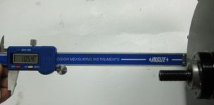

In the original NC hub design, there is a silly amount of wasted space due to the depth of each side cover. The rotor is only 35mm wide, yet the outer width of the two side plates is a full 68mm. In the front disk model, the right side cover is the same as we're used to, but the left one is substantially flat, leading to an overall width of 61mm:
This, combined with the fact that the hub is not centered but is offset about 2mm to the right, means that there is an extra 9mm between the left side cover and the fork that didn't used to be there.

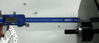

As for the alignment of the disk rotor, on most of the standard front bicycle hubs that I measure there is 10.5mm from the axle shoulder to the surface on which the disk bolts, and that matches the spacing on this motor too:
That leaves just 14.5mm of space for the caliper between the disk rotor and the flat side cover. Lots of standard bike calipers, especially the hydraulic ones, need more like 16-17mm of clearance here, so people will need to watch out about this detail and possibly downgrade their calipers to a narrow one that fits.
